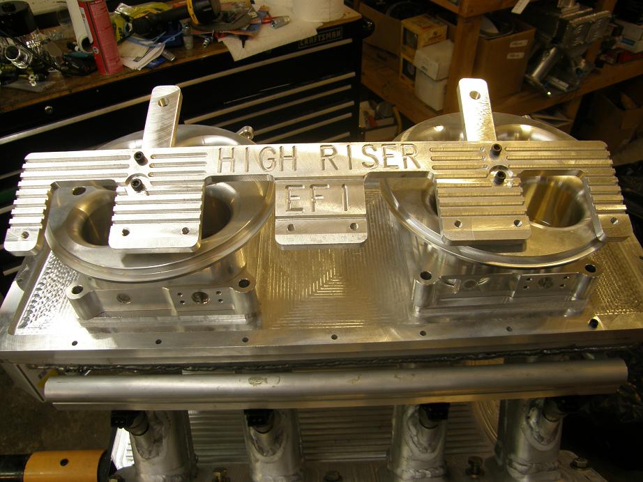

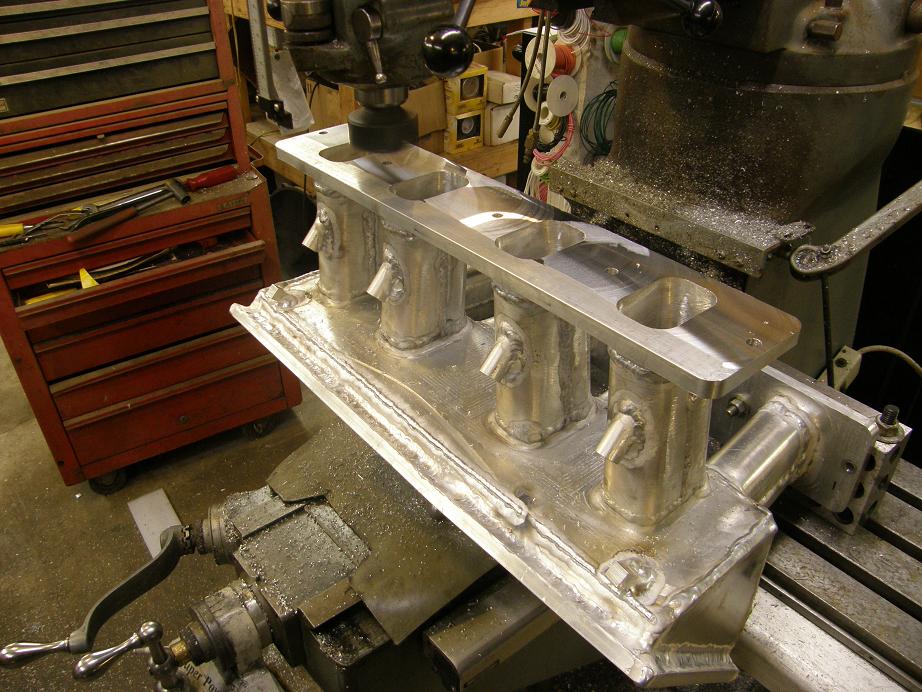

Been making more progress lately on the high riser engine, and I've almost got everything mocked up for final assembly.  A couple weekends ago I got the upper intake on the mill and machined the flanges so that they were flat and square.  I did end up having to take about .050" off each one to get them to fit properly, but when I finished the ports in the upper manifold line up perfectly with the ports in the port plates.  Here's a shot of the intake on the Bridgeport:

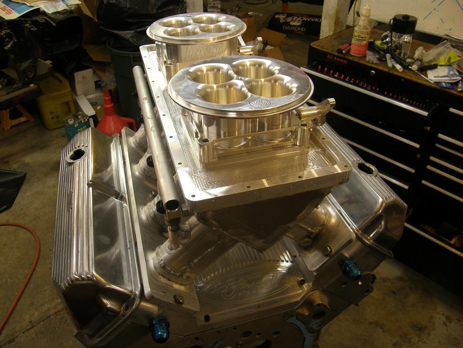

After milling the flanges I milled the top flange flat where the cover plate bolts on.  Part of this operation was to mill a groove in the top for an O-ring for sealing the top plate to the flange.  After I got this groove cut I took some 1/8" O-ring cord and cut it to the correct length, then butt glued the ends together; I think this is going to work out real well for sealing the flange.  Finally I drilled the holes in the flange for bolting the cover plate in place, about every 2 1/2".
I transferred the pattern for the bolt holes to a plate of 1/2" aluminum and then made up the cover plate on the CNC machine.  On the bottom side of the cover plate, where the throttle bodies mounted, I used a 3/8" corner rounding end mill to radius the holes where the throttle bores come through the plate.  For the most part this finished up the intake; here's a photo of the manifold bolted on with the cover plate and throttle bodies set in place:

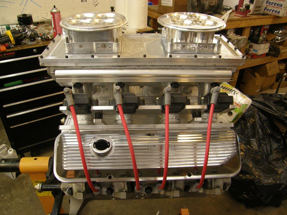

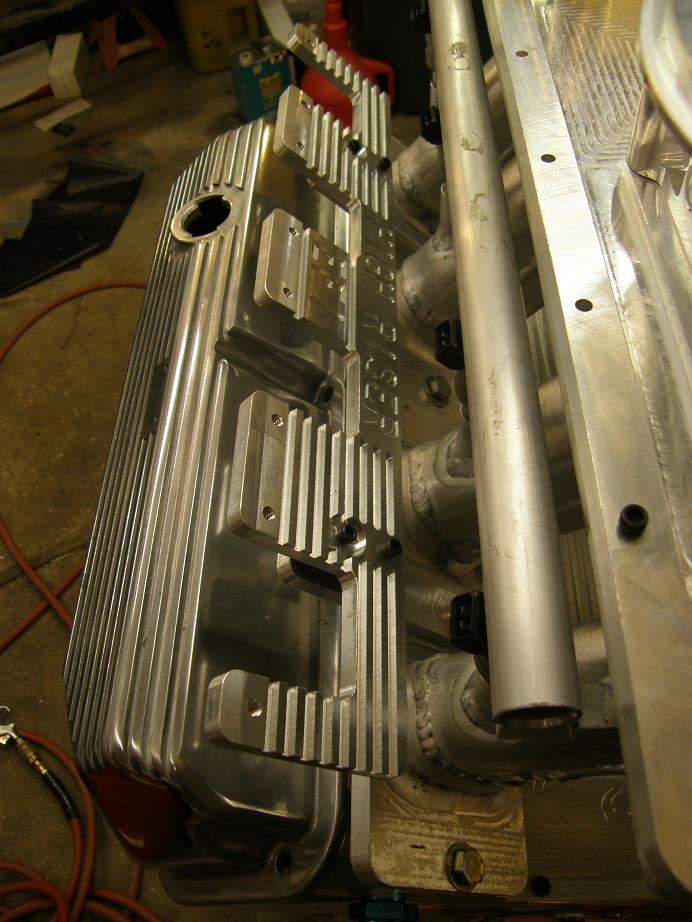

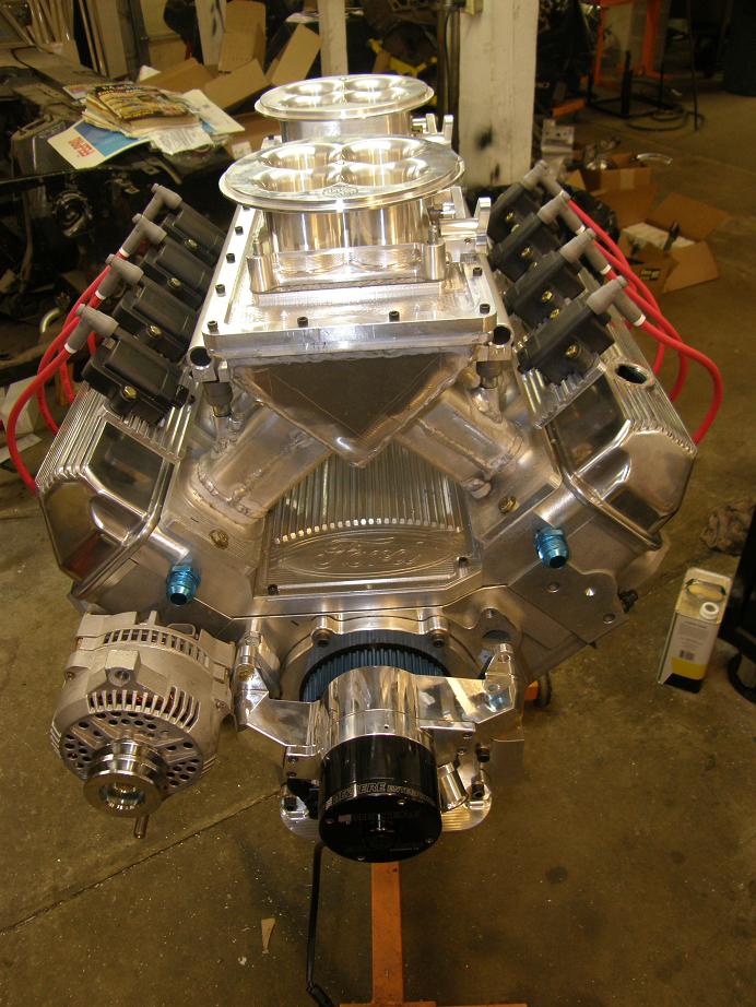

After this was done I started working on the coil mounting brackets.  This is a fairly involved part for a distributor-less engine, and I didn't want to take the normal course that most people take and mount the coils on the valve covers.  So, I designed a bracket to hold four coils on each side, and set it up to rubber mount to a couple of tabs that would bolt to two of the holes on each side of the intake.  I added some fins and some lettering the brackets to spice them up a little bit.  Here's a photo of one of the completed brackets, sitting on top of the engine:
Here's a shot showing how the brackets bolt onto the engine:

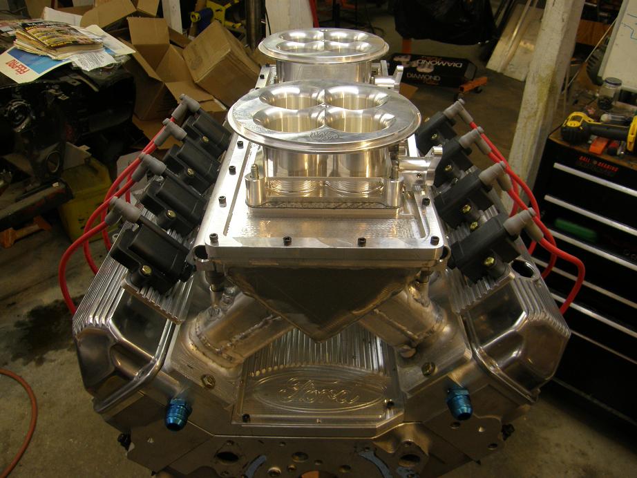

After mounting both brackets and then mounting the coils on the brackets, I decided to cut and install the spark plug wires to see how it would all look together.  Here's a couple of pictures of the engine at this point; I think it looks pretty good:

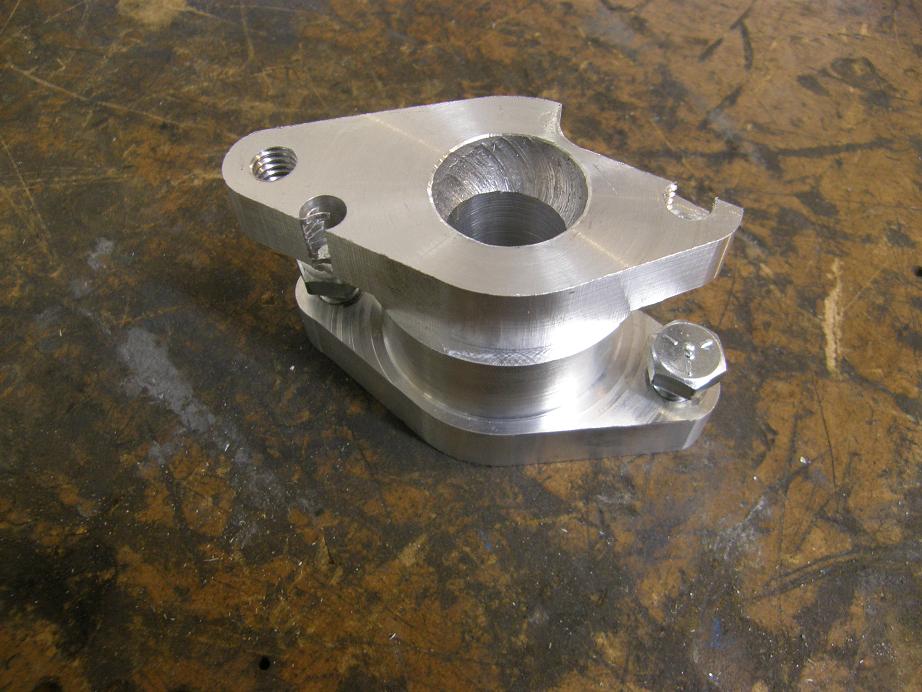

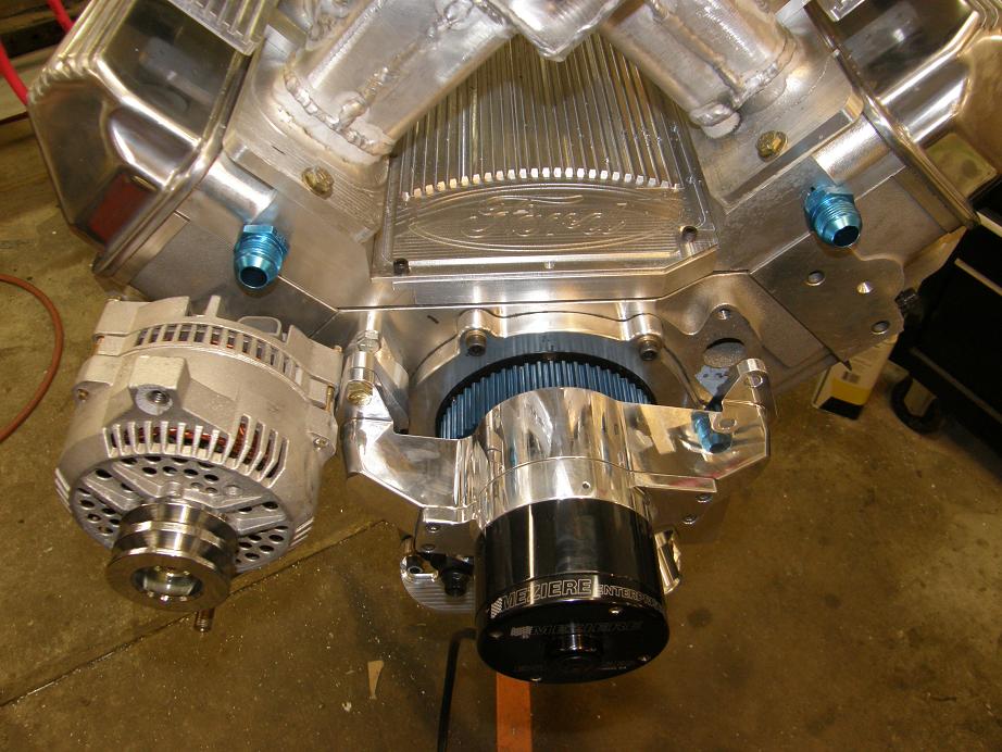

Finally, today I got started on making up some mounts for my new water pump.  I had decided to go electric a while back, but the standard Meziere electric pump wasn't recommended by Meziere for an engine over about 650 horsepower.  So, after doing a little research I decided to purchase a higher capacity pump for a 385 series Ford engine, and adapt it to the FE.  Today I took some measurements off the pump and designed a 2" thick spacer to do the job.  I started by turning a 4.5" diameter aluminum bar in my lathe into kind of a spool shape, as shown in the photo below:
Next I stuck the part in the CNC and machined the side that bolts onto the engine block.  After flipping it over and re-indexing the part, I started machining the other side, but fairly quickly it became apparent that I had made a setup error, and was not cutting the water pump side of the spacer correctly.  I figured out the problem and fixed it, but this was going to have to be a test piece, rather than one I could use.  Here's a picture of the botched spacer:
Nevertheless, I was able to test it out for mounting purposes, and it seemed to fit pretty well.  Here's a picture of the water pump mounted on one side with the spacer:
The whole engine, mocked up to this point, is shown below:
I have a plan for making the alternator bracket, and will try to start on that this week after finishing up the water pump spacers.  I also expect to be getting my Peterson oil pump in the next week or two, and have some ideas on how I will mount that on the lower passenger side of the engine.  The only other thing I need to get finished up is mounting the fuel pressure regulator and running the fuel lines, and the engine will be able to be completely assembled when the pistons arrive.

aww hell, now you're just showing off.
seriously, looks awesome, can't wait to hear it run!

Jay, the Jag engine for my land speed car is distributor-less and makes use of a coil-on-plug layout. The problem is that the individual coils are about the same size as your thumb and are prone to failure. I'd therefore decided to make use of the same sort of arrangement you are using. What is the source of the coils you are showing in the pictures above? Thanx!!!

Jeez Louise that stuff looks good Jay. I think you need to dress the welds on the runner tubes as they just don't match up blingwise. No knock on the welding, its just everthing else is so CNC/milled etc.
The adapted Mezeire pump idea is very cool and nicely ececuted.
Is there any need to pull water from the back of the cylinder heads to the front? I've done that for awhile now based on inut from Jon Kaase, I don't know if that applies to the version of the FE heads you are running. I've seen a lot a variation in the set-up. I have #8 lines, but I know some other very succesful guys with big Brand C engines that use #4. Supposed to even out chamber temps and eleimnate hot pockets and air bubbles.
I'm buying the race coils from DIY Auto Tune, www.diyautotune.com.  Here is a link:
http://www.diyautotune.com/catalog/ign1a-race-coil-p-394.html
You also have to buy the connectors for the coils:
http://www.diyautotune.com/catalog/crimp-connector-for-ign1a-p-395.html
Bill, I'm hoping that once I get done buffing the intake manifold with some of those balled up Scotchbrite pads in a die grinder that it will be closer to the bling of the machined pieces.  If not, maybe I'll grind the welds some, but I doubt I'll go that far.  Speaking of bling, I was thinking about painting between the fins on the valve covers, coil brackets, and manifold valley cover to make those parts pop a little bit more.  Maybe red, to match the plug wires?  Or Ford blue?  Or would paint in those areas be too much?
I know absolutely nothing about running coolant from the back of the heads to improve performance or even out cooling.  But if Jon Kaase does it, I'd better pay attention :D  Can you outline the performance advantages?  Is it just to keep the coolant temperatures more consistent around the chambers?

Hey, I like all the ideas. But, blue striping and red wires might clash a tad. Your fix on how to mount the coils is a great one as it cleans up the covers a bunch and allows them to be easily seen. The Chevy LS series comes to mind as those right-on-top-of-the-covers coil packs really look dumb and almost totally hide the covers!
On anodizing, I like that too but that would make the covers (or intake and/or valley shield) all one color and I think that might hide that nice fin work. But, I guess if say the covers were red and you carefully sanded down the fin edges you'd have that nice contrast again.
