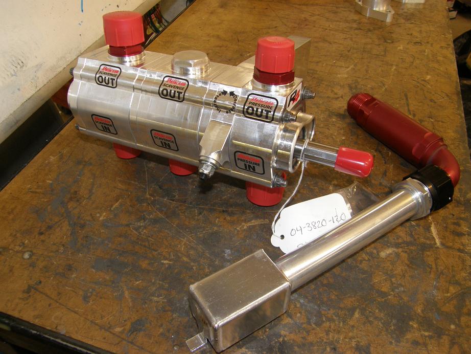

Just as I was getting the adapters bolted on the engine, the Fedex Ground truck arrived (rather unexpectedly on a Saturday), and delivered my new Peterson oil pump!  With the pistons, crank sleeve, and oil pump arriving here, the last couple of days have been just like Christmas.  I pulled the pump out of the box and was immediately surprised at how large it was; I hadn't seen a picture of it before I'd ordered it, and I wasn't expecting a pump that was this long.  Here's a picture of the pump, along with the inlet tube that has to be welded into the oil pan, and the red anodized large screen filter to keep any trash in the pan from getting into the pump:
I measured the length of the pump, and it measured 11" from the end of the shaft to the end of the body.  I knew immediately that this was going to pitch my mounting plan for the pump right out the window.  Sure enough, I jockeyed it into an approximate position in the Mach 1, and given the position of the headers and shock towers, it would not go back far enough to let the shaft line up with the Gilmer belt pulley machined into the crank spacer I had just bought from Aviad.  No big deal on the spacer, because I can use it on my big SOHC when I set that engine up for a dry sump.  But now I would need a separate pulley for the pump, to mount out in front of the harmonic balance.

Edit:  On further examination of the pump, there is no way that the scavenge section can be rotated with respect to the pump section.  The bolts holding the pump together are unevenly spaced.

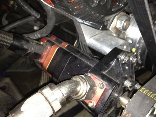

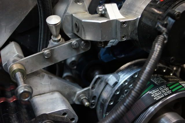

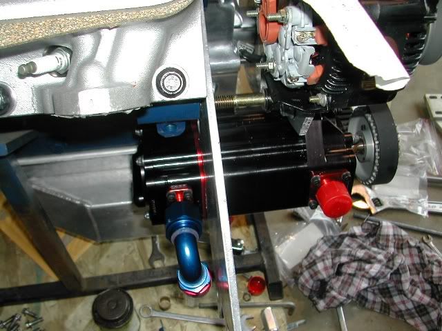

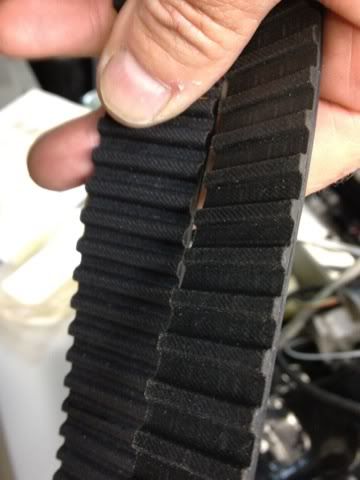

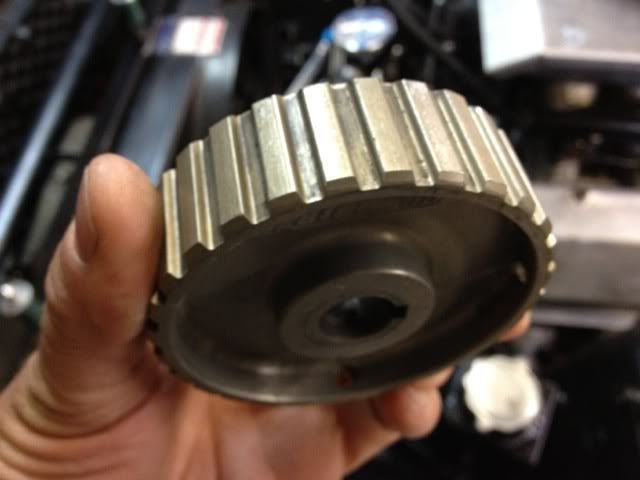

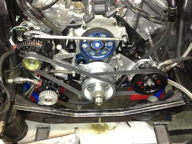

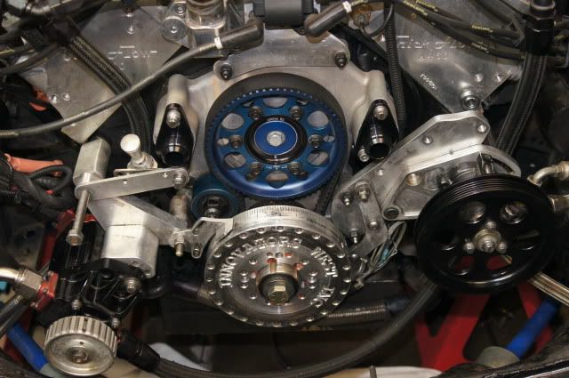

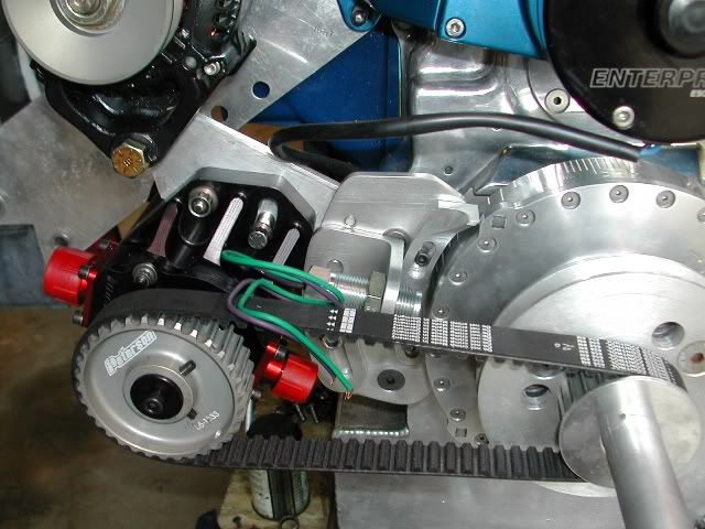

Jay I noticed one thning and metion a couple others. I relaized as I added this that its a bunch of stuff and some photoes are out of order in terms when they were taken. But I thought I might be able to save you some time.
The Peterson I have uses a Gilmer belt and pulley like the one below. The Avaid drive mandel you bought looks to use a Super Torque belt like you timing belt likley uses and they have different and non-compatble cog designs and belt pitch see comparison shot between the Super Torque used onthe Danny Bee belt dirve and the Gilmer used on my Peterson.

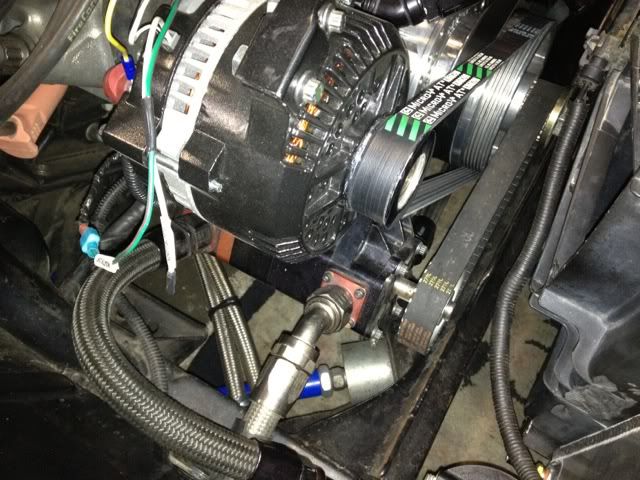

You have the new updated Peterson whih has the oil section up front instead of the back as mine does. In order to get the drive mandrel lined up and to clear various Mustang suspension components I added 2.75" spacers behind the Peterson supplied 385 mount. Their mount had an addtional sapcer ~1.75" out the front of it. It used the Ford alternator bolt and the lower front accessory mount bolt hole next to the timing cover. I used Grade 8, 7/16" all thread to sandwich my spacer, the Peterson mount and the alternator's main mounting point. The lower hole is 3/8" all thread with the spacer mount, timing pointer and tension rod for the Alternator stacked up. The first shows just the mount and the Wide-vac unit. You can see the #16 line that comes under the dampener form the pick up tube I installed on the drivers side of the engine. I need to add that pick-up ecreen at some point as my fragged lifter tore up the pump pretty good at DW '05.
I made a drive mandrel spacer which sandwiches the pulley to the dampener. My dampener spacer has the 36-1 wheel welded to it be hinf the dampener in that same space the aviad unit is designed to run the dry sump belt. I could never make that spacing work w for belt clearance nevermind the location of the Wide-vac.
I also ran a strap from the alternator stud to the water pump boss to help stabilize the whole assembly against the pull fo the alternator belt and the wide-vac pump drive. It also holds the Lokar dip stick.
This last one gives an idea of the relationship of all the pieces now. I added the little tensioner for the new Powermaster 200 amp alt after pitchng the belt in Topeka. The new motor revs faster and perfect aligment is more necessary that before. You can also see the mnadrel spacer. You should be able to make that in about three minutes given what you've been doing on the CNC. I used a lathe and a mill.
BTW this setup just survived the Run to the Coast, road course, speed stop slalom and auto-x so I think I'm good for DW now. Fingers crossed, now for paint and new hood.

Thanks for all the pictures, guys, they answer nearly all of my questions.  Bill it sure looks like you are correct about the differences between the belts.  Since I can't use the Aviaid spacer with the built in pulley, I will need to order both pulleys from Peterson, so I will see what they send me, but since I'm going to end up with both pulleys from them, it probably doesn't matter.  I think I can use that big stud coming out of the block like you did for the main mounting point of the pump.
That pump is so heavy I'm tempted to try to find another way to mount it at the back also, for better stability, kind of like the way it was done with the motor plate.  Bill, unless I'm missing something yours just mounts at the front.  Any vibration or stability problems with your setup?
