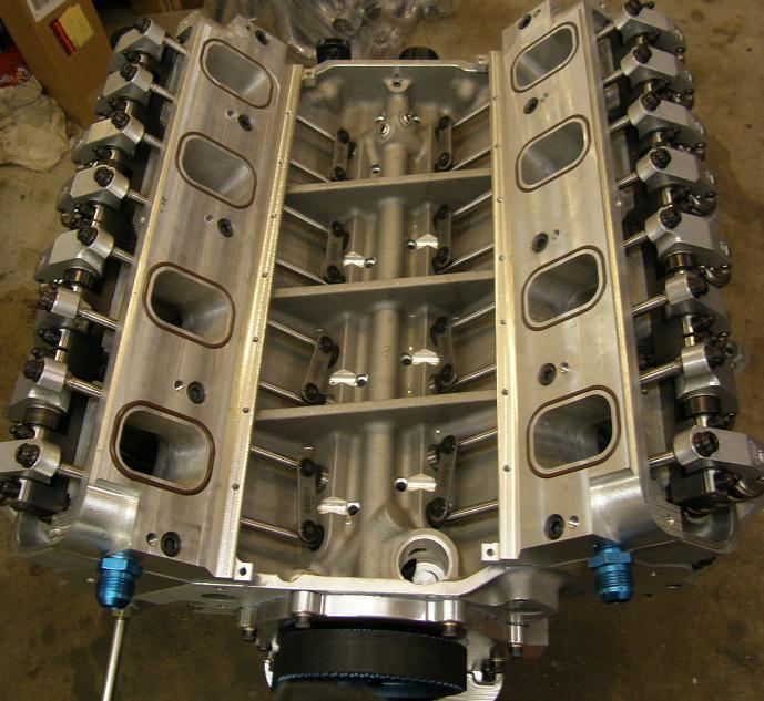

Holy crap those ports are huge!  What sort of flow #s did you get out of them?
They flowed 402 on the intake at .800" lift on a Superflow 600, and 390 on a Superflow 1020 bench.  They are really big, and I think I'm going to need to get to 7000 RPM before they really start working like they should.  The dyno will tell the tale...

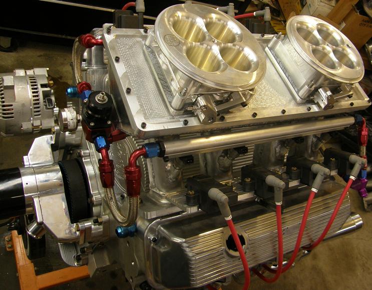

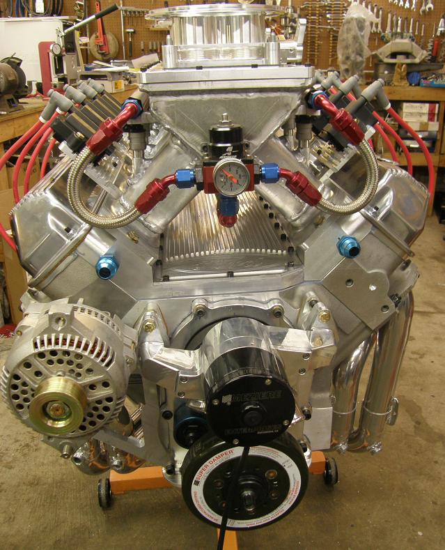

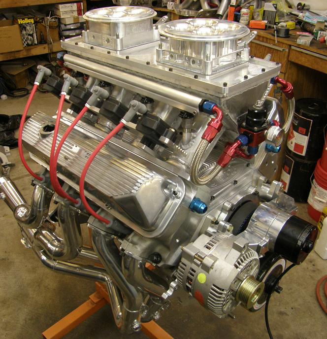

Most of this engine went together on Saturday this week without any drama.  That was more or less expected, because I had dummied it together a couple of times before, but there's always room for unexpected problems, so you never know.  This time there weren't any.  Here are some photos of the engine:
Despite looking complete, there is still quite a bit of work to do on this thing, including making brackets to mount the Peterson oil pump, a custom alternator bracket, brackets for the crank and cam sensors, a target for the cam sensor, finish welding and installing the oil pan and windage tray, etc. etc.  My pal Scott  Clark will be here in two weeks for the dyno session, so I've got a lot to do between now and then, but I think I'll be ready.  Today I spent the day on my old CNC machine making the oil pump brackets, and that turned out pretty well, so I've got a good start.  I'll post another update next weekend.
