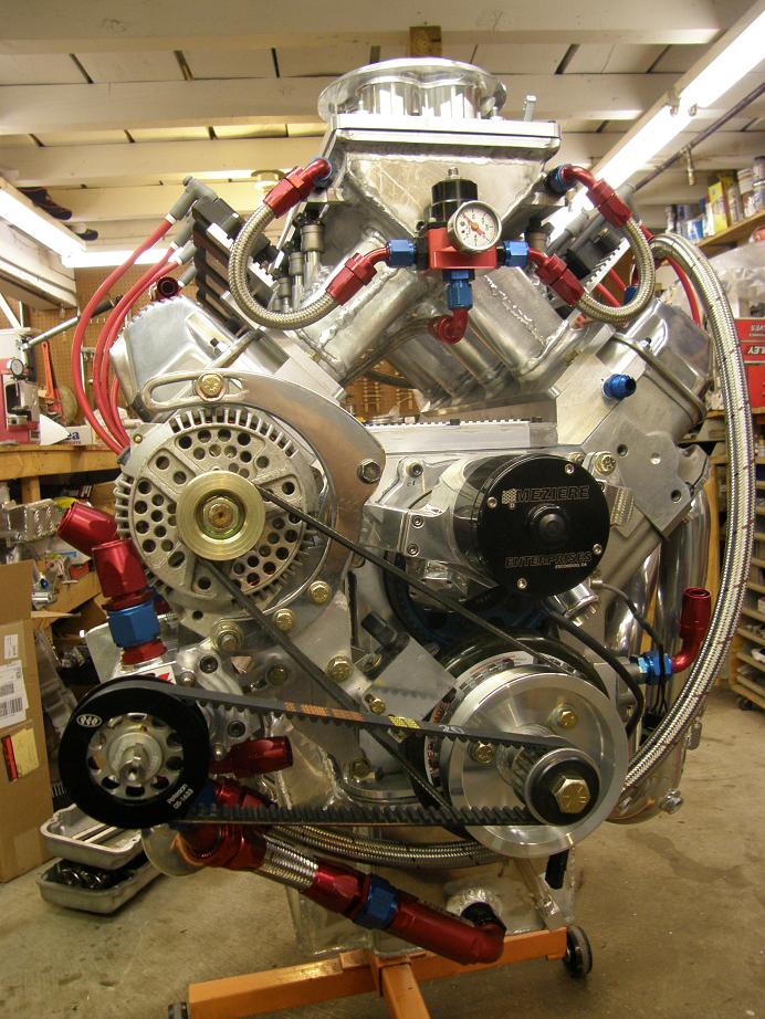

Finally, this engine is ready for the dyno.  I have spent the last two weeks building custom brackets for the crankshaft sensor and the cam sensor, the cam sensor target, the crank sensor target (this is the big toothed wheel in front of the harmonic balancer), and other brackets for mounting the alternator and Peterson oil pump.  It was unbelievable how much time this all took.  On top of that, it took me nearly the entire weekend last weekend to finish welding up my oil pan, make the swinging gates and doors, weld in the pickup tube, and leak check the pan.  Yikes, what a struggle!
Dyno day is this coming Saturday, and we'll run on Sunday too if required to get the engine sorted out.  Hopefully there won't be any showstoppers; that would put a serious crimp in my plans for Drag Week this year.  I'm hoping for 900 horsepower, but expecting more like 850; we will see what happens.  Here's a couple of photos of the engine on the stand:

Holy crap that HR engine looks like a beast!!!

The collectors look small for an engine of that output, will you be testing other sizes?  Or is the camera angle just messing with my eyes?

The collectors look small to me too, but they are 3.5" outlets, and the primaries are 2 1/8". They are merge collectors, so they neck down in the middle to less than 3". According to Blair Patrick, he has run those collectors on engines over 900HP, so I don't think they will be holding me back.  The part of the exhaust system that will really limit power production, in my opinion, is the immediate turndown of the primary pipes after the flange.  Wish the Mustang engine compartment had more room for the primaries to come straight out of the ports for 8" so, but of course it doesn't.

Muey bueno!!!!!! Your aluminun TIG is coming along nicely also. I see a sight glass on the front of the pan too. That's a good idea for several reasons.
