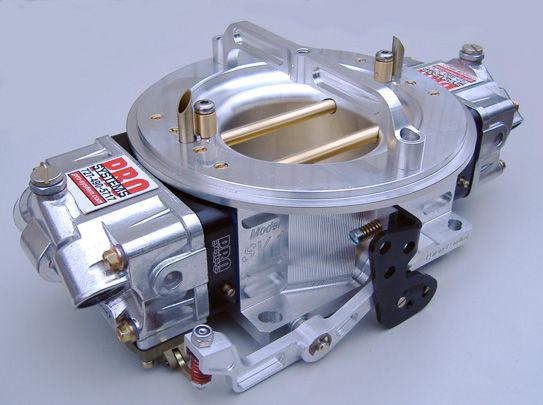

How about two of these?

Yeah, but they are almost "goof proof" ::) I just witnessed a Dominator on the dyno pick up several HP over a very well tuned 750 Holley.   Sometimes the simple things work, and we don't always need to re-invent the wheel.  I like EFI, but carbs are so easy, I just prefer them for racing.  Joe-JDC.
