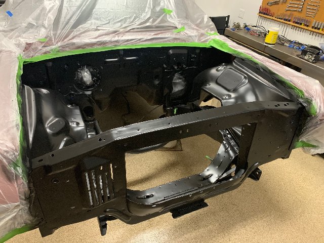

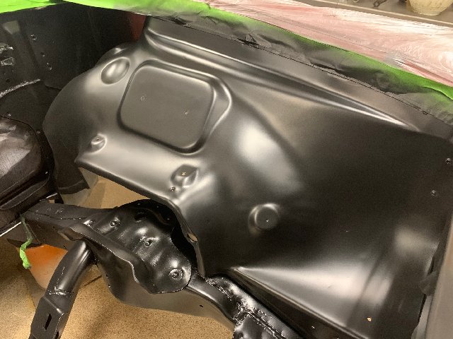

Well guys, I think I'm finally at the "bolt things back on" phase.

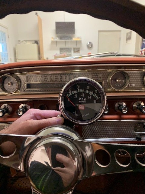

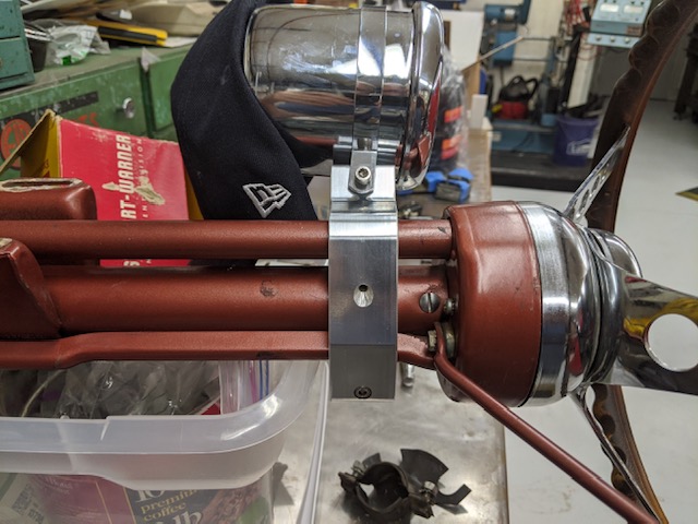

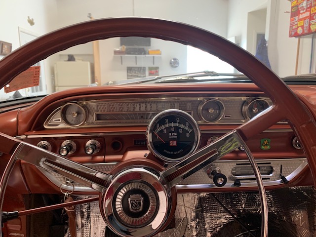

Another little side project. The factory steering column in a '62 500 car has no good mounting method for a tach. I've seen a few guys drill holes in the top of the dash (which I didn't want to do) and I've seen some other hold them on with a big magnet to the top of the dash. We drew up a sketch that captures all of the random tubes in a two piece bracket, neighbor Joe machined it. I'll end up painting the column and bracket so they all match and hopefully the bracket hides.
Up next is a restoration of the original steering wheel. It was in the trunk with the car. Has a couple cracks. I have the epoxy for it, just need to gain momentum again.

Thanks! I am planning on having Joe make a batch of these brackets. I want to make sure that it fits right first. We made a version 2.0 because this one was sitting too close the the air pull knob, I'm going to try the new one out tonight.
One thing I'm apprehensive about is we made this bracket to work with my Stewart Warner tach mount and I'm not sure how other tach mounts compare. I want to do a little R&D on other tachs first and see if I can't make the bracket fairly universal.
Also..... I tried this on our column shift column, won't work. It has to sit so far down on the column that it runs the tach right into the dash. I think it would probably work for an auto car but we don't have any of those columns in the barn.

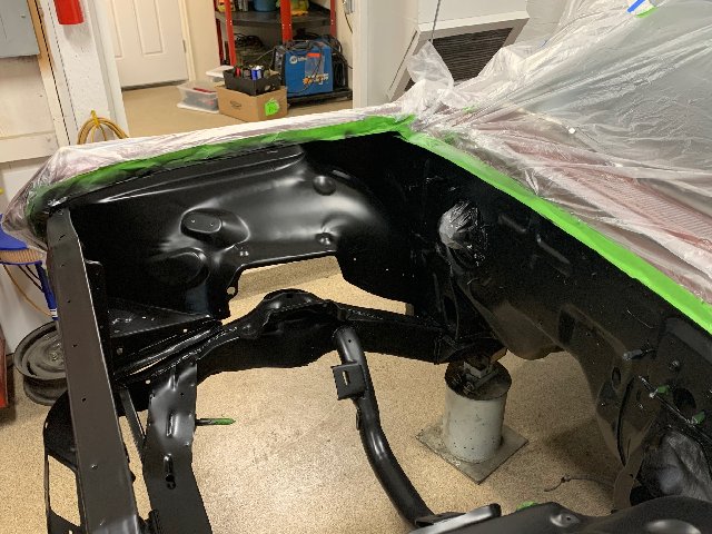

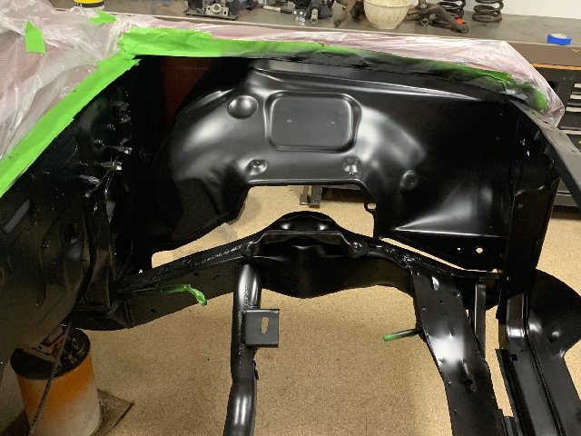

Well, the only thing holding me back now from getting the interior back together is the fuel lines....odd statement right? But the body has to come off the frame to get the fuel lines in. I've been dreading doing this but it needs to be done. I bought (2) 3/8" lines and I'm going to run them in parallel. My thought is if I ever switch over to Sniper fuel injection I can run one as supply and the other return. For right now I'll Y them together and have the equivalent of a 1/2" line.

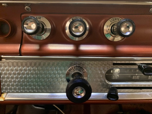

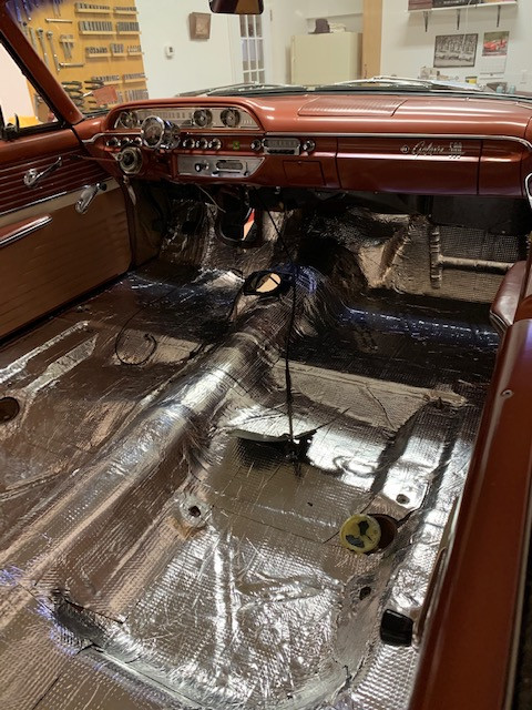

Pulled the instrument cluster apart so I could work on the heater trim panel for the overdrive switch. Repainted everything while it was apart, took the opportunity to install new bulbs as well.

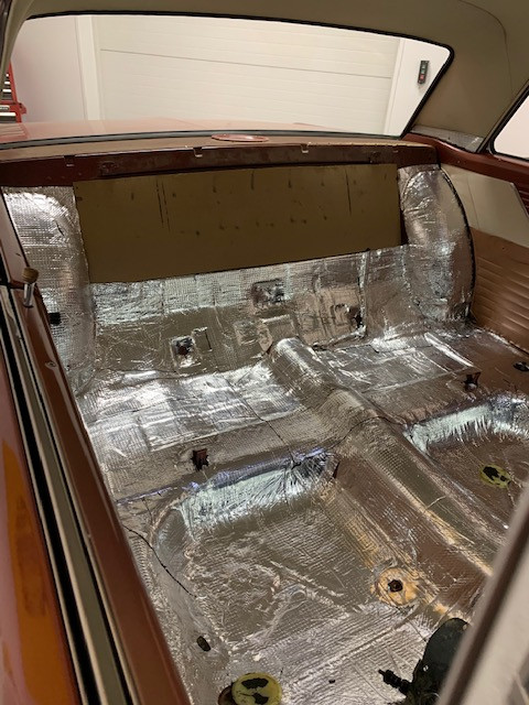

Floor is all lined with sound deadener now. The material came from Stock Interiors, I didn't like how dynamat had their branding stamped on the material. This stuff seems a little more "normal".
Was real happy with how the material laid down. Here's where I got it:
https://www.stockinteriors.com/STPSilver.asp?Itemid=22658

Mike, looking great. I love that Emberglo color on the '62s.  And thanks for the link to Stock Interiors.  Did your car have the rear seat belt reinforcements welded on the floorpan from the factory?  My Dallas-built '63 did not.  And yes, the body needs to be lifted to install those fuel lines.
