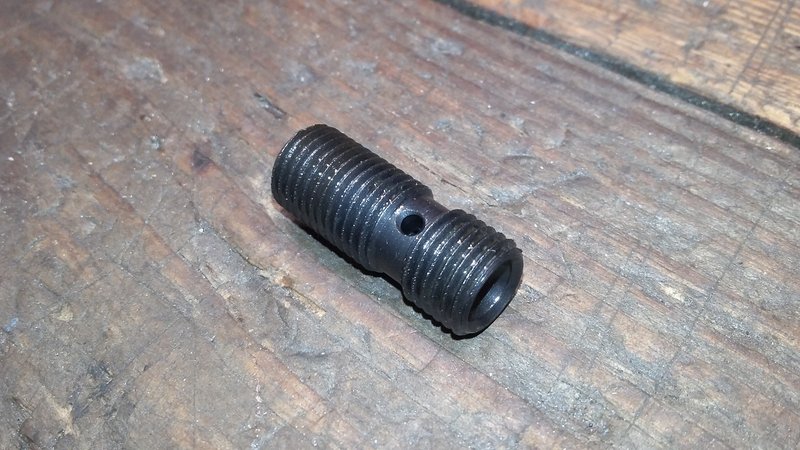

I believe Frank is referring to something similar to this hollow rocker adjuster.
  • Posts: 1345
Re: '58 Edsel 361 Build
« Reply #16 on: December 12, 2020, 04:04:40 PM »
Yes, thank you.
  • Posts: 5399
« Reply #17 on: December 12, 2020, 04:17:28 PM »
That'll work.  Picture's worth a thousand words.

Brent, I wish there was a way to clean the water jackets, here locally. I do know the process you speak of, isn't available, in my area. Regarding the cam bolt, as a machinist, my idea is to drill the bolt, relieve the threads, in the passage area and then cross drill to the hole in the center. Kinda like the cam bearings journals are done.
