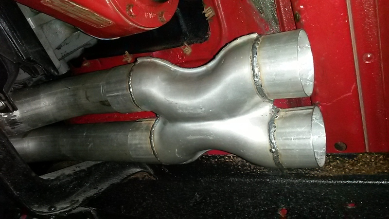

« Reply #34 on: September 08, 2020, 06:29:33 PM »
2-1/2 cross over with 3 inch pipe and ultra custom light weight PVC drive shaft
Sorry if the pic is big

I run full 3 inch mandrel bent with a 3 inch X-pipe.  I turn immediately toward passenger side with both pipes, then run down the frame rail side by side, then back to normal position behind the tranny.  There is plenty of room for 3 inch.
Originally I did this with a Dynomax kit did this in the 80s with 2.25 and no crossover, I copied the concept when I did big pipes.  I used to cross the left and right side, left bank/right outlet.  I used to think it was better to keep them sort of equal length, but couldn't do that with the 3 inch and I think the X-pipe does me good anyway.   This is a shortbed 4x4 with a married case, I would expect an F250 to have more room
These of course are laying upside down on the floor and miserable Flowmasters live on the shelf awaiting anyone else but me :)

69 Crew. That is pretty clean.  My long tubes may not allow for that crossover as they end right at the X-member. I like how you did it. Turning the muffler up helps to.  My concern would be the piping hanging below the frame, but after this expense of building this thing, I doubt it ever sees serious off-roading again.  Doing it like you have it would allow more working room for sure.
Ross,
You would think so, but having the divorced T-case takes up A LOT of room. The passenger side drive shaft(front) is really long and gets in the way of everything on that side.   On top of that they are narrow between the frame rails.  No way you could run two pipes side by side like in your pic.  Things are working completely against you from about the cab forward.  Not impossible but tricky...maybe impossible for the only muffler shop around here.
I gotta get it figured out soon though.  I am buttoning up the wiring and maybe a week from the first fire.  Neighbors are going to enjoy the open hedders but I am NOT putting the second rate piping and glass packs back on it.  Did Pterodactyls "Kakkle"? I imagine the noise this thing made with that setup had to resemble a prehistoric nightmare. HAHA.
You don't like the flowmasters...????I have them on my 68 with a Dr.Gas x-pipe..Have considered a change.I see yours have turned gold as well.....
