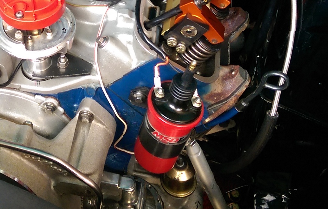

  • Posts: 4609
Re: Hooker Super Comp 1-3/4 Headers - Max Horsepower?
« Reply #14 on: May 21, 2020, 04:21:22 PM »
I couldn't find the close up pictures I had of the header/shock tower fit, but here's one that I cropped that shows how tight it is. There was no way a bolt would fit if I hadn't beaten the towers back. As it is, the bolt still barely fits, but on 8 bolt heads, you gotta have that bolt. The dings and scratches are from before I added the engine limiter, strap, whatever you wanna call it.
