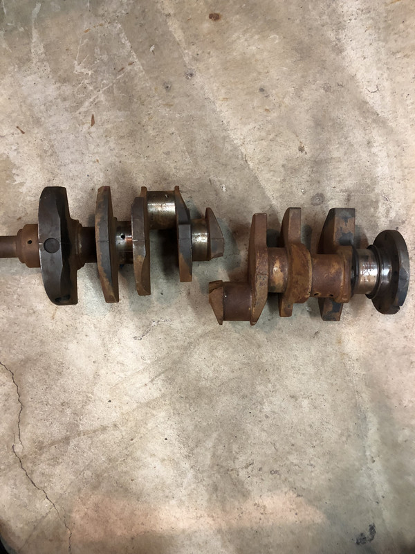

... Picture of one of my Ford 428 cranks.
If I was that rusty and someone dropped me on that concrete, I'd have spinal alignment issues, also.
Re: Scat crankshaft
« Reply #18 on: March 26, 2020, 09:05:02 PM »
That crank broke when it was in the car, thatdarncat's 67 Shelby.  It's been sitting around for a while, obviously...

Stock Ford cast FE, and 428, cranks are good, but they’re not invincible. Don’t get me wrong, I still use my Ford cranks, but like Jay said, the Scat crank is fine too. Barry has commented on the Scat counterweight - piston skirt interference before, so it’s not an unknown issue, Since you have the Scat crank I’d probably consider Barry & Brents advice and look into either an exchange or have your machine shop make the required modifications. Picture of one of my Ford 428 cranks.
I broke a 428 iu crank just like that one. It could pass for mine ..

Just offhand, I can think of at least 5 forum members who have broken 428 cranks over the years. All drag racing, but that's the caveat of a used crank, you don't know what its been through.

      From our experience over the decades of magnaflux testing of Ford O.E.M. 428 cast iron crankshafts, on what I call "first-go-a-round" (at least it's still standard bearing journal size anyway) with generally typical passenger car use, I'd say about 20% have proven to be failed (cracked)!         :o
      This being perhaps slightly better than the typical 5.0 S.B.F., but probably the next most likely to prove cracked unit of any in the Ford V8 lineup.          ;)
