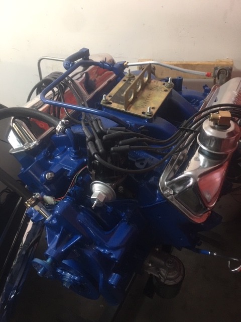

I am bringing two engines down to Kentucky on November 15, going to have a couple dyno days, good reason to hang around with Brent, escape Nebraska for a working couple of days "off", along with a good midpoint for the owner. This is the first of two 461s, the second I will post in another thread. I figured I'd throw it out to see what people think.
The reason I say some cheating included is that I have dyno data for a nearly identical build, same dyno, and I will include the changes here, so you are really only guessing the difference of the parts.
Here is the first CJ that was done on the same dyno.
http://fepower.net/simplemachinesforum/index.php?topic=7690.0

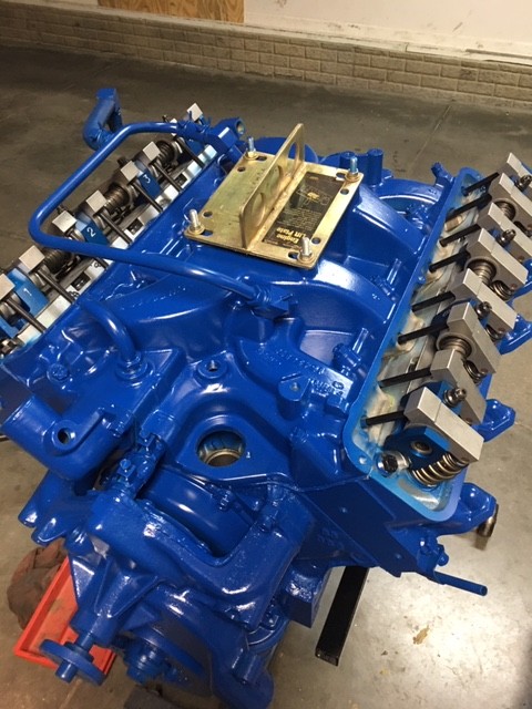

Here is the engine to be dyno'd, different engine completely, but listed all the changes from the last one
461 cid 428, 10.3:1, Racetech dish pistons, 1.0/1.0/2.0 Mahle rings, .010 above deck, .041 quench (all minor changes)
Heads went from CnC ported CJ iron, to Trick Flow heads name milled off to hide them a little
Intake went from locally ported CJ iron, to Joe Craine ported -F PI intake flowing between 350-370 cfm per port
Cam went from 237/237 .634, 114 LSA on 106 to 235/237 .634, 114 LSA on 107
Carb went from 830 cfm Quick Fuel Brawler to custom built Quick Fuel 780 cfm vac sec
Connecting rods went from SCAT 6.70 to Molnar 6.70 much lighter
Windage Tray went from Ford factory CJ to Canton Screen
Oil pump went from M57HV out of the box, to Doug Garifo bluepwinted M57HV with standard spring, shimmed with his provided +10 psi shim
As you can see, many small changes from the combo this summer, the biggest being the Trick Flow heads.  No prize forthcoming, but there will be a second engine to guess, and all the glory that comes with guessing it correctly!
This one is going in a 1968.5 CJ fastback Mustang, 4 speed, 3.91s

Really good day on the dyno with the TF headed motor.  Really big flat curves and big numbers for a 235 degree intake lobe and 114 LSA, 780 carb, no carb spacers, dual plane, 30 degrees of advance.  Looks like a bone stock 68.5 CJ externally
HP 568 @ 5500 (carried 560+ hp from 5250 to 6250)  Only 8 hp lower than peak at 6250 rpm
TQ 578 @ 4750 (freight train torque curve at or over 570 fl lbs from 3250 rpm t0 5000 rpm!)
As with the other, I will post the numbers in the dyno section when I get home!  This will be a very mean little resto Mustang
Another great day with Brent and the gang, hope to get back soon with another build!
