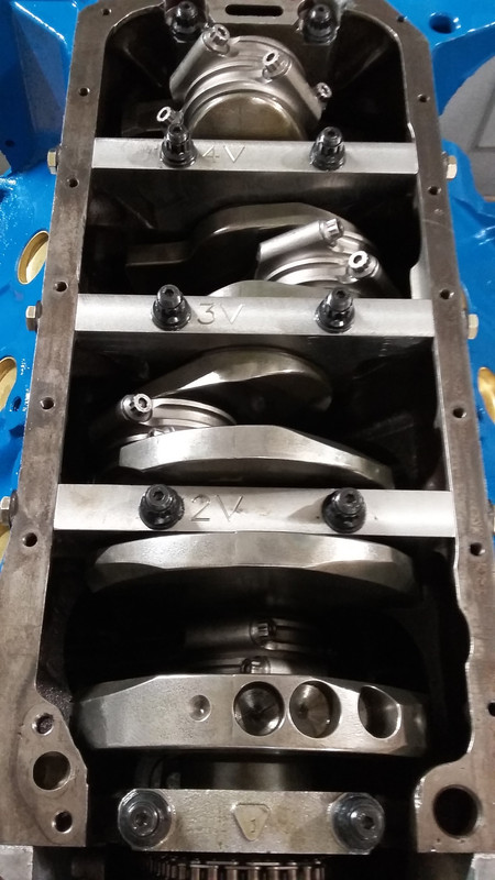

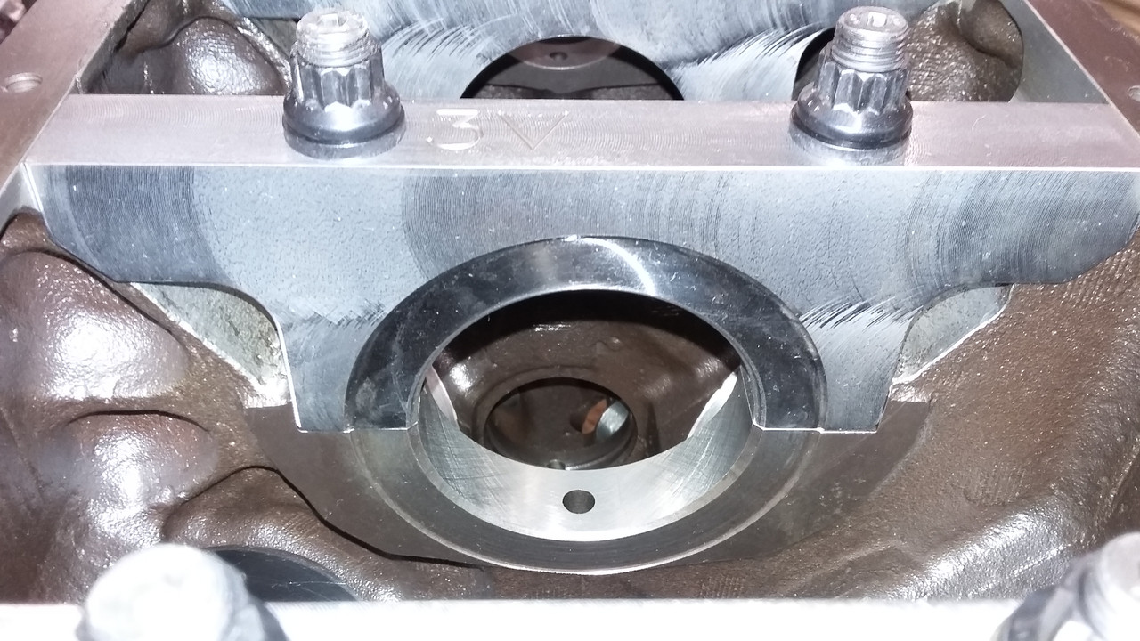

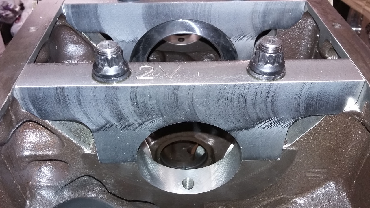

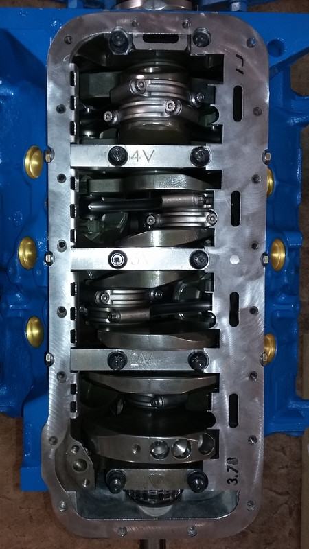

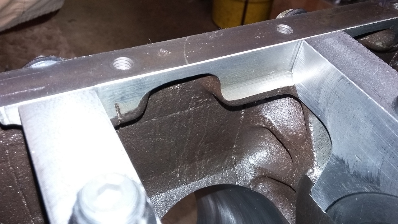

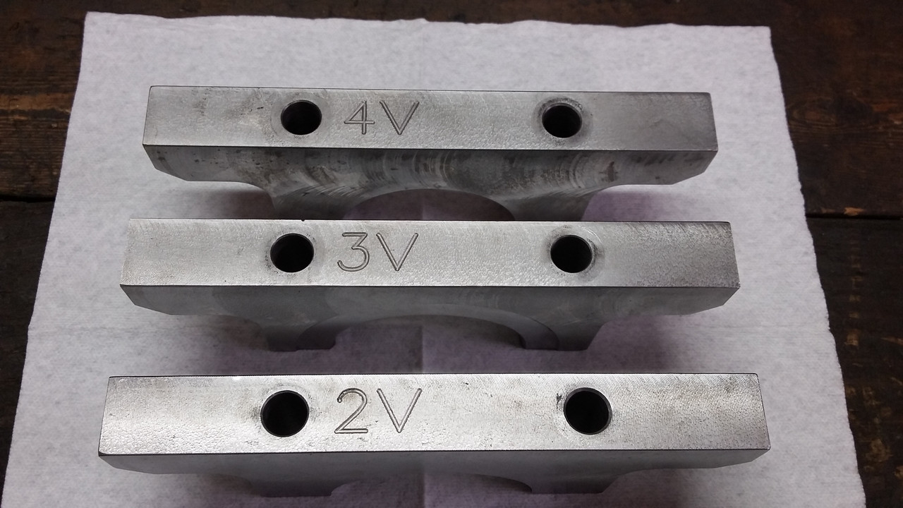

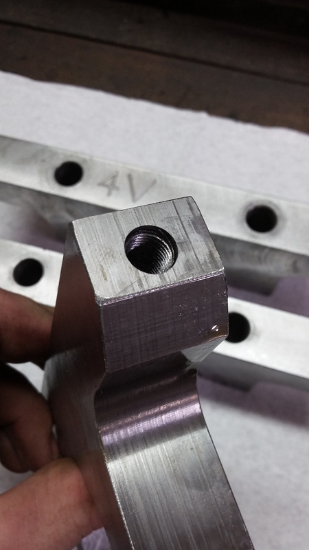

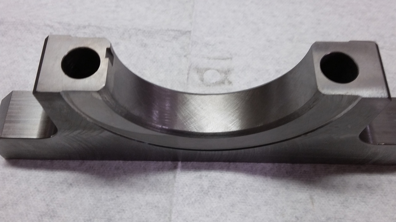

Starting with the mirror 105 block, it was cleaned and magged. Extensive oil mods throughout. Went to a local machinist who made some nice custom cross bolt main caps. I told him what I was looking for and he delivered. 4140 steel caps with 2-2 1/2 thou press on each side into block skirt. I told him keep them close to pan rail to not cut as much from the main webbing.
#5 cap modified for studs. Deburred edges later on...
I later added some 3/8"-24 shallow holes for slide hammer removal

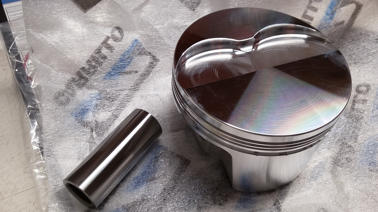

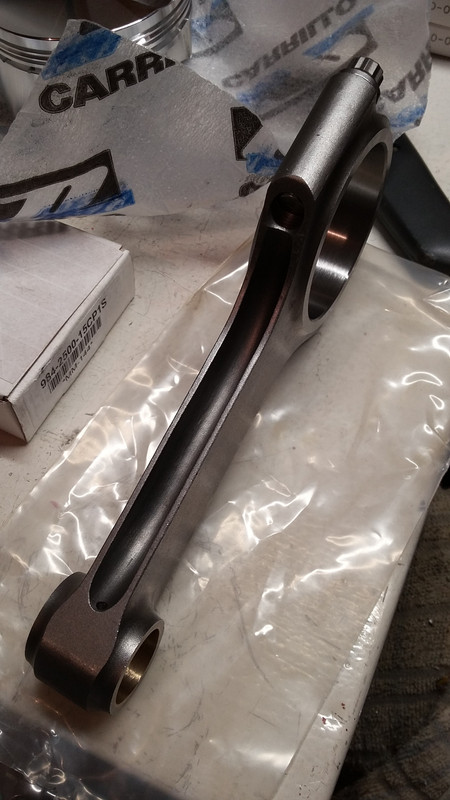

Block needed four sleeves, two on each bank. No sleeves were adjacent cylinders, luckily. I unshrouded for the big valves. Block decked and left pistons .003" down. Crank was still at stock journal size. Crank was cleaned, magged, shot peened, ground, and polished. I ordered 10 under bearings for mains and rods and had clearances set. Crank also got some special treatment after it left the machine shop.

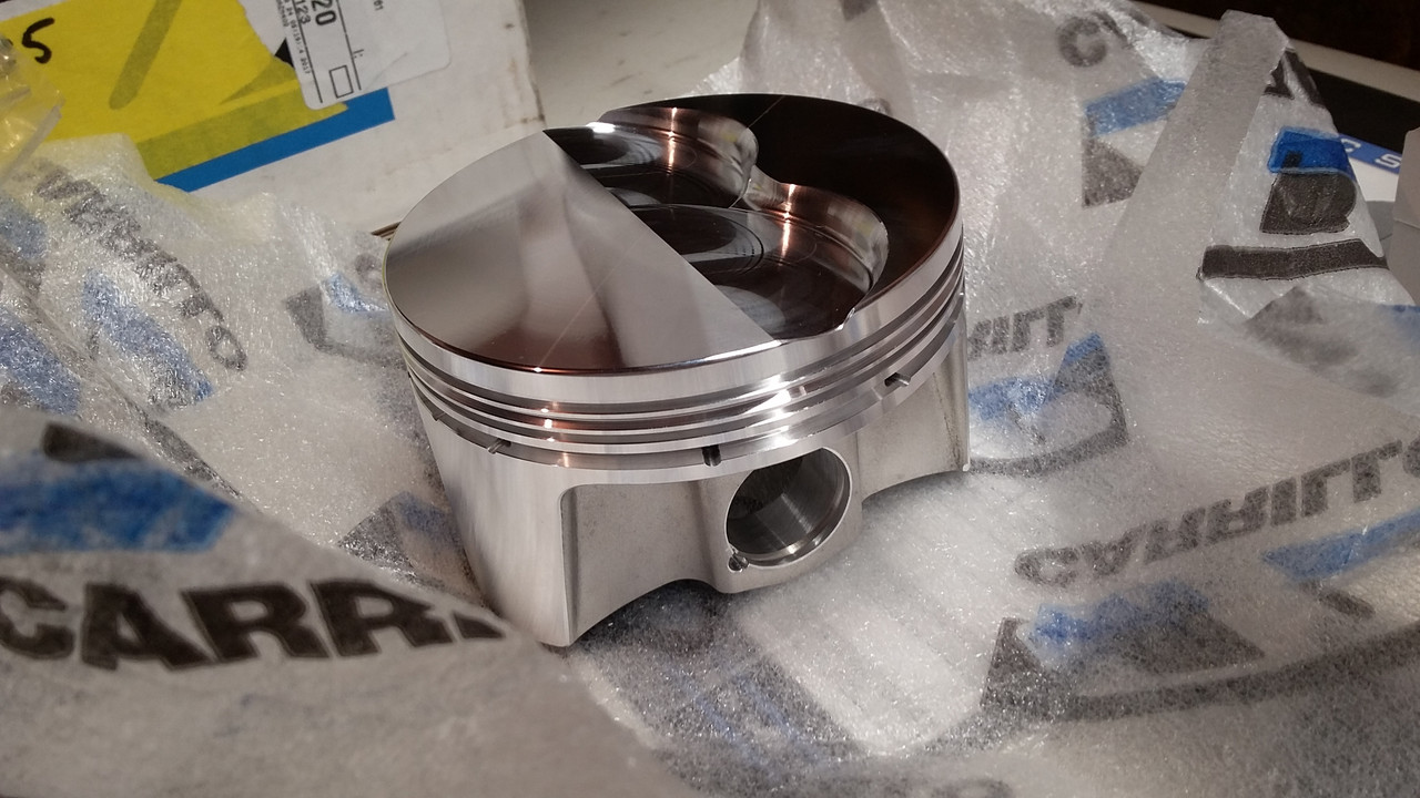

Rods and pistons:
« Last Edit: September 03, 2019, 12:56:37 AM by Nightmist66 »

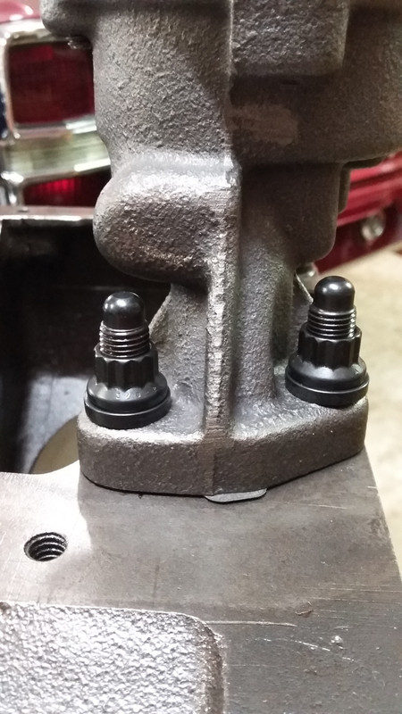

Blueprint everything. Here is why you should spotface or mill the bolt hole pads flat on the oil pump. New pump mocked up with studs snugged up:

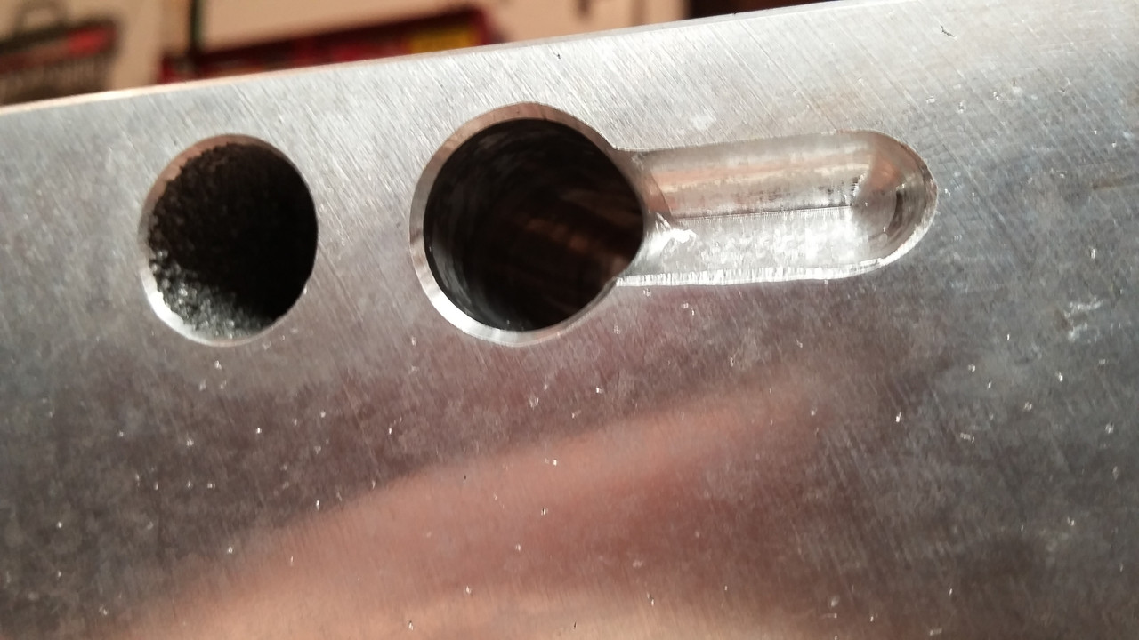

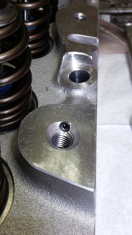

A couple oil mods to the heads. Radiused feeds, enlarged and blended drainbacks, and tapped feed hole for 12-28 set screws drilled for restrictors.

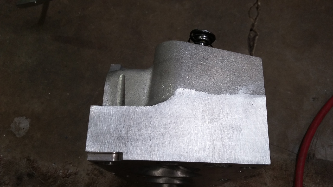

Heads got some logo removal for a stock look once painted. Rough cut here and finished with some sanding.

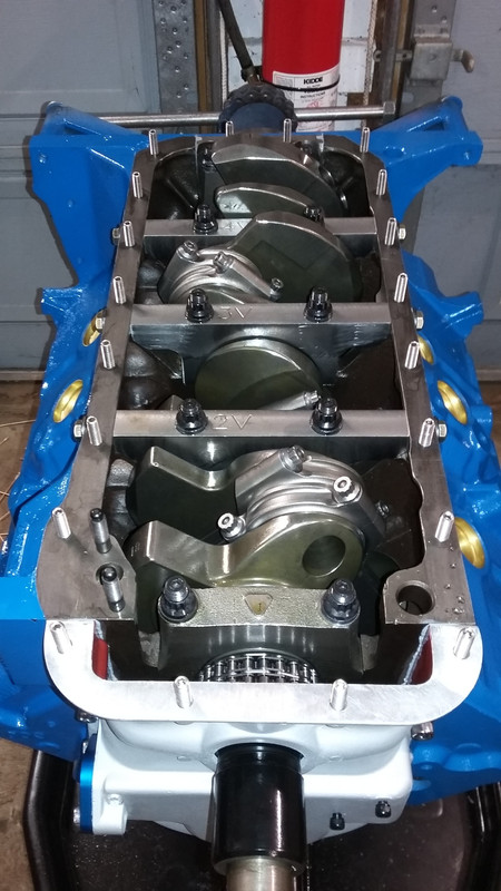

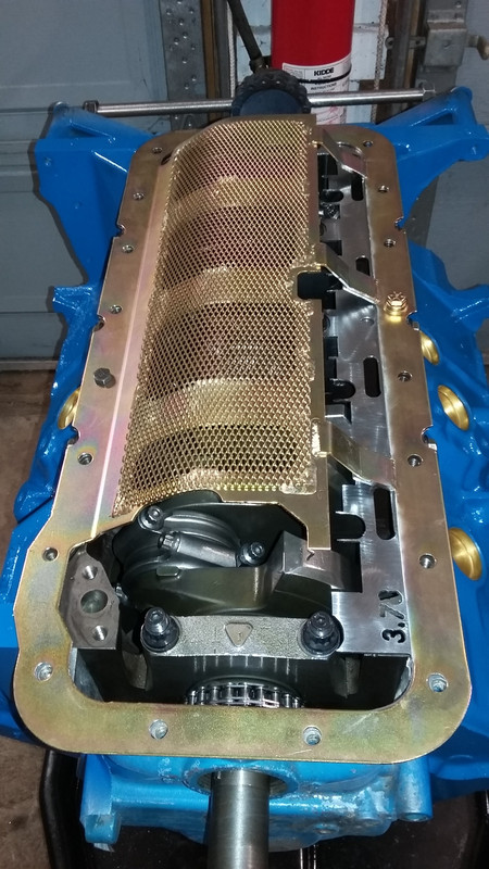

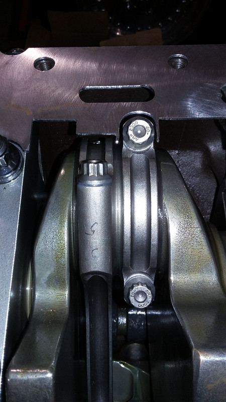

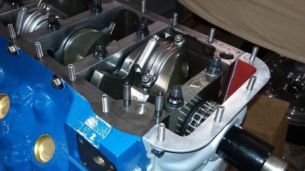

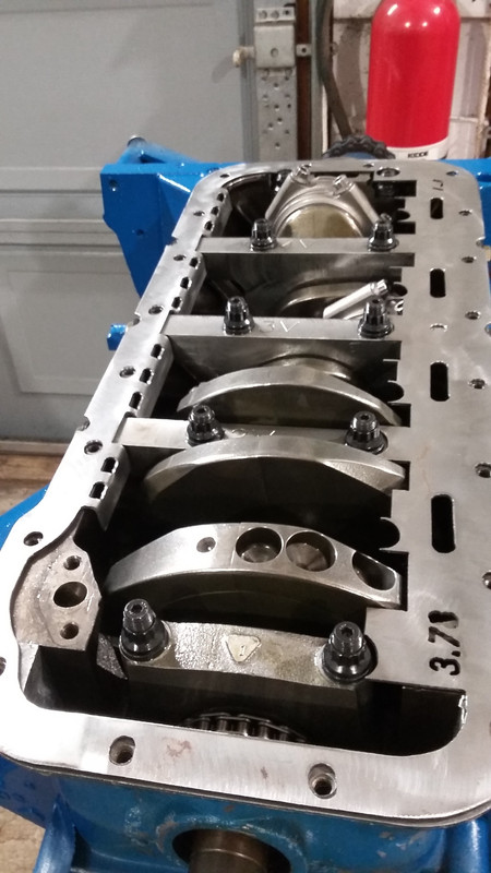

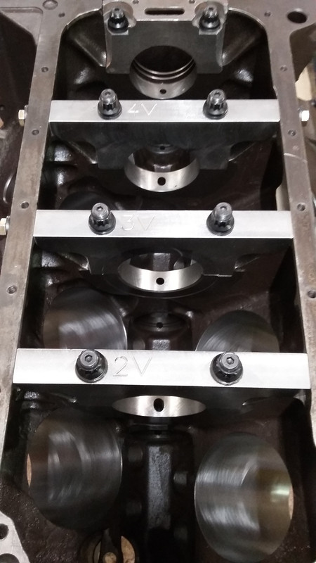

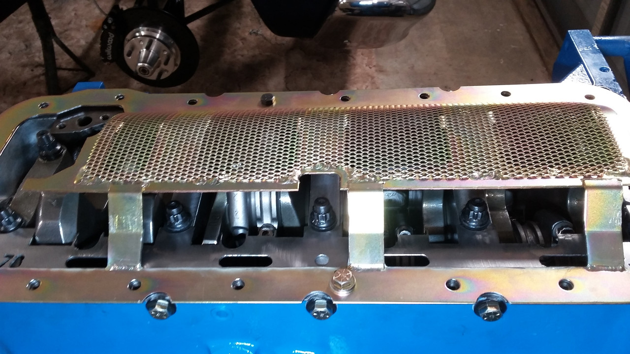

Rotating assembly in and checking fitment for crank scraper and windage tray. Crank scraper took some fine tuning to get everything in check. I removed the small scraper from the Canton tray.
« Last Edit: September 03, 2019, 12:16:50 AM by Nightmist66 »

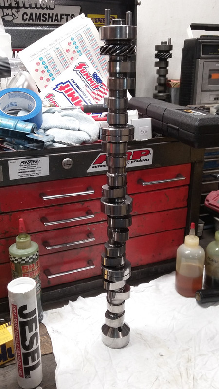

The bumpstick. Solid roller. I don't want to give the specs. Lift somewhere between .6-.800", duration between 260-280. Lobe separation is 110, 106 centerline.

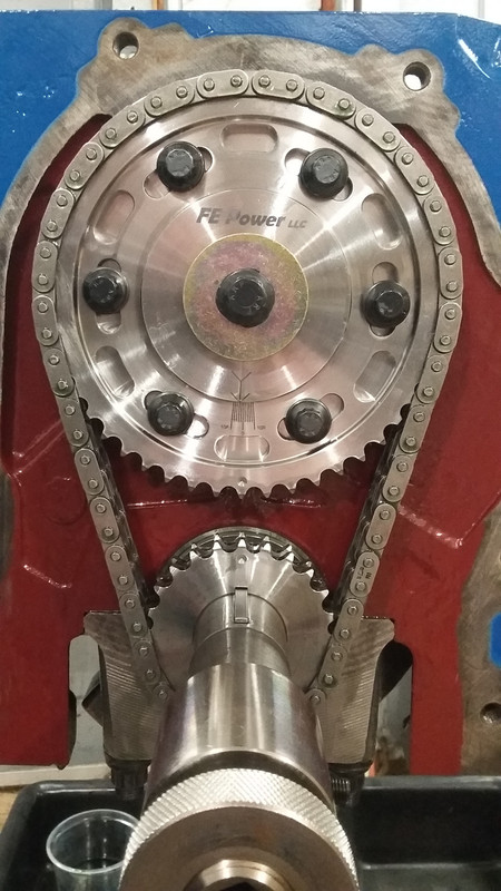

Degreed in with Jay's adjustable timing set.

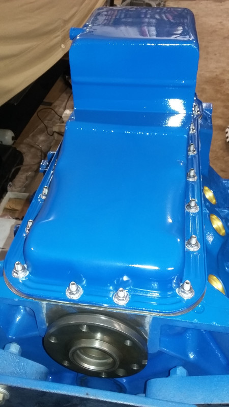

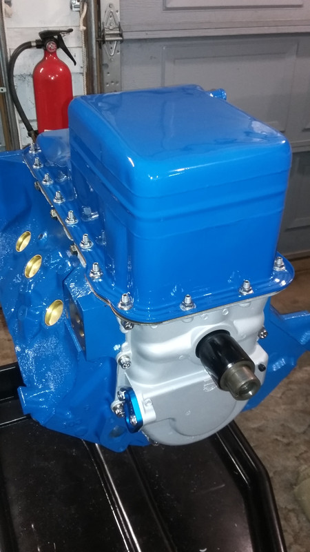

Wrapping up the bottom end...No side seals on rear cap. Filled channels with Motorcraft TA-31 and installed cap. Then, I stuffed more in until it squeezed out the rear. No gaskets on the pan rail, silicone also. Timing cover got silicone, too.

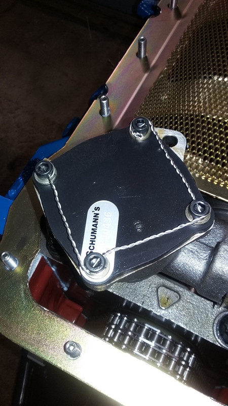

The oil pump got a special treatment also

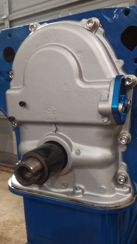

I had to grind slightly on the vertical casting rib on the back of the timing cover to clear the ARP bolts I installed in the cam gear. Small detail, I drilled and tapped the upper 4 timing cover bolts to 3/8" also. Never understood why they made them smaller.

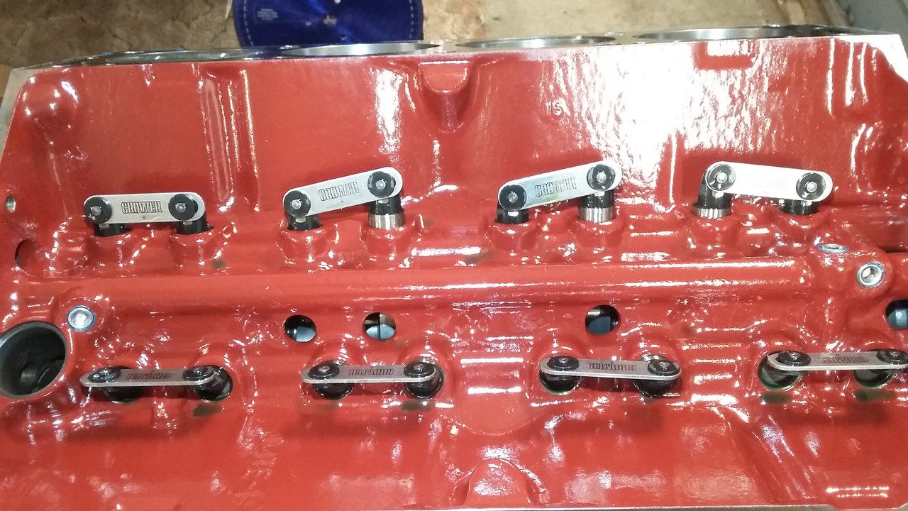

« Reply #7 on: September 02, 2019, 10:39:56 PM »
Crower HIPPO lifters and Victor 3389 head gaskets installed.

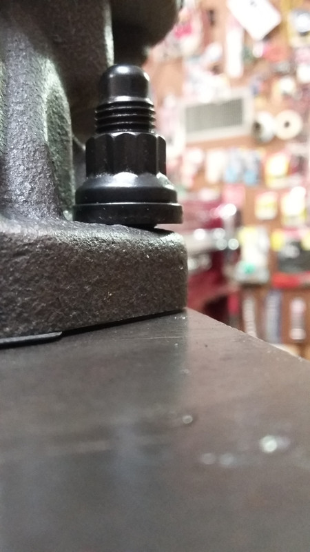

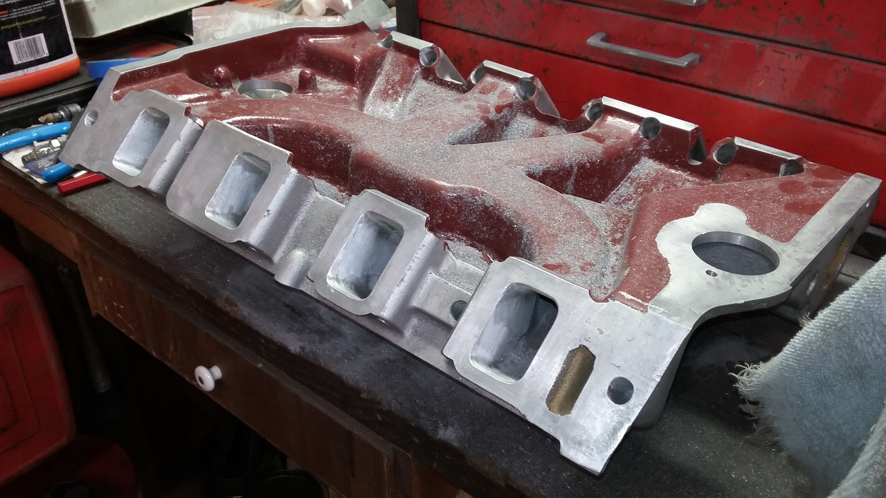

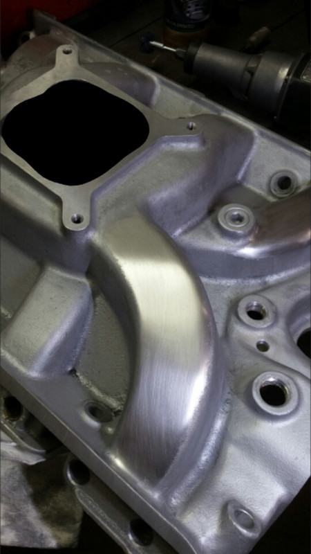

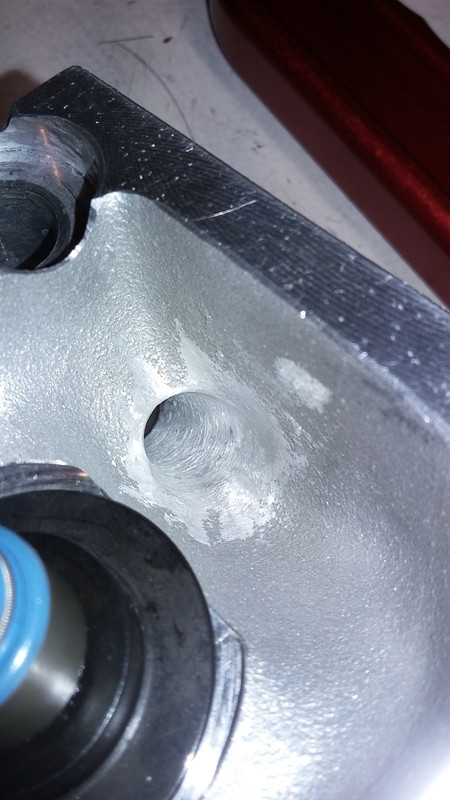

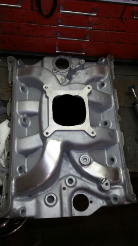

This step was obviously performed before the last post. Intake got some work. Pushrod holes opened and elongated. Port matching to heads and plenum modification. Plenum mods are covered, sorry. Also removed all Edelbrock logos, part#, and casting lumps on top of ports.
After this step, I went to Harbor Freight and bought a cheap needle scaler. I rounded the ends of the needles and re-textured the whole intake, so it loos like a solid clean casting.

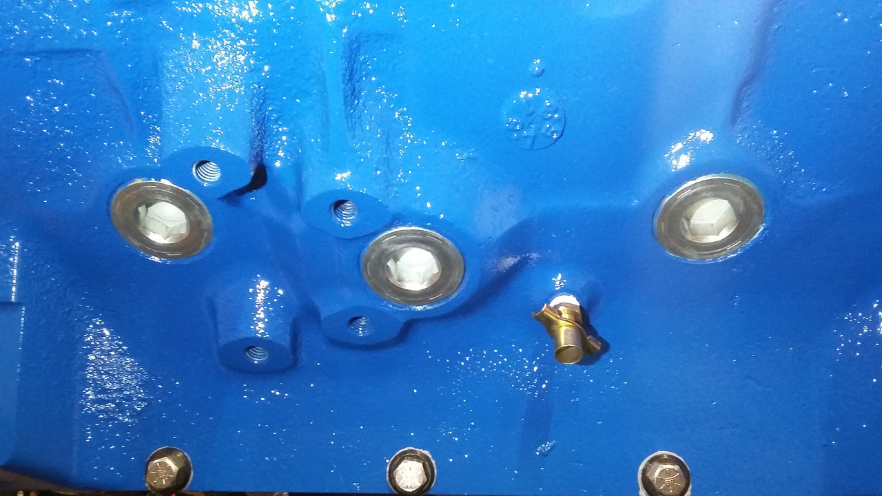

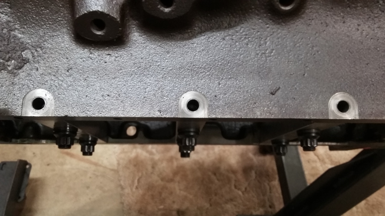

While the block was bare this time, I decided to tap for screw-in core plugs. I got these from DSC. .650" thick. I used two taps, one cut about a quarter inch shorter for a "bottoming" tap.

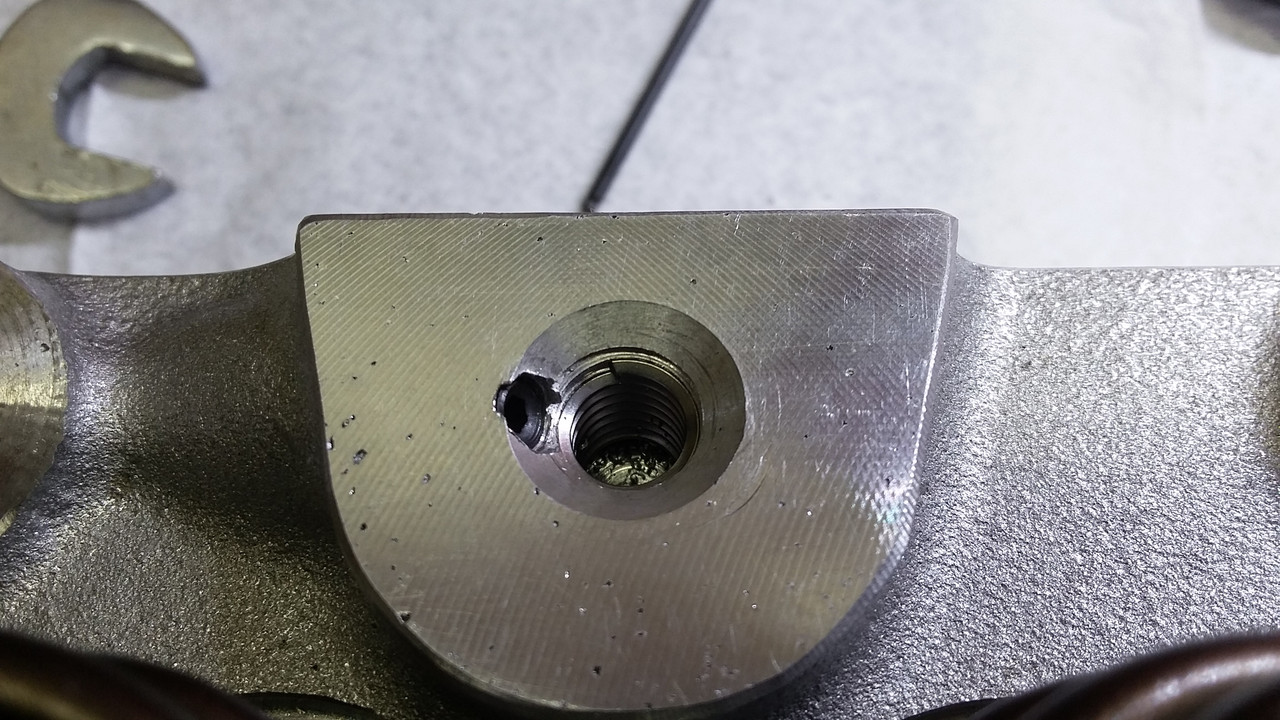

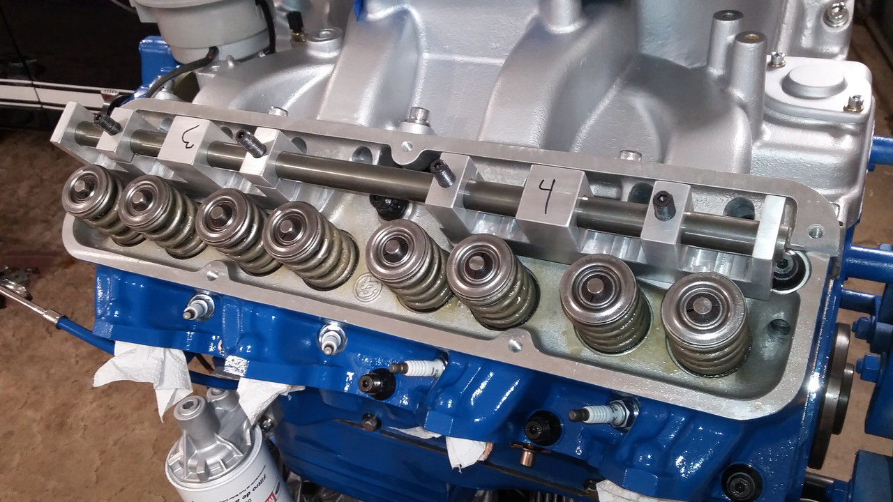

Rockers are a new set of Erson's. I used DSC heavy duty shafts. Upgraded thread inserts in the head. I didn't like the geometry with the stock stands. They needed to be raised .030" to be perfect. Sweep came in at just under .050". I also didn't care for the sloppy bolt holes in the Erson stands. I had the guy who made the main caps whip up some new stands. Material is 7075 aluminum. .030" taller, flat base( I clearanced for head studs), and finish reamed the holes to 3/8". It is as precise a fit as you can get. I install the rockers with the studs already in the stands, and drop in place and carefully start them all. The rocker studs are ARP. I also got new ones and had the oiling one necked down. I left the shoulder low, so it registers in the top of the stand and about halfway through the shaft, so it still oils fine. I also gave a generous chamfer to the bottom of the oil feed hole in the stand.

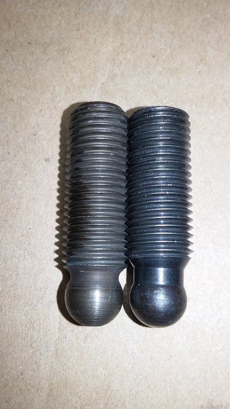

The adjuster screws are another nit pick of mine. I compared the ball end screw adjusters from Erson, Harland Sharp, and Crane. The Harland Sharps are the nicest, IMO. the ball has a nice radius and is the closest dimensionally to the 3/8" size. You can feel the difference moving them in the pushrods cup. Harland Sharp has a precision fit. Picture is HS left, Crane right:
