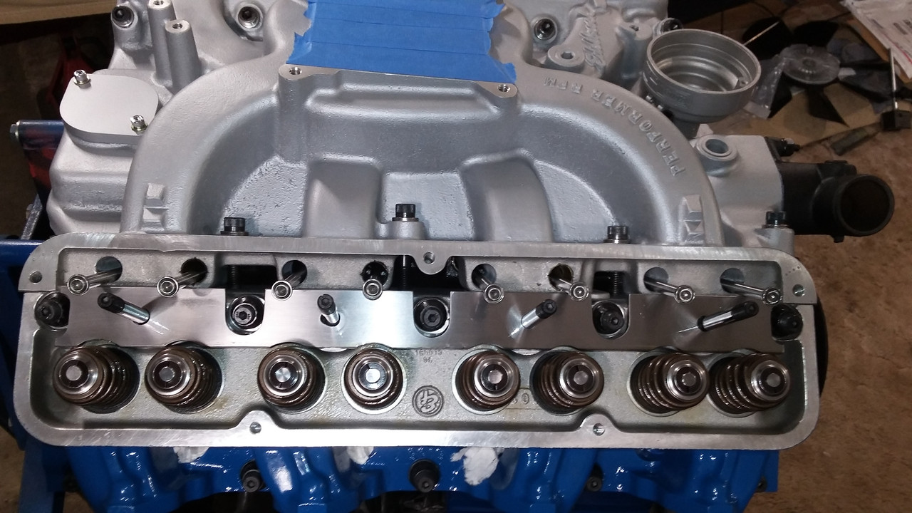

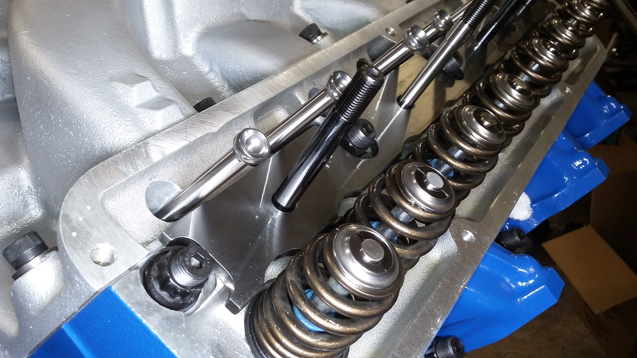

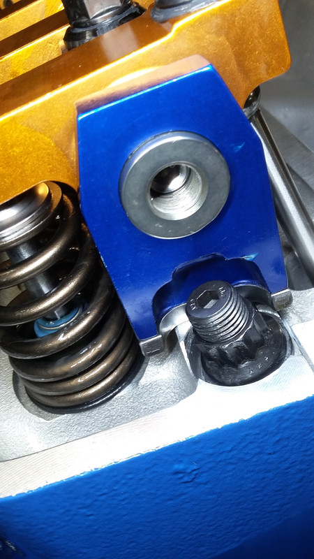

No problem, Mike. I didn't go fancy on those shims. I figured if the stands were aluminum, even a strong grade, then mild steel should suffice. I just went to my local store and got some 1/4" thick flat stock. I bolted the rocker stands down and took an overall measurement and cut to length. Then I measured for bolt hole locations and drilled them out. Then I marked where the head studs would interfere and marked locations to notch for valvesprings. I did trace the inside of the end stands to clearance for the head studs. Then I made sure I trued the faces and got my desired thickness.
These pics are of iteration 1 of this build(RIP)
