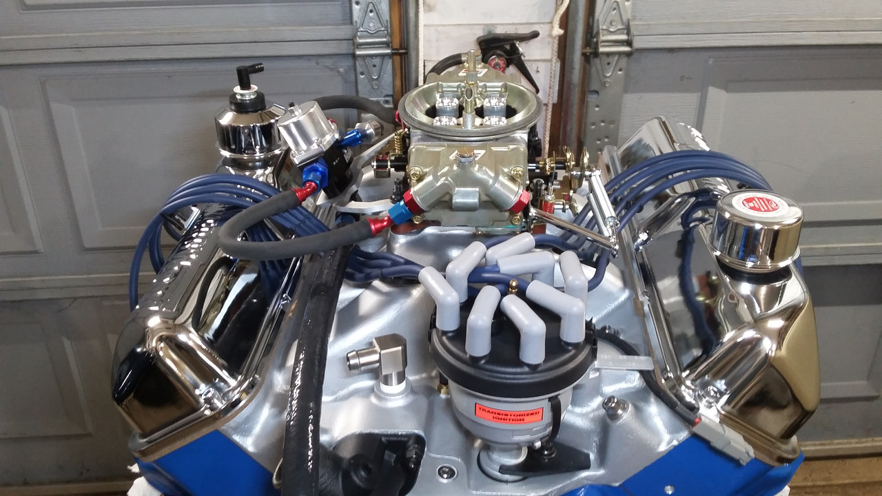

Forgot a shot of the rockers and the whole engine:

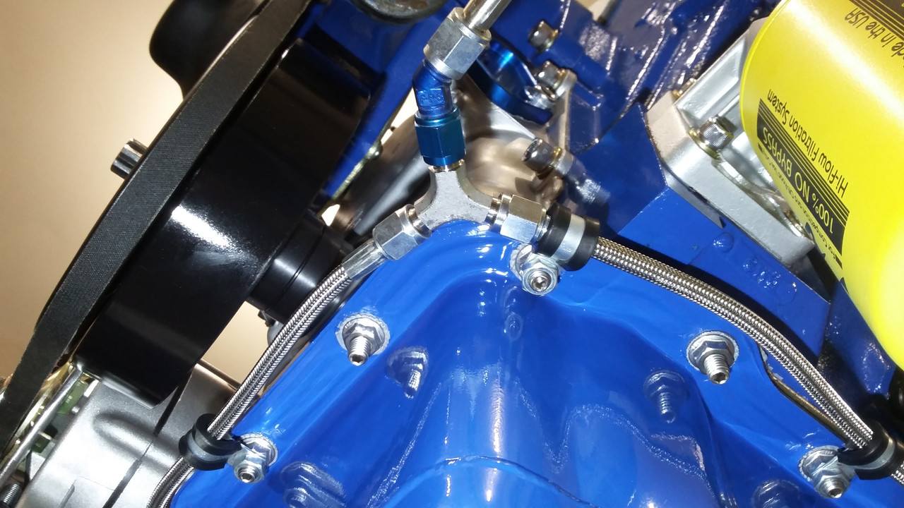

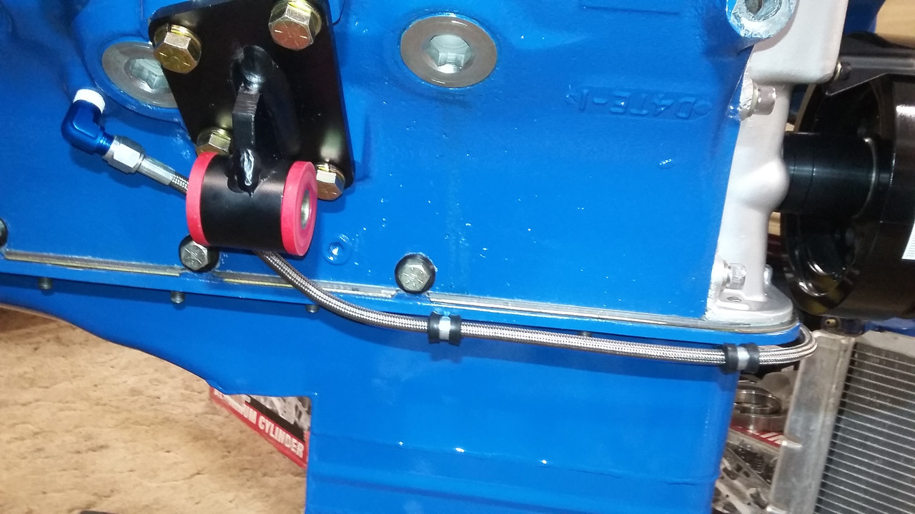

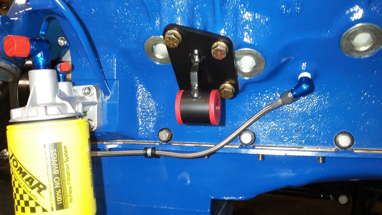

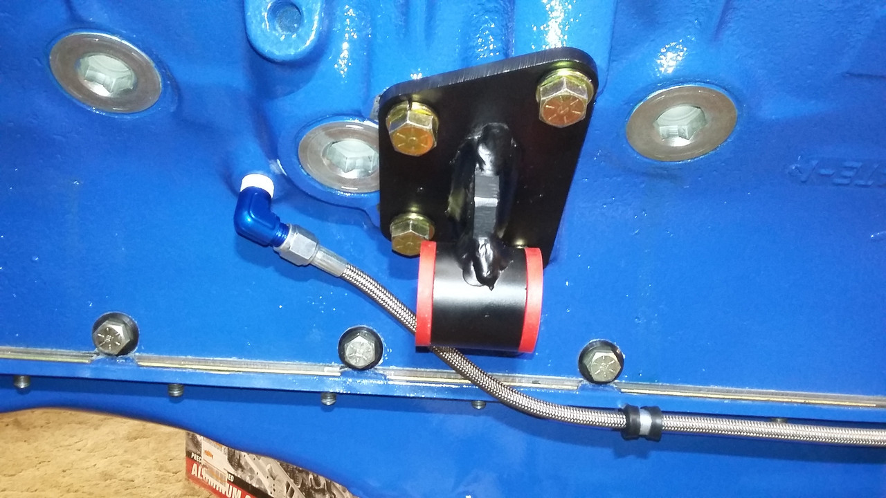

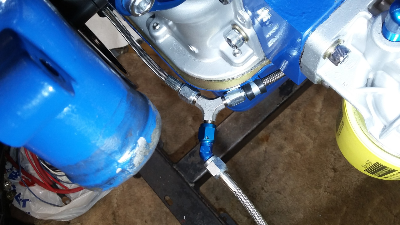

Couple of last minute mockup things. I decided to try a different approach to my coolant drain setup. I am going to tie both the block drains into a tee with the radiator, so I can drain it all at once and from a convenient place. I also picked up some 3/8" valve cover spacers so I can clear my custom rocker stands without modifying the baffles. Since everything has been milled, I needed to elongate a few of the holes so the spacers and valve covers would line up.

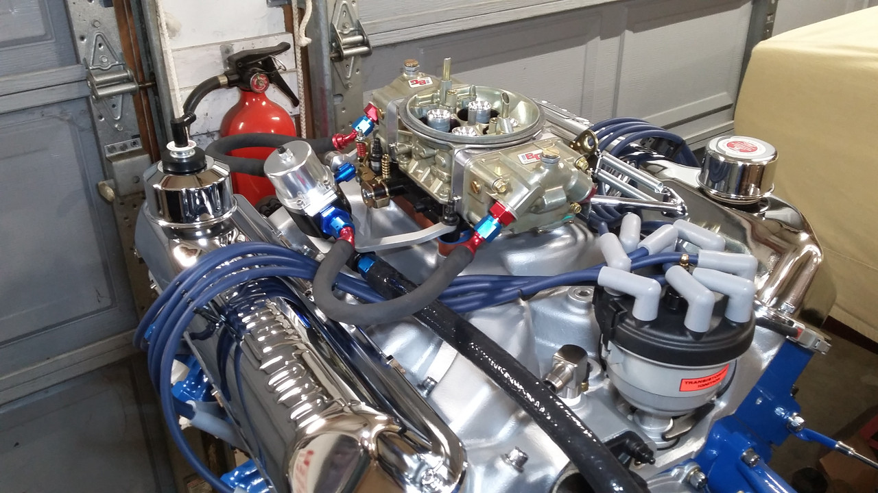

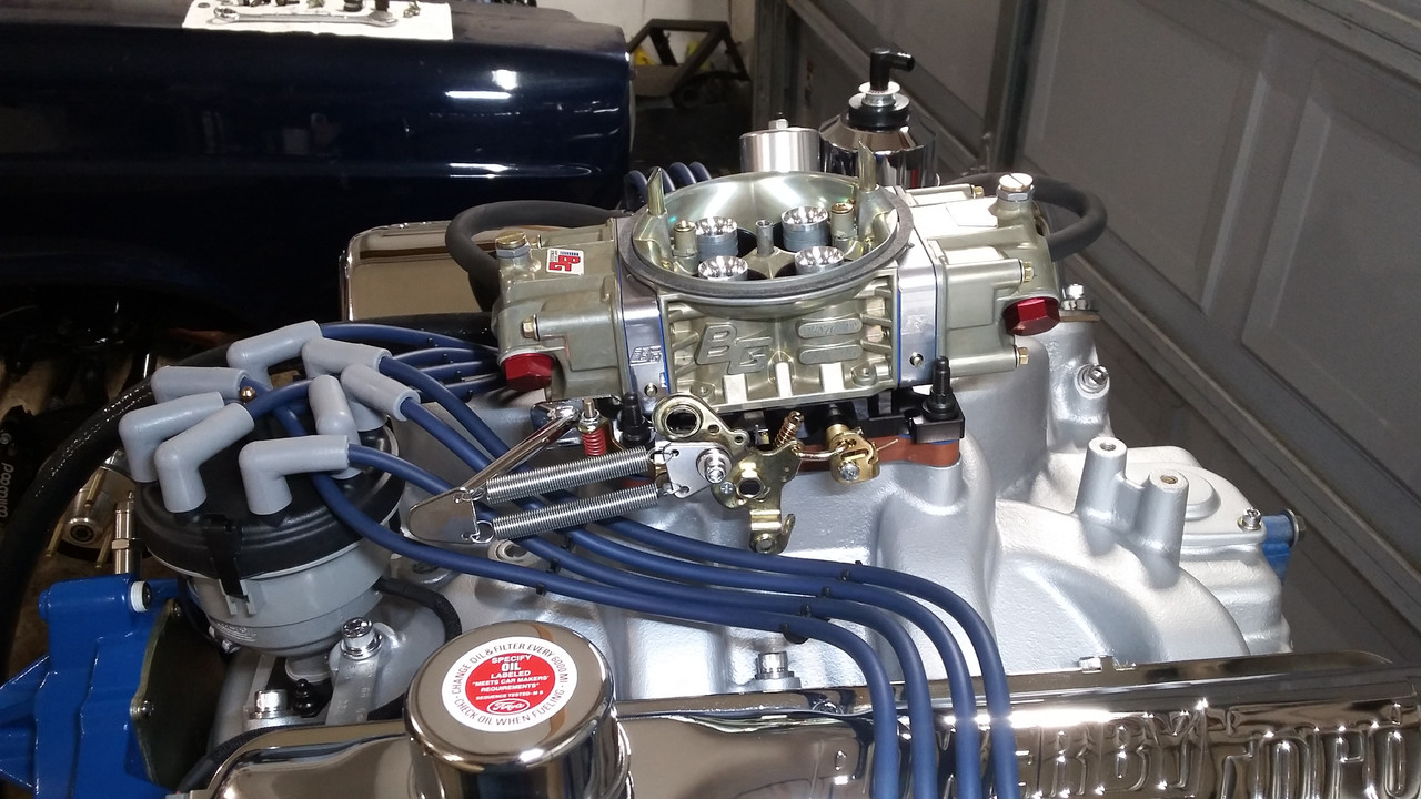

Not a lot of spare time lately, but got a few minor things done. Got the new Moroso Ultra 40 wires on and removed the lettering and added smooth boots at distributor cap. Took a chance and bought the FAST distributor cap. It was black with brass terminals as I was hoping. Finished mockup of the new fuel system. Mounted the Barry Grant 820cfm with Holley big billet regulator and -6 lines and -8 insulated feed.

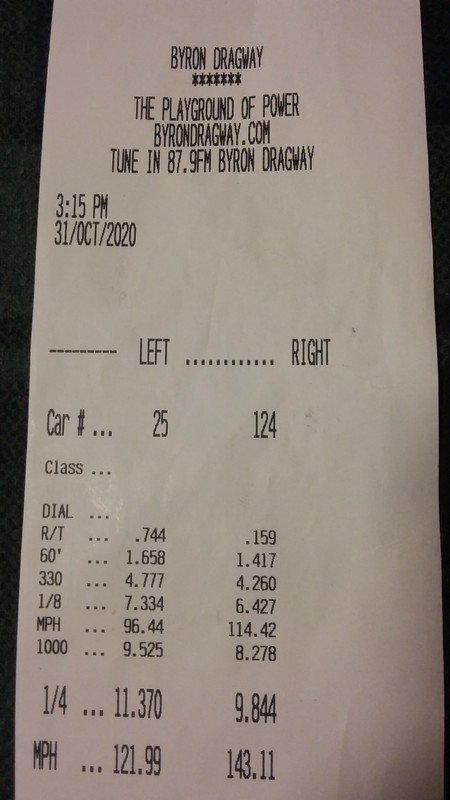

Thought I would dust off this old thread with a minor update. Engine has been in the car for a few months, I have had it running and driving for a couple. Engine now has a little over 300 miles and all seems well. I have finally after waiting almost a month, made it to the track for the first time. Car has been down for 4 years for "maintenance". The weather has not been cooperating lately with freezing temps and rain. Yesterday was my last ditch effort, I thought to make it down the track before it closes for the year.
I drove the car to the track(about 45mins.) starting out below 40° and on the slicks. Temp did make it to mid 50's by end of day. We got there, got tech'd in, and found a place to park. I checked a couple things like timing, tire press., and rear shock settings. I go up and make my first run. Felt okay, but spun off the line. Get my time slip and head back to the pits. It ran 11.47 @ 122.00. I get back to the pits and surprised to run into a couple FE forum members with their cars. I made a couple more passes, but didn't improve any(slowed a tenth or two) due to lack of traction. This whole time at the track we are fighting at least 20-25mph straight headwind coming up the track. I should also mention it was a diesel drag event and a lot of people on street tires not helping the starting line(another excuse). So, right when I go to make my last(5th) pass for the day, they throw some fresh prep down on the line. I tried launching anywhere from 4000-5500 before. I tried 4500 one last time. It tried to hook, but broke loose just a tad. I made my best pass for the day. 11.37 @ 121.99 w/ a 1.65 60'. My 60' times were all over before from 1.79-1.91(no hooky). I air'd the tires back up and headed home. All in all, had a good time and was great to talk with a couple fellow members. Nothing broke and car felt strong, so that was a plus. I have a pic of the last time slip. You can see there is much room for improvement, mostly in the short track. And yes, I was making a sandwich as the light changed. I am also a sucker for punishment shifting through an old Hurst competition plus. The car weighs right at 3650 with me in it. With the strong head wind, I feel there is another 1-2mph left in it. I will be satisfied when I see a 10 sec slip. Baby steps....
