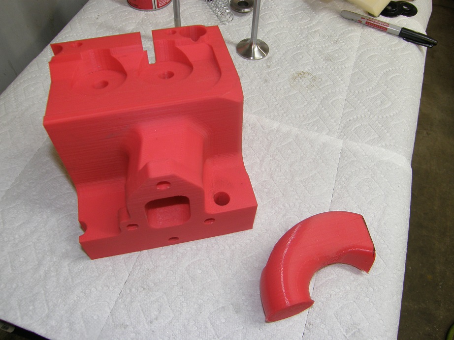

By the way, you guys may be interested to know that my arm has been twisted by a few notable FE folks, and so I'm pretty sure that I'll be doing a version of these heads with the stock FE exhaust port location.  First pass design on that is complete and I've 3D printed  what one port will look like:
With the flexibility offered by 3D printing the sand, it won't cost me any more to make this version of the head, except for the design time.  And I'm sure you've noticed that I have lots of spare time on my hands  ::)  I'll get 'er done, though.  I've got a couple cars that I don't want to cut the shock towers on, and it would be great to be able to run these heads on those cars.
Isn't the head considerably taller than a standard head, even taller than a HR head? Wouldn't that put the port exit right up against the shock tower? I don't know the specifics about the dimensions of the head, but if that's the case, I don't even see how you could get a header tube on the port. Or at the very least the tube would have to be at such a drastic angle that flow would be severely compromised. Just guessing on this...
Re: FE Power Cylinder Heads
« Reply #158 on: March 19, 2019, 07:47:55 PM »
The head is very tall, but the exhaust port on the plastic head is in the stock location, so any exhaust that fits in a shock tower car should fit.

Going back to the piston profile,  will that be something you will be getting involved with or will this be left up to the builder to supply the combustion chamber and valve angle specks to the piston manufacturer?
I'll be providing the chamber info to CP so that they have the information necessary to build the correct piston for my heads.  Maybe Diamond also, but I have an existing relationship with CP so they will get it first.  In fact I hope to be ordering pistons for my dyno mule by the end of the week.  I'm going to have them designed so that they will work with either standard FE heads, or my heads.  That way I can do a head comparison test on the dyno.  Another thing I'm really looking forward to...

Looks to me like Jay's stock exhaust port would make the existing headers work better since the port is already dumping downward and not straight outward. Kinda like a Pontiac head. Looks like a good design.
« Reply #163 on: March 20, 2019, 07:44:17 AM »
That was the idea behind the port design, Tom, you hit the nail on the head there.  The really bad tubes on a header for a shock tower car are the ones that come straight down, so hopefully the port design will smooth the flow out into those tubes.
Makes you wonder why they haven't used that port design on all the other aftermarket heads.
I am curious, on the originally designed port, why you didn't go with a D shaped port? That seems to be the 'go-to' design on nearly all performance aftermarket heads. Is it because the port turn radius isn't short enough to benefit from it?
