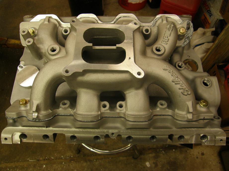

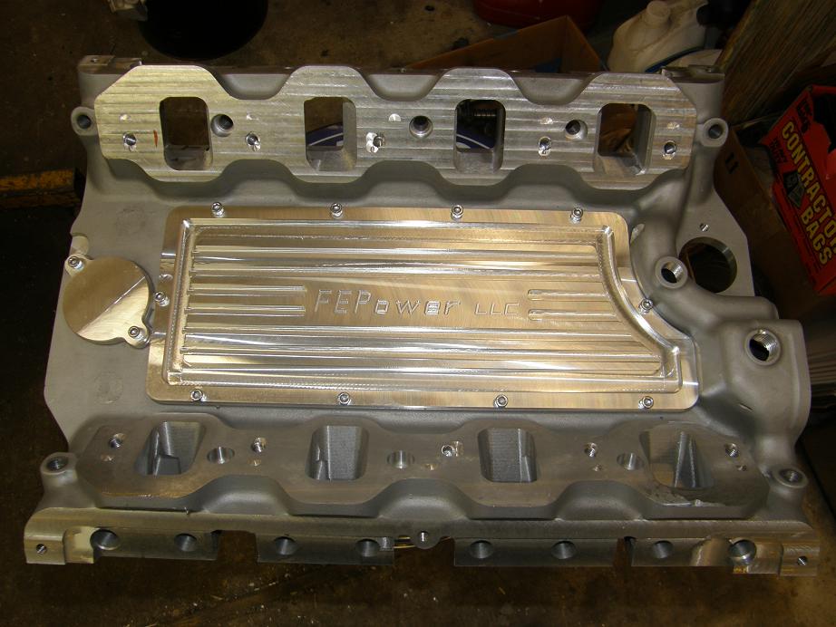

At that point I needed a break from all this stuff, so I decided to start working on the access plate that covers the center hole of the manifold.  I figured cranking out that program would be a 2-3 hour job.  Unfortunately, it turned into a two day job, and I just got it finished up late last night.  But the access cover and road draft tube hole cover that I built look pretty good; here they are bolted onto the first prototype intake:

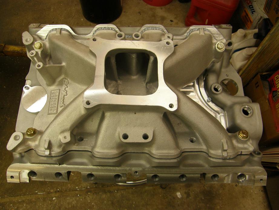

The picture doesn't really do them justice; they are nice looking billet aluminum pieces.  I put the company logo in the middle of the access cover so that viewing the manifold by itself, it is visible, but when a 351C manifold is put on top, it is hidden.  Here are some photos of the Torker, Weiand tunnel ram, and Performer RPM intakes bolted on with the access cover in place:

What seals the draft tube cover and the cover plate?
Re: FE Intake Adapter
« Reply #212 on: July 07, 2013, 01:08:51 PM »
A big O-ring will seal the large access cover.  I'm debating on whether I should also do that for the road draft tube cover, but if I do it might make sealing an actual road draft tube or breather a little dicey.  I think I will be machining one of my prototype manifolds for an O-ring in this location and see how it works out...

It's looking really nice. That tunnel ram looks beautiful on there. Like it was specifically made for this application.  I always thought FEs and Clevelands looked amazingly good with the open bottom tunnel rams. Coupled with the flathead, the 3 best looking engines Ford ever mass produced.
I think I would take a sawz-all to the center of that RPM though if I did it. It would look better and remove a couple more unneeded pounds, almost making it look like a dual plane tunnel wedge.
I'm not a huge fan of engines sticking out of the hood, but dang that tunnel ram looks sweet. I could easily see that sitting between the fenders of my '55.

I think every 351C intake will have to be modified to fit.  The good news is that it isn't too tough, and you could easily do it yourself with a hacksaw and/or a die grinder.  The issue is that the front rail of the 351C intake, that goes against the front rail of the 351C block, is in the way of the water jacket passage for the intake adapter.  So it has to be cut out of there.  You can modify the 351C intake yourself (which a lot of people have done over the years with the PSE intakes), or you can send it to me and I'll do it on the mill, probably for $75 or so.  Haven't figured the time/price out yet...
