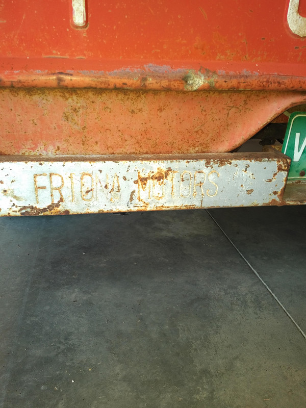

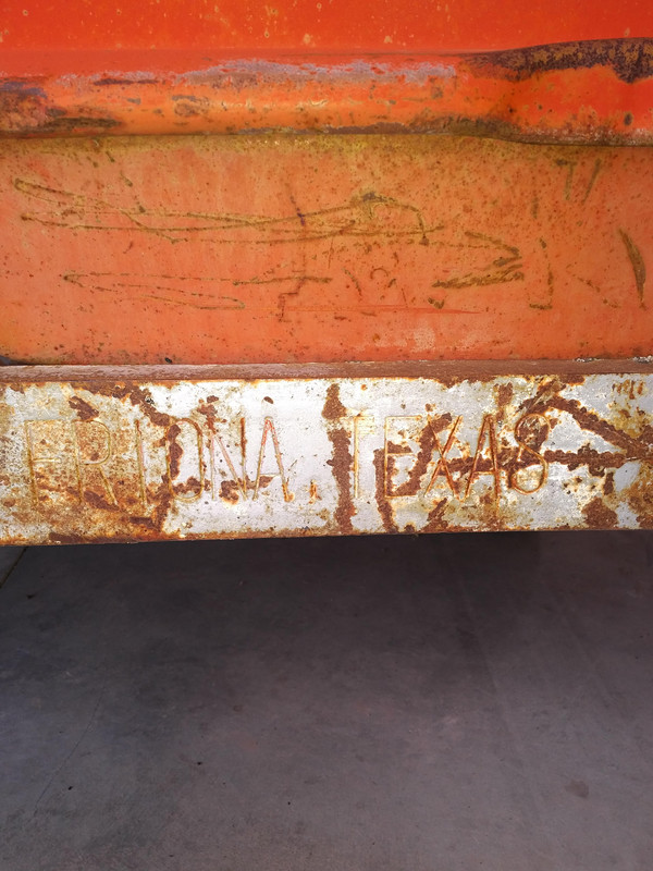

This truck has been sitting in dads sagebrush for at least 10 years. He found it in a news paper ad I think. It's been around Western Colorado for a while. I found a local phone book under the seat from 1972. I also found a personal check under the seat from a bank in Pasadena TX. I'm guessing the trucks original owner might have stashed it there. It was folded in half and tucked into the springs on the drivers side. Kinda cool I thought.
Hey check out the rear bumper. I don't know if the dealer had to install the bumper or if it happened at the assembly plant. But it looks pretty cool. And it has steps on the corners. I just saw a Chevy truck commercial advertising the same feature. Took em a while figure that one out. :)

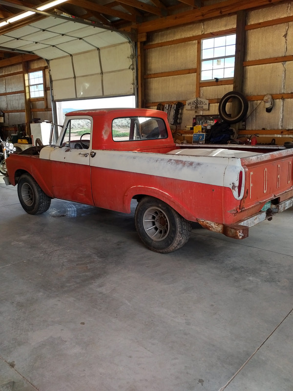

The body isn't going to change much. I don't have a pic of the passenger side but it's had some serious southern exposure to the sun. Dad keeps saying, "just look at the patina on this thing!" Lol  We might just shoot a flat clear on it and call it good. It also had some serious rust issues in the floorboards and cab mounts. More pics later.

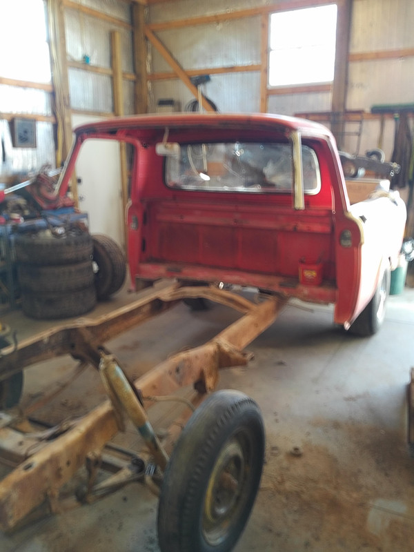

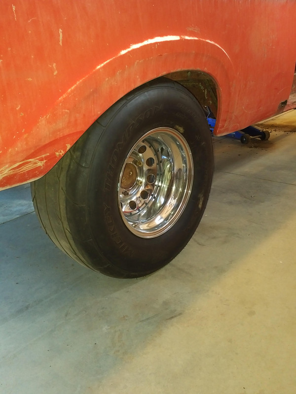

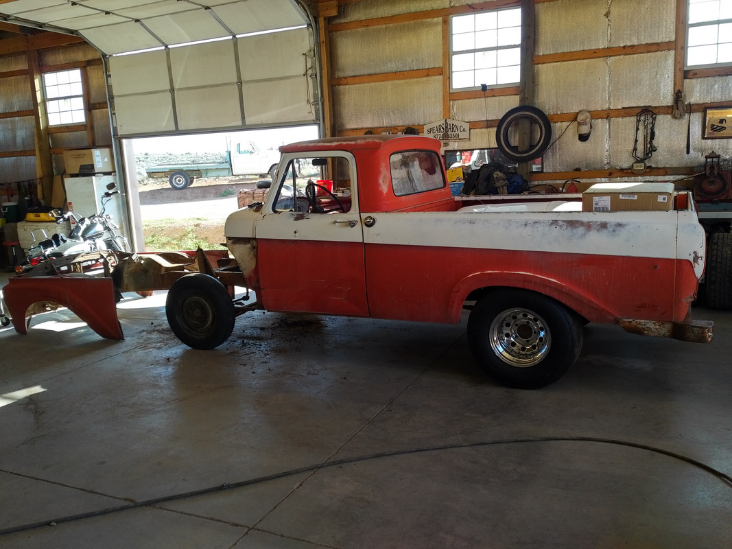

We swapped tires to get the truck looking right. Kinda set the mood for the project you know? I found a nice pair of M/T drag radials to try out. I've read several stories of rear bumpers tripping the 60' beams with these tires. This would be a fun issue to sort out I think. Lol They barely clear the inside lip of the fender with 10" wheels. We may roll the inside lip up to clear. We don't want to radius around the rear tires if possible.  Keeping the swooped back tin looks better.
We also pulled the front clip to make things more accessible. It had a blown up 250 straight six with a 3 speed. #6 Rod was hanging out of the block. It all came out in one chunk.
The steering column and sector all came out in one chunk too. The sector would have been right in the way of the headers. We've got a plan for a different sector.

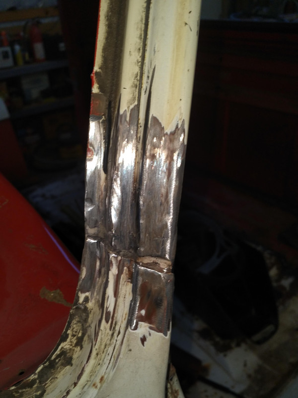

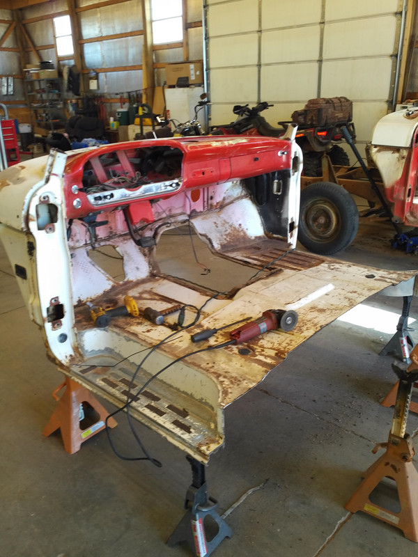

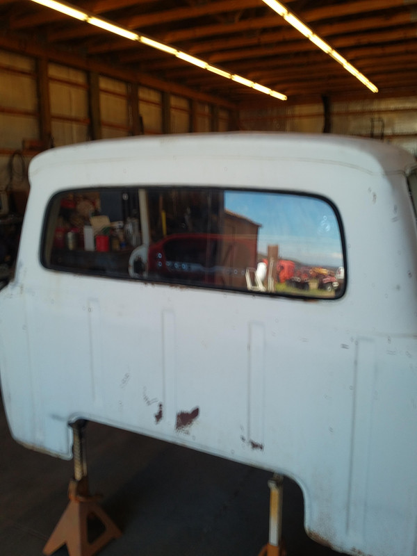

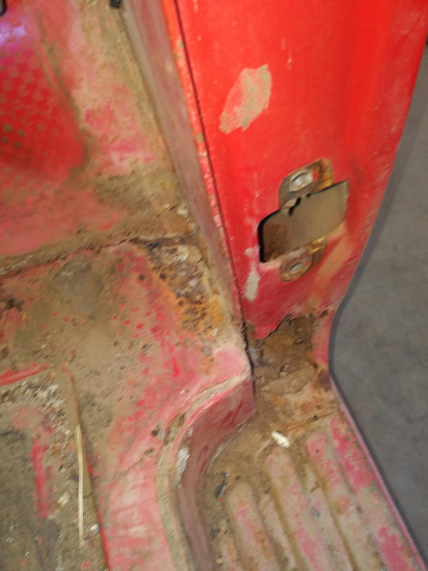

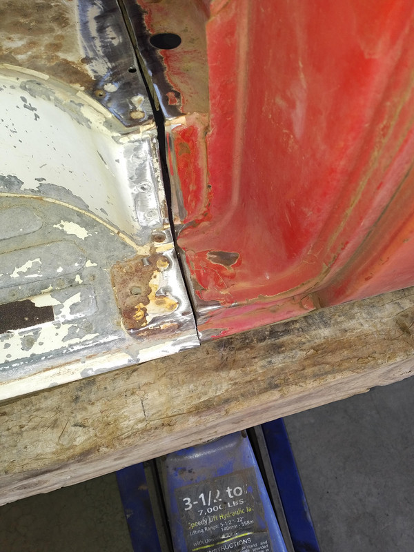

We scratched our heads for a while on the rust issues. The front cab mounts were completely rotted. The bottom of the hinge pillars had huge holes rusted thru. The floor of cab was just as bad. The Trans tunnel had been butchered to make way for a NP435 also. What we ended up doing is using the floor and firewall out of a '64 3/4 ton Camper Special. This also gave us a taller tranny tunnel with a removable cover. It has some rust too but it's way better than what we had. Check out the 3rd pic down...this is how much the cab fell when we cut the posts.

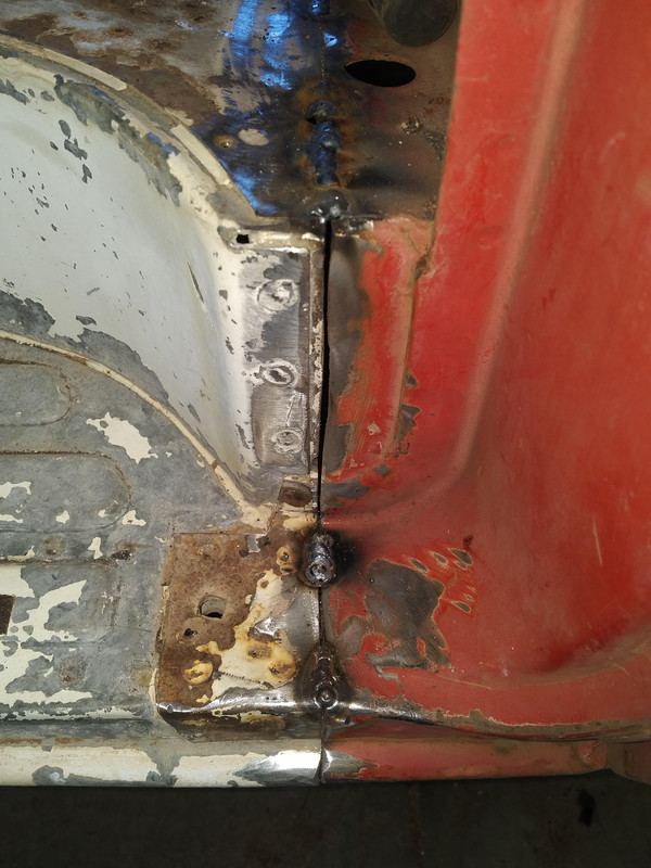

« Reply #6 on: September 30, 2017, 10:25:47 AM »
We spent quite a bit of time measuring and fitting. I've got a ton of welding to do still but this is about where the project sits at the moment. With plenty of thick tin to deal with, welding should be fairly straightforward. I can't imagine doing this with today's paper thin sheet metal.

Hi I have three of these trucks they are prone to rust, the body mounts and were the floor of the box meets the side panel behind the doors, what front suspension are you going to run  I bought my first one in 1969 I think and still have it, raced it a lot with a 1968 PI 428 it ran great  you will have fun with it I did. Leny Mason

Leny- Yep lots of weird places for dirt and moisture to settle in these cabs. The passenger side cab corner is rusted just like you're talking about. It would have been so easy for Ford to put some clean out holes in these nooks and crannys to prevent these rust spots.
