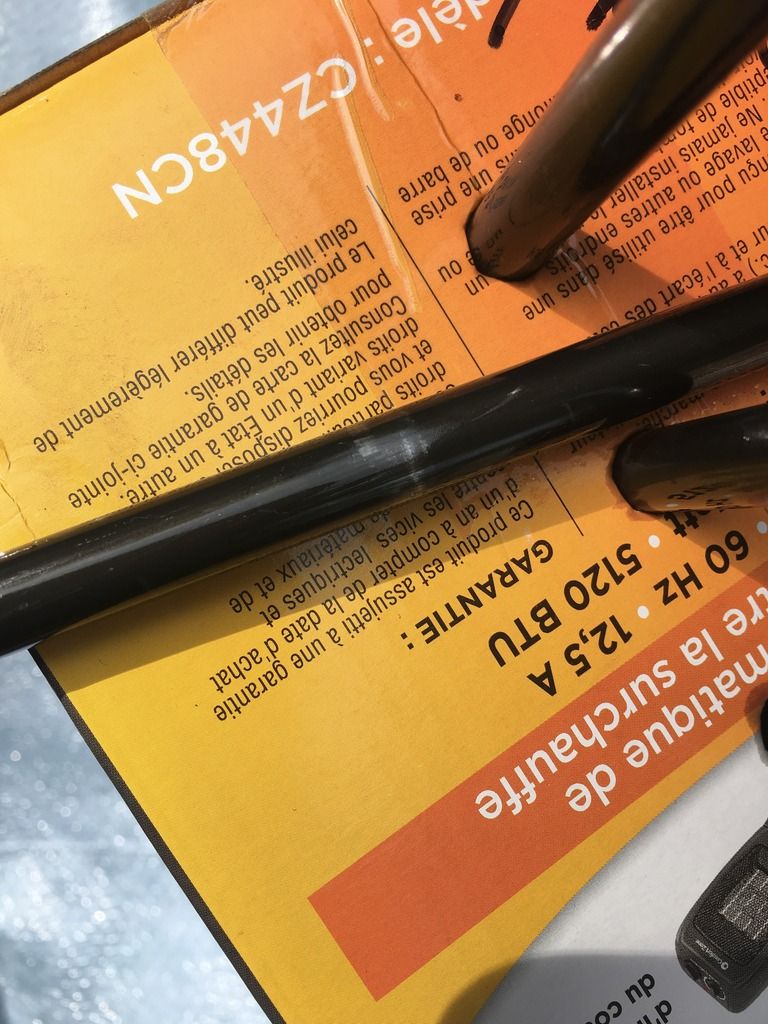

I did see a few witness marks on the pushrods, this is the worst - since I've never looked at pushrods that have been run I don't really know what to expect. You can see two parallel marks about 1/3 from the left of the visible rod.
Paul.
That rub looks pretty insignificant. I wouldn't fret about it unless you see it start getting much worse.

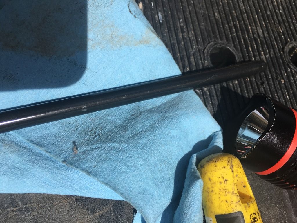

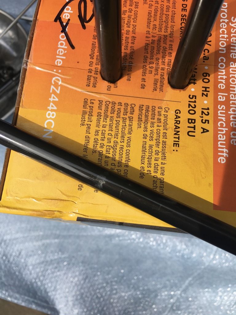

Having said that I found two of the pushrods had worse witness marks than the other side had.

That's not a rub worth worrying about.  I have had engines with a clearly visible 1/16 inch of clearance show rubs like that.  Asked Kaase about that stuff once and he told me that a light rub was fine - calms things down when they vibrate.  Most non-FE engines rub the pushrods on purpose - guide plates...
I am with Barry, we build to not rub, but if the rub doesn't bind the play of rocker it's just acting like a guide plate.  460s, small blocks, Chebby's run all day long with built in contact
The second picture in this last pair looks a little odd, almost like damage or a pinch not rubbing, but I assume it's the camera

You are right, it is the camera. Hard to get a picture of a curved surface, especially in direct sunlight.
