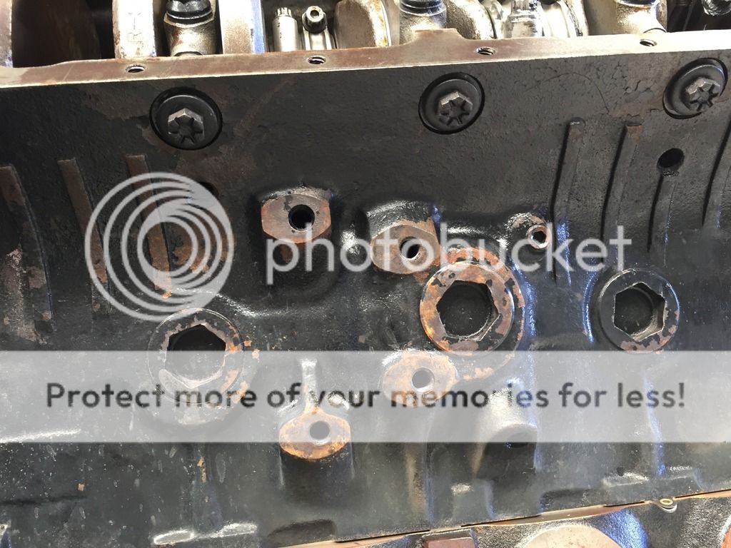

The rods are supposed to be Manley, but from what I can see so far, they have a big black cat on the beams, so not sure if that makes them CAT rods. Also, I haven't seen the brass screws in the centre of the main caps before, not sure what they are about.

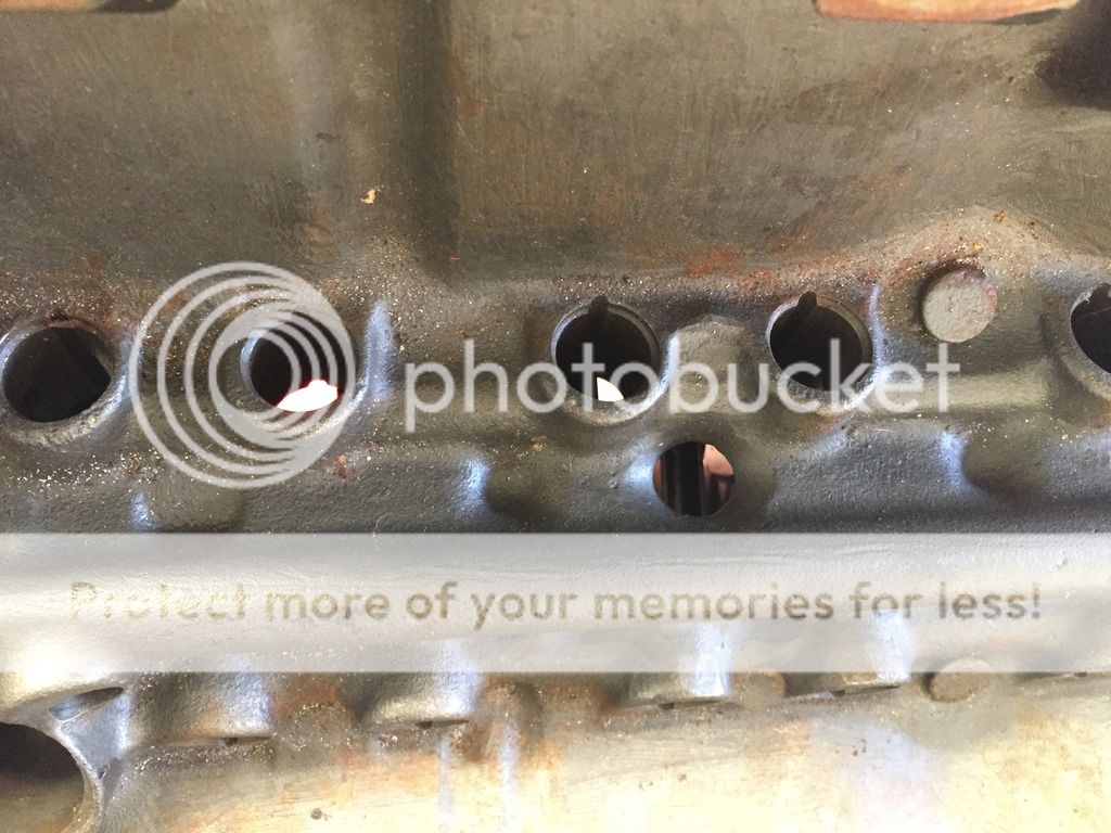

Another interesting thing about the block is that the lifter bores have keyway slots in them.

Looks pretty cool! Since the block is a 72 maybe it is one of the "P" blocks? Check the back by the bell flange.
Maybe the brass plug deal is blocking off an old PSE main "additional" oiling kit (don't remember what he called it)?

That block has had some mods made to it. I have a "P" block in my 56 F100 and I know the drain back casting is there but its not drilled. The keyways are a mod to get more oil to the cam and lifters. Crower makes lifters with a flat on one side machined on them , that does the same oil mod. What the brass plugs are on the main caps is a good question, I would be  questioning the strength of them if they are drilled all the way through. Still a good score though.

I think those machined keyways in the lifter bores served a different purpose: anti-rotation of similarly keyed roller lifters. Why? The machined keyways are way too deep IMHO to have been used to increase oil flow alone.
As to the brass screws, I agree it was likely the add-on main cap oiling system as noted. I'd not worry about strength either since many aftermarket blocks have similar drilled and tapped main cap bosses, thus allowing a builder to use a screw-in long bolt of small slide hammer to remove tight main caps.
