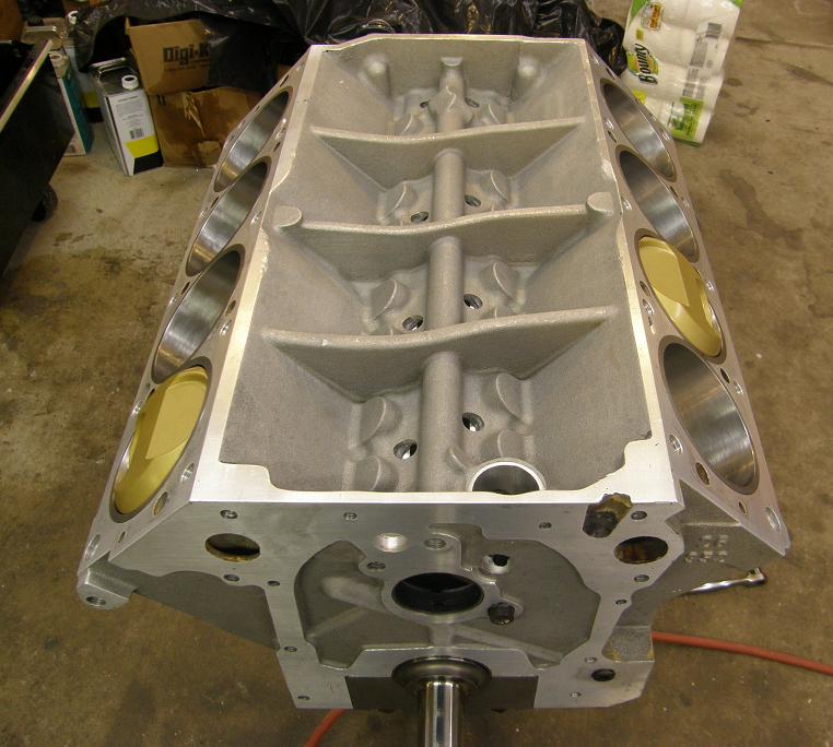

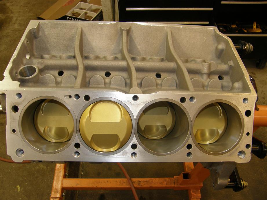

Got the rest of the pistons installed tonight:
After torquing the rod bolts I tried Kirk's test for drag of the reciprocating assembly.  Allowing for about 2 lb-ft of torque that my wrench is reading low, it took 22 lb-ft of torque to rotate the reciprocating assembly.  Not as good as a stock eliminator engine, but not bad for a 519" motor with a 4.285" bore.

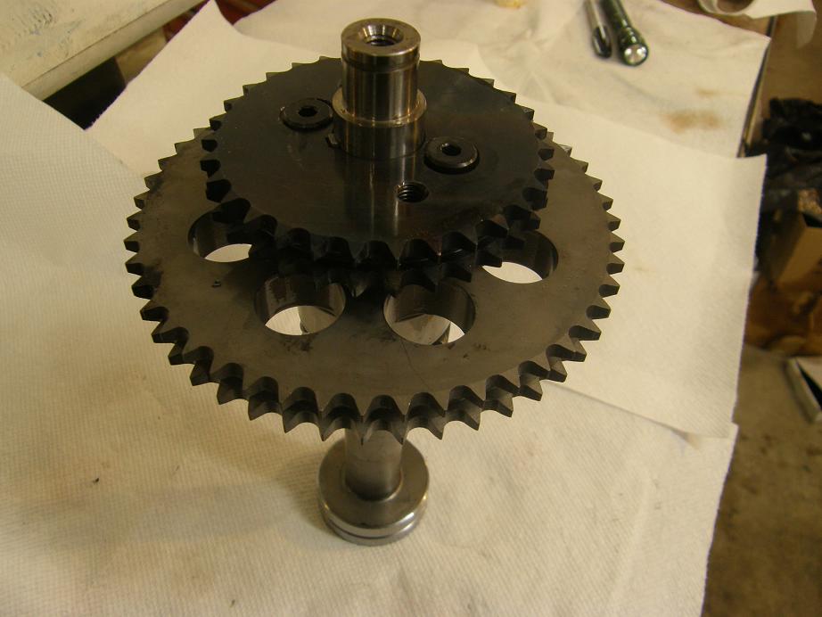

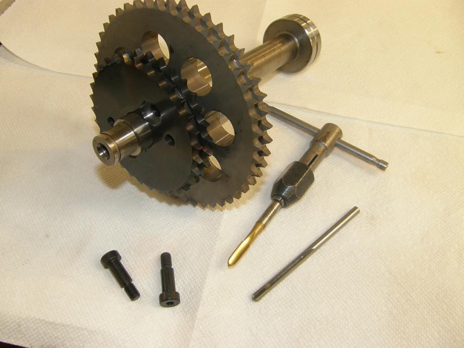

My carbide drill and heavy duty tap came yesterday, and together made short work of the holes in the big timing gear.  Here are some photos showing the tools and the special bolts I use to pin the gears together, the stub cam assembly with the bolts installed, and the primary timing chain and stub cam installed in the engine:
