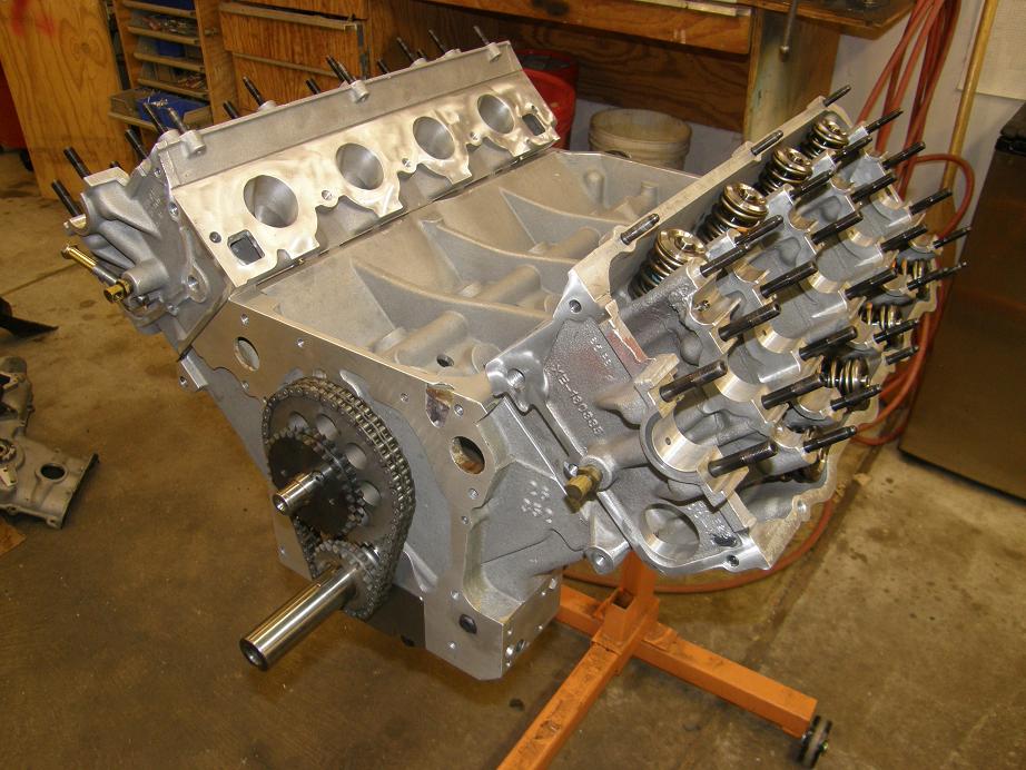

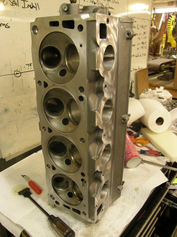

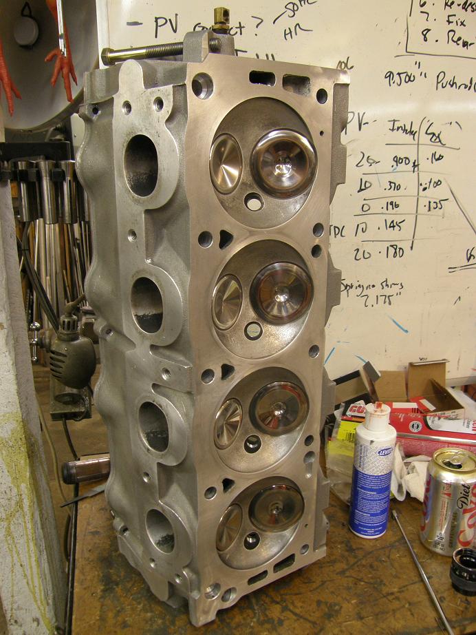

More progress today on getting my 519" SOHC together.  This morning I got the heads cleaned up and then spent the afternoon checking the valvesprings, setting the spring height, and then installing the valves, springs, locks, and valve seals.  Here's a photo of one of the bare heads, and then a couple of photos of it after it has been completely assembled:

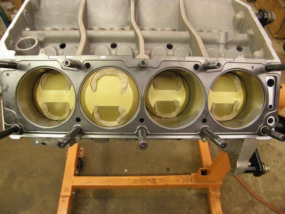

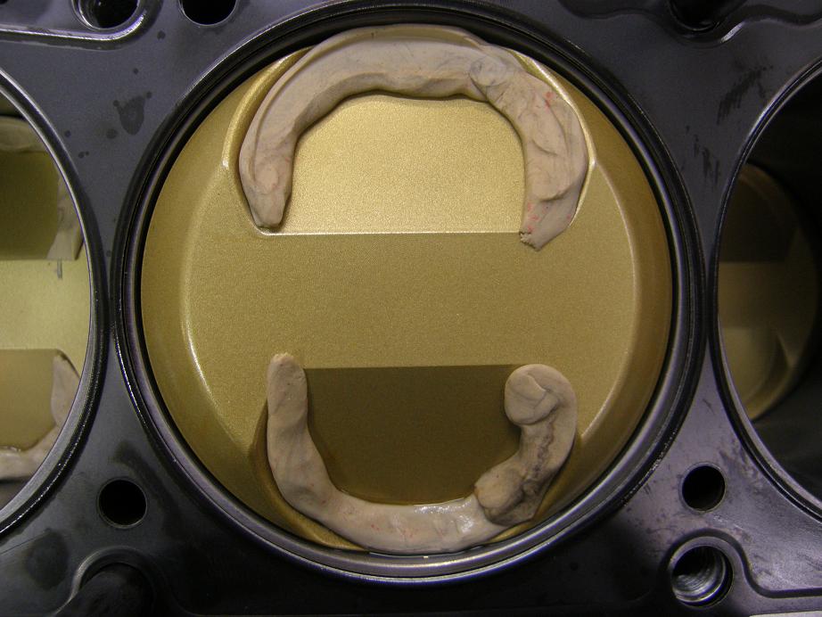

Once both the heads were finished up, I installed the studs in the block and then installed the heads temporarily.  I want to check piston to valve clearance in each cylinder, so I put clay on 7 of the 8 pistons before putting the heads on the block.  Here's a photo of the pistons with the clay on them, and then another photo of the engine assembled with the heads in place:
Next I had to put together the chain drive so I could roll the engine over and get impressions in all the pieces of clay.  This engine originally had the factory style .222" chain, which is a non-roller chain setup, and I had earlier decided to transition to Paul Munro's chain drive setup.  This meant that I had to change out the gears on the tensioner arm and the fuel pump gear stand.  This was pretty straightforward on the fuel pump gear stand, but when I got to the tensioner arm, Munro's gear wouldn't fit.  The tensioner arm I had on this engine was an aftermarket unit I got from Doug at Precision Oil Pumps, and it just wasn't wide enough to take the Munro gear.  Fortunately I have a spare stock tensioner arm, and a quick check showed that Munro's gear fit fine on the stock piece.  So, I pressed out the pin, removed the old gear and bearing, and installed Munro's gear with a new bearing.

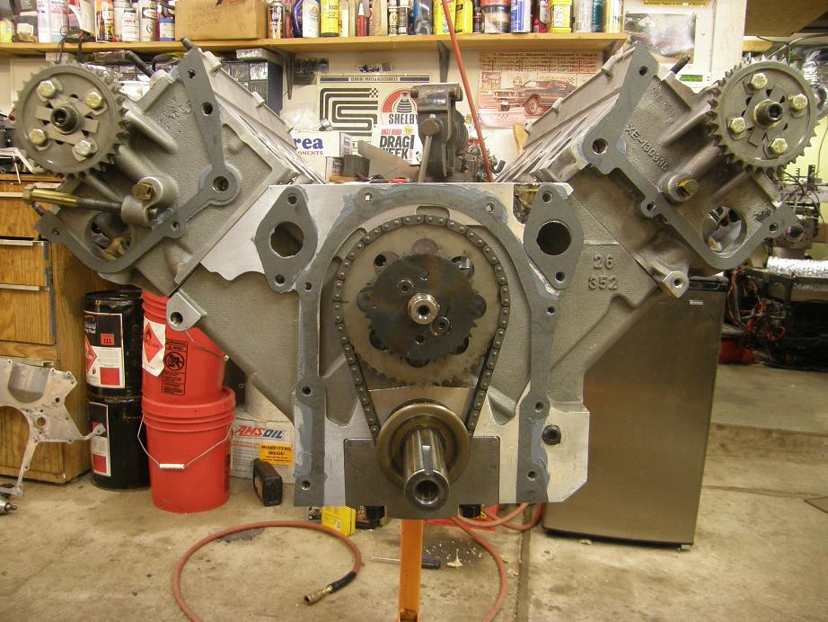

From there I took some time to clean up the backing plate that goes behind the timing cover; this has to be in place before the tensioner arm and fuel pump gear are installed, otherwise the gears won't line up correctly with the secondary drive gear on the stub cam.  Once the backing plate was installed I put it in place on the engine and then installed the two gears.  Next I found the cams I want to use on this engine, which are actually the same cams that I ran on my 585" motor last year, and after lubing the bearings installed them in the heads, tightening the first cam cap to hold them in position.

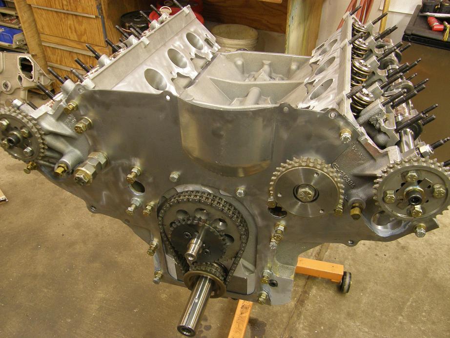

Now it was time to put the chain on, and the Ford chains had three colored links, red, white, and blue, that lined up with the dots on the two cam gears and the dot on the secondary chain drive gear.  Munro's chain didn't have the markings on it, and few of the aftermarket chains do, so I took some paint markers (black, white, and yellow were on hand) and marked the chains in the correct spots.  In case anyone is interested in how far apart these marks are on the chain, you can randomly mark the first link to go to the left cam sprocket, then move 58 links to the left and mark that link to go on the secondary drive sprocket on the dot, and then move 64 more links to the left on the chain and mark that link to go on the right cam sprocket on the dot.  Here's a photo of the chain loosely installed on the engine:

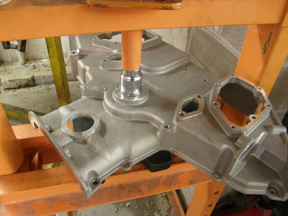

Before you tighten the chain you have to install the front cover.  The reason is that if you don't, you will deflect the nose of the stub cam with the chain tension, potentially leading to an inaccurate timing reading or damaging the stub cam (especially if it is a cast iron stub cam, rather than a steel one).  The nose of the stub cam is fixed by a bearing in the front cover.  Mike was asking about this earlier; here's a photo of the bearing just placed on the nose of the stub cam.  You can see the snap ring groove in the stub cam just past the bearing location.  The bearing is pushed back against the step on the stub cam, so once the bearing is pressed into place in the front cover, and the stub cam pokes through the bearing, the snap ring locates the stub cam front to rear.  After the photo of the bearing is another photo showing the bearing being pushed into the Pond front cover:
Once the bearing was in place I installed the front cover on the engine with a few bolts, and then tightened up the chain before I called it a night.  Tomorrow I will find top dead center, time the cams, and then install all the rockers so I can roll the engine over a few times, and also check piston to valve clearance.  Then I'll pull it back apart and look at everything; hopefully I'll have plenty of clearance and I can assemble the engine for good after that.  I'll try to post a few more photos and details about this whole procedure tomorrow.

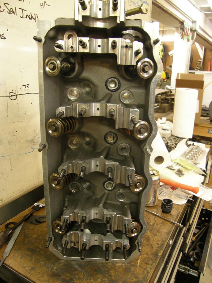

With the chain and front cover installed, I continued on mocking up the engine by installing the valve train.  First thing I did was loosen all the rocker arm adjusters and back them way off; I like to do this on these engines because you have to turn the engine over several times when you are going through the cam timing procedure, and if the timing is off by a significant amount you could run into piston to valve clearance problems if you were opening the valves all the way.  After backing off the adjusters I installed the rocker shafts and rocker arms into the heads, and then put the caps on the heads to hold everything in place.  Here's a photo of the engine at this point:
Notice in this photo that the rocker arms for cylinders 6, 7, and 8 are not over the valves; they are slid to one side on the rocker shaft so that they aren't in contact with the cam lobe, and therefore can't open the valves.  This is how you install the rocker shaft assemblies on these engines.  For the rocker arm and shaft assemblies on the left head, you have to rotate the engine until the rocker arms are on the heels of the cam lobe on cylinder 5, and then install the shafts with the remaining rockers slid out of the way so they aren't contacting the valves.  As you can see in the photo the rocker arms on cylinder 5 can't slide; they are captured by the cam towers on either side.  Rotating the cam so that these rockers are on the heel of their respective lobes, and sliding the other rockers away from the lobes on the shafts, allows you to install the shaft without tightening them down against the force of the valve springs.  So, there's no tension on the rocker shafts when they are installed using this method, as compared to a standard FE, where you have to install the rocker shafts and tighten them down against the valve spring pressure.
The same situation holds true with the right bank, where the rockers on cylinder 4 are captured between two cam towers but the other three rocker pairs are free to slide on the shaft.  After getting the shafts and rockers installed and the caps tightened down, you just turn the engine over a little at a time until one at a time the heel of each cam lobe comes up to the correct position and the associated rocker arm can be slid over into position on the valve; then the rocker arm spacer clip for that rocker is snapped in place over the shaft to hold the rocker in position.  Usually I end up taking two or three complete revolutions of the engine to get all the rocker arms into position.

With the right cam timed I wanted to check piston to valve clearance.  On cylinder 1 I had not put in any clay, but instead had put checker springs on the valves so that I could read piston to valve clearance off a dial indicator.  Worst case piston to valve clearance is around TDC on the overlap portion of the stroke, and is usually around 10 degrees ATDC with the intake valves, and around 10 degrees BTDC on the exhausts.  I started with the intake valve at 20 degrees BTDC, and continued in 5 degree increments checking the clearance with a dial indicator.  I had adjusted the lash on the rocker arms to zero previously, so this was a worst case measurement; valve lash would add to the piston to valve clearance.  I found the minimum clearance at 10 degrees ATDC; it measured 0.078".  At 5* ATDC it was 0.087", and at 15* ATDC it was 0.092".  I try to maintain a minimum of 0.080", so with any valve lash at all I would meet this requirement, so it seemed like I was good to go here.
Moving to the exhaust valve, I had a whole bunch more clearance.  Minimum valve to piston clearance was 0.212" at 10 degrees BTDC.  I was kind of expecting this; the lobe separation angle on these cams is 114, so I'm running them quite a bit advanced, which will decrease piston to valve clearance on the intake and increase the clearance on the exhausts.  In any case, the exhausts had tons of room.
Next I moved to cylinder #6 to dial in the left cam.  I use cylinder #6 because then the markings on the harmonic balancer will be the same as they are for cylinder #1.  I repeated the process there, and after a couple of pin position changes on the cam gear I was able to get the cam dialed in at 110.5* ATDC.
Finally I went all around the engine and set all the valves to zero lash, and then rotated the engine through several revolutions, to get a good impression in the clay of cylinders 2 through 8.  This whole process had taken me most of the day, but now I was really curious about what the clay looked like, so I spent another hour tearing the whole thing down.  Seems like this was a lot of work to go through to just check everything and time the cams, but that's what you have to do with these engines.  The clay held a lot of interest for me because on my 585" SOHC, I had seen piston to valve contact on about five of the cylinders, and none on the other three.  So I clayed everything in hopes of ferreting out any issue with the heads; maybe the valves were not spaced evenly in the heads or something.  But after pulling the heads all seven clayed cylinders looked alike, with the intake valve imprint right in the center of the piston's valve relief.  There was so much exhaust valve clearance that the valves didn't even hit the clay; here's a photo of one cylinder, showing the imprint from the intake valve:
