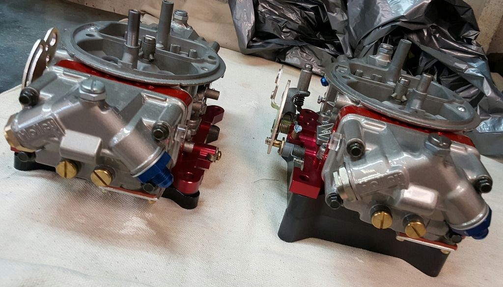

« Reply #77 on: July 17, 2016, 10:02:18 PM »

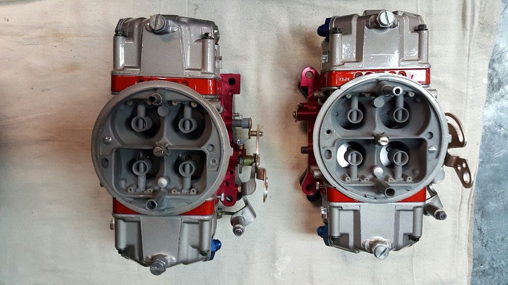

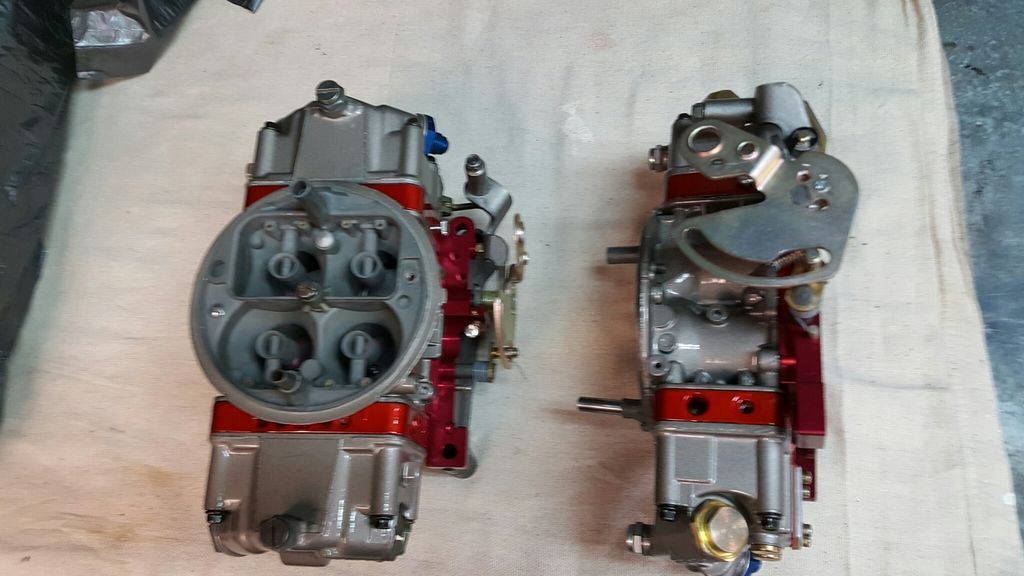

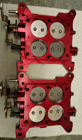

Still waiting on my head gasket. Getting frustrated but can do nothing but wait. Have gotten 3 different "expected delivery" dates. The last got was 7_15_16 yet I still haven't seen it. I was able to get my 660's back together over the weekend though. Thanks to Allstate carbs for there quality billet custom base plates and there over haul kits and hard parts and squirters. There great to work with and have competitive Price's. I'm still a big fan of the 660's for all out racing.

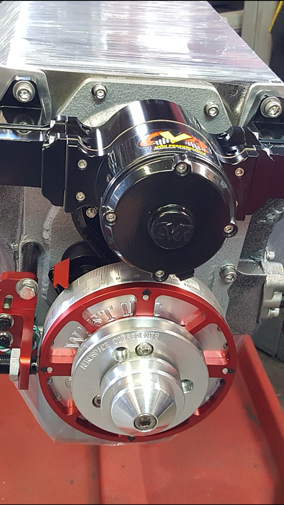

« Reply #78 on: July 17, 2016, 10:08:57 PM »
Also got my vacuum pump and alternator pulleys installed along with my crank trigger wheel and sensor and bracket assembly..
Baby steps...
« Last Edit: March 04, 2018, 08:17:13 PM by fekbmax »

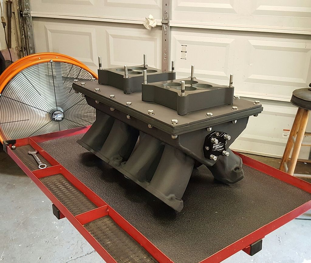

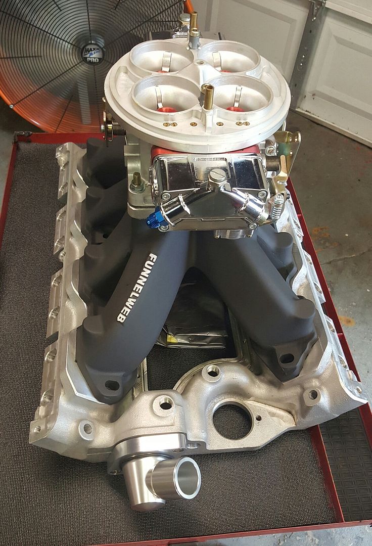

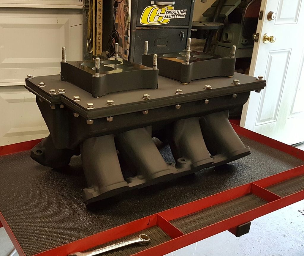

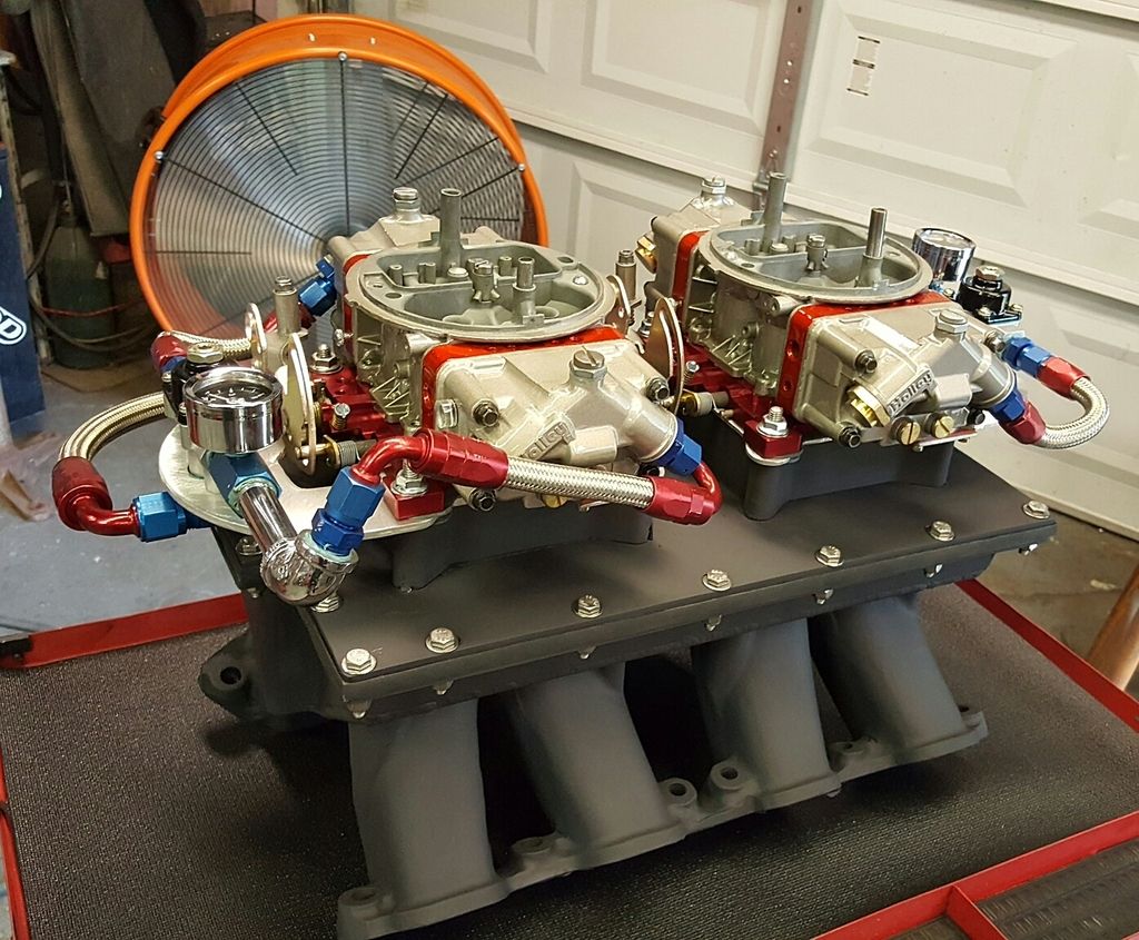

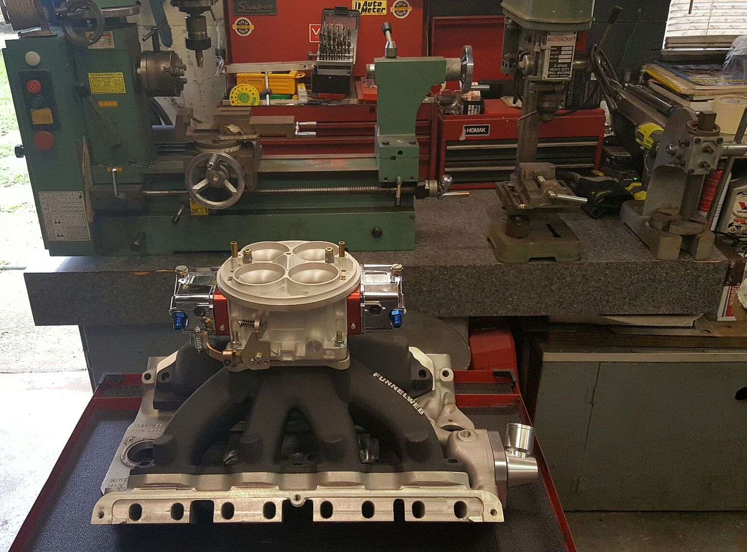

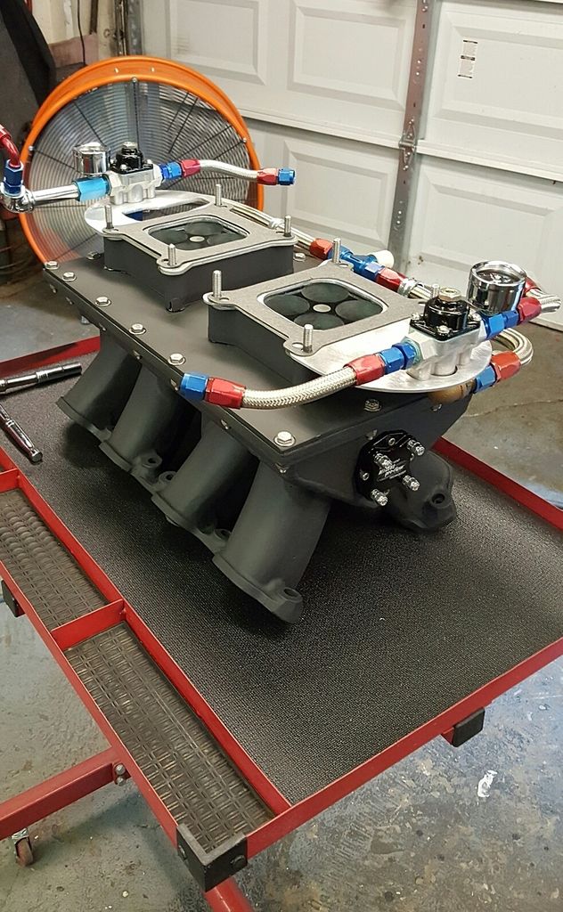

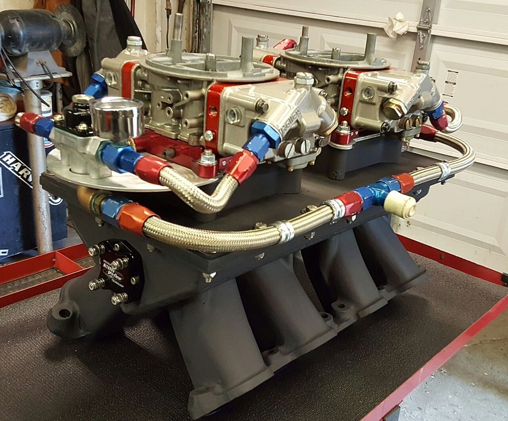

« Reply #83 on: August 14, 2016, 07:48:25 PM »
Home fabricated Hybrid intake and carbs all ready to go on the FE power intake adapter.. :o
FunnelWeb setup also ready
« Last Edit: March 04, 2018, 08:19:46 PM by fekbmax »

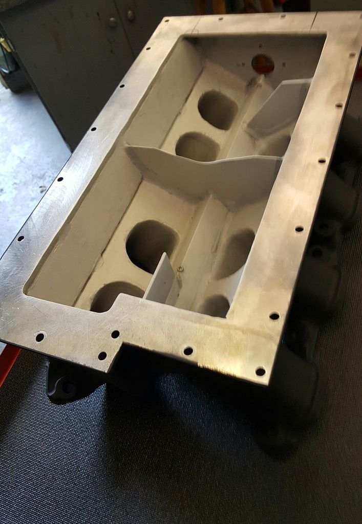

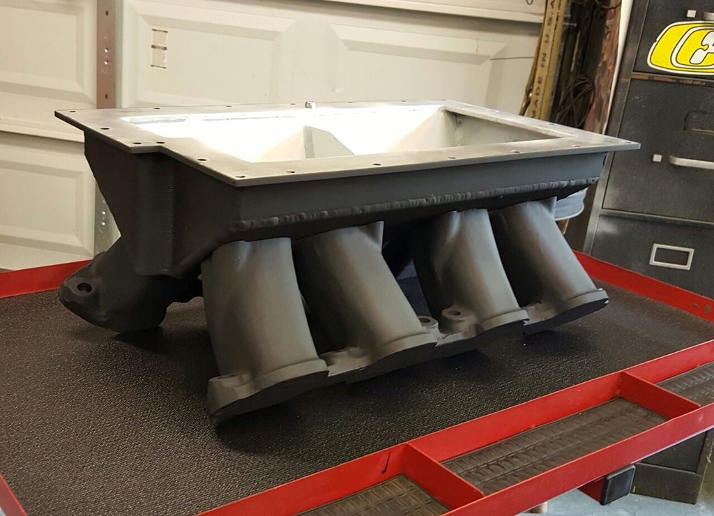

Re: Garden block test mule
« Reply #84 on: August 14, 2016, 08:51:34 PM »
Kool!!! Can't wait to see that installed. :)
« Reply #85 on: August 14, 2016, 09:47:15 PM »
That's a really nice set-up! You do some very nice work, Keith. That intake looks like a nicely designed piece. Is that a pop-off valve on the back of the intake, for backfires?
It looks like you have dividers between 1/5 & 7/8 ports (if I'm looking at it correctly). Is that to minimize port disturbance with sequential firing cylinders? I've thought about that issue before with open plenum intakes. Have you gotten any evidence that it made or makes a difference on your set-up?
« Last Edit: August 14, 2016, 09:52:21 PM by cjshaker »
  • Posts: 1497
« Reply #86 on: August 15, 2016, 12:23:46 PM »
Thanks Doug, I appreciate it. It's all just home brewed old school back yard stuff. The intake runners are cut pro ram runners from a 351C tunnel ram I used on a PSE adapter years back. The plenum I fabbed up and initially made it with to much plenum volume for a little FE and hand ported heads. It looks monstrous on the outside but you can see I did shrink down the plenum volume some on the inside . My hopes are that it works ok with a few more cubic inches now and some awesome flowing Kuntz heads. I know on my old combo that when I went from the 1" open spacers to 1-1/2" 4 hole spacers it picked up from a 6.21 to a 6.03 (1/8th) just with the spacer change. Stronger signal with the 660's and 4 hole spacers must have really helped the intake. That's where I'll start at again knowing that alot has changed and I'll have to most likely make some changes again. The 660's are now a bit more tunable and with the blended Venturi mods and the modified base plate they should be flowing closer to 740 cfm each. The dividers are just as you ex spected, I have no proof (as of yet) that this will or will not help or how much but I have read alot of old school articles about tuning tunnel rams, how those cylinders could potentially Rob the intake charge due to the pulse of the side by side cylinder's and how using the 4 hole spacer will also help because of maintaining a stronger signal. Grumpy's garage has excellent articles and tuning advice for all sorts of tunnel rams.
I guess I'm stuck in old school but for good reason, I don't have a dyno or easy access to one, I can't afford to spend hours and hours on one to gain 5 or 10 hp so I still rely on older method's and try things that I read about and have seen in the past. I know back before the split Dominators were so popular,  i seen several fabricated Intakes with these type of dividers in them. The big inch fords looked alot like what I did and the Chevy's always had there's straight down the middle which makes since due to the Chevy firing order.
Is what I done really worth anything or not?  Idk but I'm hoping at least that it cant really hurt.
Yes, that's a pop off valve, got it from a swap meet several years ago and it fit nicely on the back of the plenum so I installed it. After all, there could be some fogging (BUG SPRAY) action in the future..  :o
« Last Edit: September 12, 2016, 02:31:47 PM by fekbmax »
« Reply #88 on: August 16, 2016, 10:45:51 PM »
Well, just my gut feeling, the dividers probably do not hurt and may actually help, but I have no proof either. I also like the stealth look of the black, not to mention it sheds heat faster. One last question; what are the phillips screw heads for, in the bottom of the plenum? What are you hiding underneath? 8)  Screws in plenums would make me nervous...lol
  • Posts: 1497
« Reply #89 on: August 17, 2016, 06:15:01 AM »
There actualy not in there any longer, they were there to hold down the channel  for welding so it wouldn't  roll up on the ends or raise in the center from the exstream heat from tig welding aluminum.
