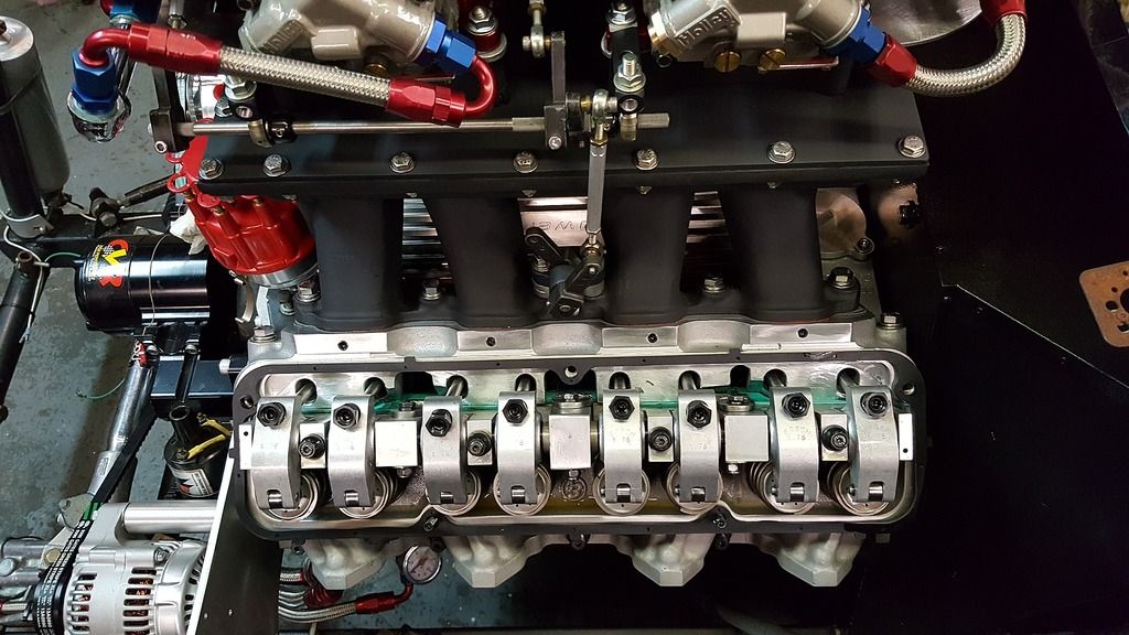

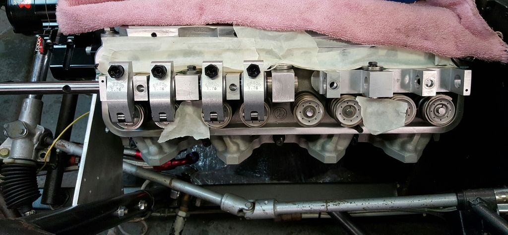

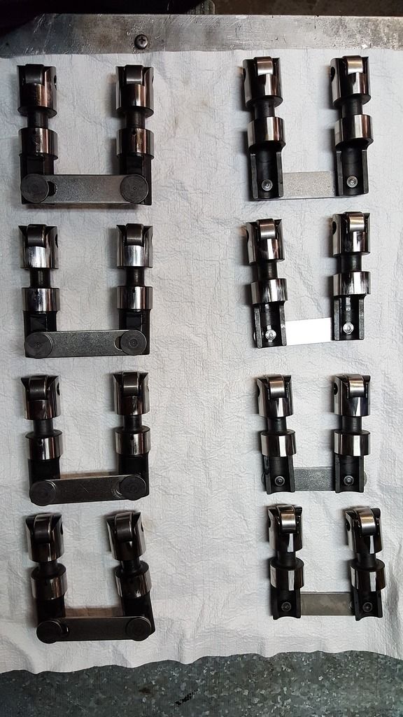

Setting up rocker alignment over valve tip and push rod tubes. Its much easier (for me) to do it and get it right this way with the shaft supports already mounted to the head and being able to slide the shaft in from one end while adding the spacers.
Also, my slightly used lifters all cleaned and inspected and ready to drop in the holes.

The rocker assembly and valve train all installed and adjusted, cold lash set. Really pleased with all the room around the pushrods with Jay's adapter.  The last PSE adapter I had, I had to chew and whittle on several tube's to gain a little clearance.

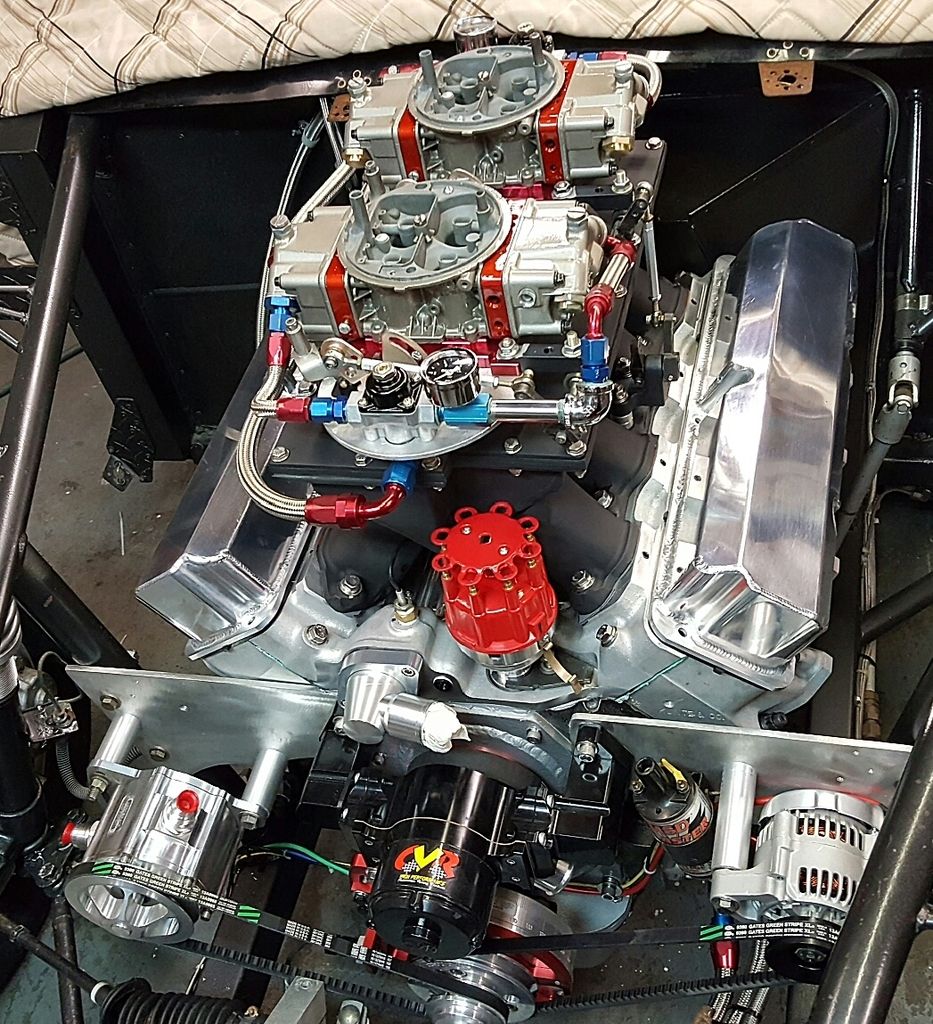

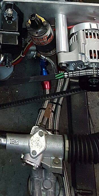

Alternator and vacuum pump  aligned and mounted,  water pump, Alternator, and primary ignition wiring ran and hooked up. Still some plumbing to do, cooling system and vacuum pump along with the exhaust headers to go.

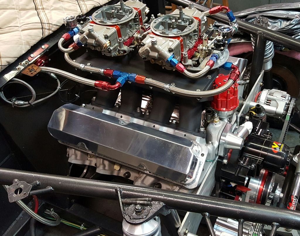

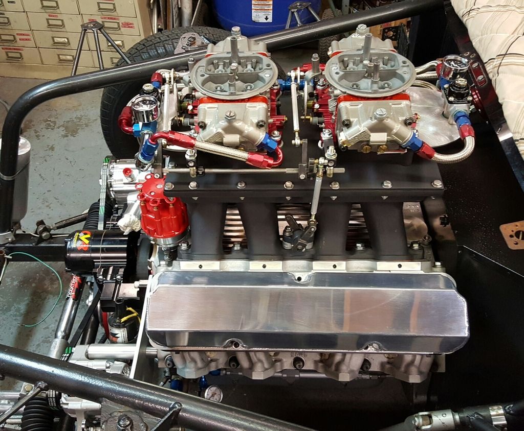

Intake and carbs installed, fuel lines ran and hooked up. Oil line feed and return along with additional external oil feeds to mains hooked up to filter re-location mount.
« Last Edit: March 04, 2018, 08:32:13 PM by fekbmax »

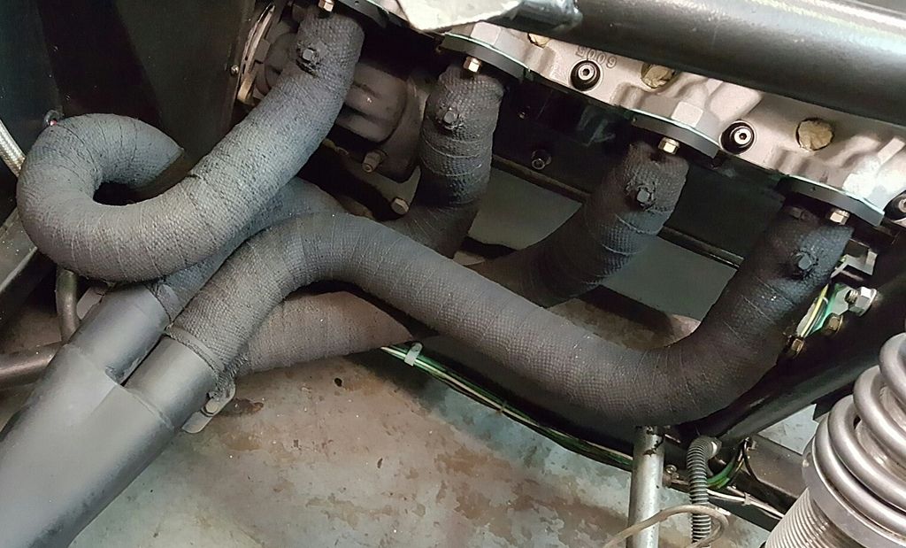

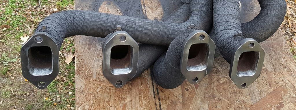

Made a little progress over the weekend, never as much as I'd hope but progress never the less.

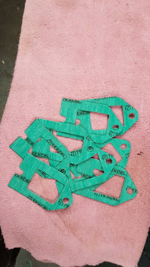

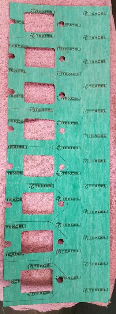

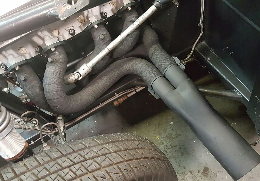

Had to do quite a bit of rough port matching to the pipes to accommodate the taller in the roof Kuntz exhaust ports.
Cleaned them up some, heated them infront of my gun heater, (cold here this weekend) then hit them with a fresh coat of VHT high temp..
Cut some gaskets out,
And now pipes are all installed and ready for some heavy breathing.
« Last Edit: March 04, 2018, 08:35:09 PM by fekbmax »

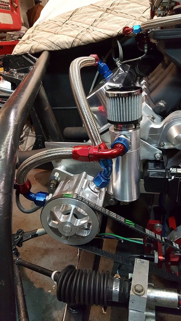

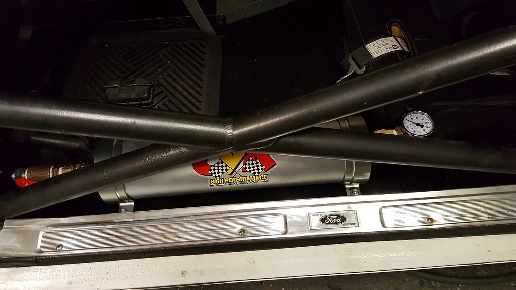

 Breather tank mount made and tank mounted, pump and tank plumbed up. Still need to install the relief valve and had thought about mounting it on the cover at the back of the intake adapter but thought about oil flooding it at launch so I reckon I'll just mount it on the adjacent valve cover instead.
« Last Edit: March 04, 2018, 08:35:53 PM by fekbmax »

Found a nice spot (for me) to mount the oil accumulator,  worked out well, it's out of the way, easy to get to and easy for me to open and close with the heal of your clutch foot as well. Works for me.. just need to pick up a couple fittings to complete the install..
« Last Edit: March 04, 2018, 08:36:24 PM by fekbmax »

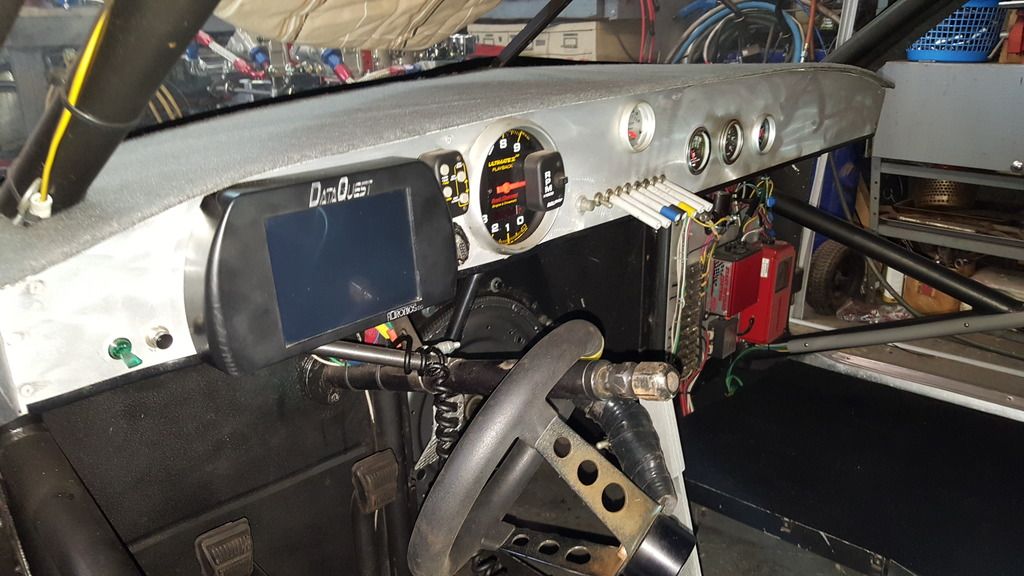

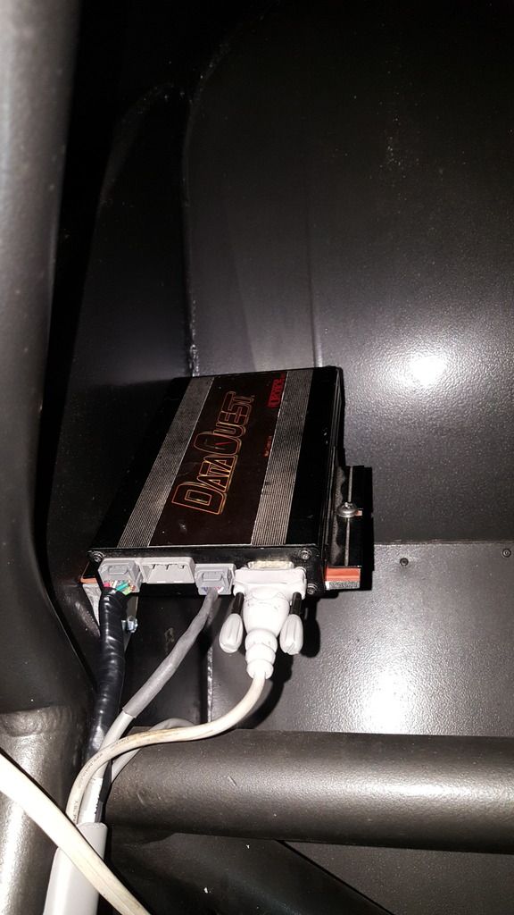

things have been moving slow, with holidays, travailing, lots of working over time, its been a busy end to the year and a eventful start to this one.

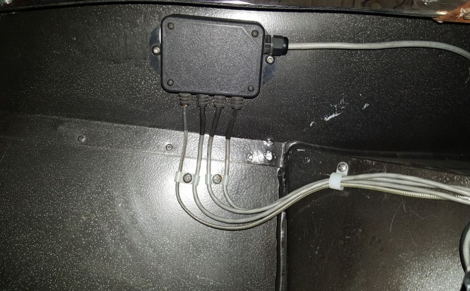

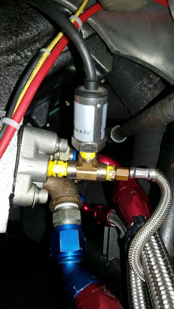

i have managed to get my DataQuest Data logger MCU mounted, the TCD mounted as well as the primary sensor Node and have it all about 75% hooked up. waiting on a few sensors and things to complete the task. for now i will be monitoring the basics such as :
engine RPM
Drive shaft RPM
Input shaft RPM
Battery Voltage
G Force
Oil Pressure
Water Temp
Fuel Pressure
Crank Case Vacum
1- EGT with plans to add the rest when and if any substantual amounts of NOS will to be used in the future .
2- Wide Ban o2 sensors, (1 each bank)
