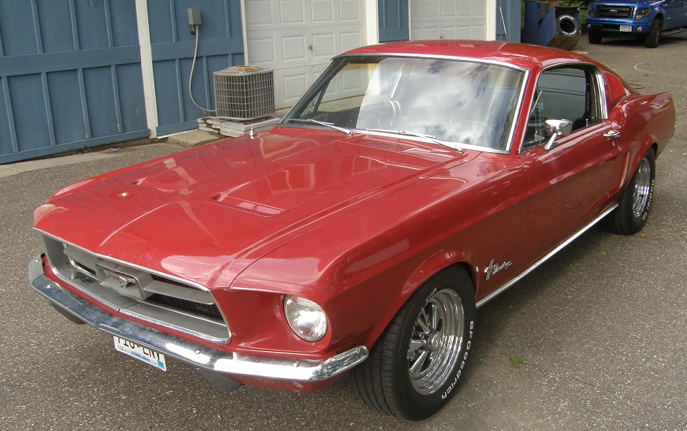

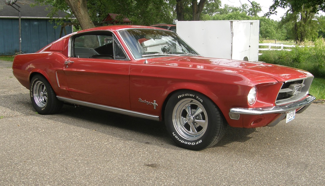

Wow... First time I've seen the top side of that car. Looks nice!

Yes, cool pics Jay! The car looks great. Did you repaint it or did it come to you that way?
I bought it like that, Bob.  The paint isn't great or anything but it still looks pretty good after 12 years of me owning it...

Well done...I like it.I see you even went as far as putting a 67 grille in the car.My 68 is a deluxe interior car but I do prefer the 67 stuff...
I noticed the 6cyl (no cid) running horse emblems on the fenders as well..
Thanks.  I really like the 67s better, probably because my first car was a 67 fastback.  That brushed aluminum interior and grill design stuck with me.  Right after I bought this car I found a ratted out 67 coupe with the deluxe interior, so I bought it, restored the interior and swapped it into this car.  Also kept the grille from that car and put it on during the revamp of this one.
Its a J code car, so it came with a 302, and that's what it had when I bought it.  Was it supposed to have different front fender emblems?  I'm afraid I don't know much about that stuff...
