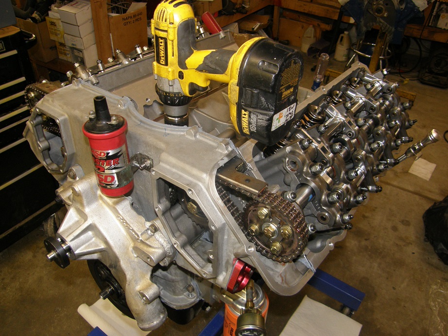

Pre-oiling the engine with the valve covers off is really important IMO, especially with these engines.  This is where you can confirm that ALL the rockers have oil, prior to the first engine start.  It is also a big mess on these engines, because the oil will overflow the heads and puddle under each exhaust rocker on the floor.  In preparation for that I had newspaper and paper towels down, to catch any oil that came pouring off the heads.  Here's a shot of the engine with my drill on a pre-oiling rod, ready to pre-oil the engine:
I added 8 quarts of oil to the engine, then spun the drill on low speed.  I was gratified to see that within 3 or 4 revolutions the drill was being dragged down by the pump.  The gauge read 65 psi, and the drill was probably only turning 100 RPM, so the oil pressure was looking good.  And sure enough, after 20 seconds or so I started hearing popping indicating air was coming out of the valvetrain, and then oil started pouring out.  This is what you want to see when you pre-oil one of these engines:
I checked to make sure that I had oil at all 16 rocker arms, and then stopped the drill.  Probably only lost a pint of oil on the floor  ;D

Looking at that shot of the right hand valvetrain, it becomes apparent the relation of the lobe in respect to the intake rockers. Since the cam is spinning clockwise, it seems that the cam lobe pushes almost directly against the horizontal plane of the intake rocker, unlike the exhaust where the lobe is coming from underneath. I'm amazed that the rockers roller can survive with that lobe/roller relationship. That has to become even more pronounced with higher lifts. Is that the cause of your previous rocker issues with the SOHC? Obviously premium quality materials MUST be used in those rollers to survive. I'd imagine the exhaust side has the same issue on the drivers side.

There's kind of a story behind the rocker and cam lobe geometry.  You are correct that on the right side the lobe pushes against the intake rocker and pulls on the exhaust rocker, as the valves are opened.  Exact opposite on the left side of the engine.  This results in varying geometries from left to right.  Ford knew this, and the factory cams had different lobes for the left and right cams, to equalize the valve action.  But none of the aftermarket cam companies back in the day ever did that.
Fast forward to a few years ago, when Barry R and I got Comp Cams interested in doing these cams.  I had an SOHC sitting on the stand, and had several of the early version Comp Cams sitting here, so I did a degree by degree measurement of an intake lobe and an exhaust lobe, one on each side of the engine, and forwarded the data to Billy Godbold at Comp.  The result was a change to the lobe profiles for their newest series of SOHC cams.  Now, when you order an SOHC cam from Comp, the lobe numbers for the left cams start with LE and LI, and the lobe numbers for the right cams start with RE and RI, because the lobes are different from side to side to compensate for the valve geometry variation.
The rocker issues I've had haven't had much to do with this, though.  Mostly they have been due to sloppy tolerances and inadequate parts in the rockers.  T&D was the first company that put an SOHC rocker together with the same needle bearing tolerances that you would see with a roller lifter, and that made the rockers live for a longer term on the street.
You are correct also about the missing cam bearing in the #2 position on the left side of the engine.  For some reason, Ford left that one out.  Go figure...
