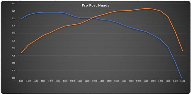

Here's the data with the edelbrock heads for comparison purposes.

Good stuff Jay. The explanation on smoothing vs actual is nice and all the overlaid graphings are a nice bonus
What is the LSA/ICL?

I'll have to look up and see what LSA I had it ground with.  It's good data.  I'd also be interested in the A/F ratios that Jay was seeing, along with oil temperatures.  Morel lifters can sometimes be picky about oil viscosity and oil temperatures.  They are assembled with a much tighter tolerance than some of the other lifters, so they won't work in every single circumstance.
Your data is also good data, Mike.  Good to see the out-of-the-box TFS heads showing similar hp and more torque than the $$$$$ Pro Port stuff.  The different heads may want slightly different cam specs, but it's nice to see those results.

ICL was 106, can't remember what the LSA was (my friend has the cam card now), but the cam was advanced a few degrees with the 106 intake centerline.

« Reply #10 on: August 07, 2023, 10:03:41 PM »
Do you have a link for your back to back testing?
Re: 482" FE Stroker, 582 HP, 581 Torque
« Reply #11 on: August 08, 2023, 04:35:51 AM »
I don't have any back-to-back testing with TFS vs. Pro Port, but I was referring to Mike Brunson's discussion up above, where he did a back-to-back test of iron heads, Pro Ports, and TFS heads.  The results are up above in his graphs.

800 hp does seem pretty optimistic......  I've had a few approach 700 hp with out of the box heads, but an extra 100 hp is quite a bit.  It takes a LOT of FE on the dyno here to approach 800 hp.
LSA was 115 on this camshaft, I just looked back through notes.
It's also interesting on your air consumption graph that the two lines crossed at ~5200 rpm, just like HP and torque curves usually do.........interesting indeed.
Normally, when engines need to be leaned up, I get excited because that means the engine is efficient, but in this case, I'm not so certain on that.
