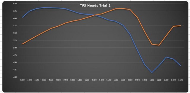

The conclusion that I came to for myself was this: Something about the head design doesn't agree with the larger cubic inch combinations and requires more cam. I think if we would have switched the cam out for the TFS heads we could make it work.....but that's not what the test was. We'd have to switch the cam to optimize for every different head and the test would be convoluted.
We have one head left to test and I'll post everything up in a big writeup, but the TFS bugs me because it makes for crappy data. The beginning of the curve looks very promising and it looks like it's going to outrun the two previously tested heads, then at 5900 it chokes. The trajectory shows that it's about to make 640-650hp, the other two heads made peak power between 6000-6100. If it carried out that far it'd be a strong running machine....... Maybe when we're done with this last set of heads we'll try the TFS with a different cam.

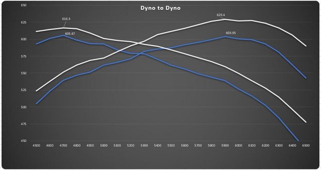

One more graph. This is our 465" "dyno mule" engine, white line on a superflow dyno, blue line on this inertia dyno we had access to for testing. We weren't real concerned about the numbers the inertia dyno was producing because what matters is the testing was done back to back on the same dyno. I think if we took this engine back over to a normal dyno we'd find that the TFS numbers are very healthy. Not knocking the heads, they perform great, but I wish the graph didn't look like it does. Makes us look like we don't know what we're doing.
Sorry to hijack your thread Jay! When I saw your data I got the feeling that you were running into the same wall we did and it's frustrating.
I have dyno'd a few large (496-ish) engines with some ported TFS heads.  It only increases the port volume by about 5cc, but the flow increases by about 25 cfm and the horsepower reflects it.
It could be that the heads are running out of port volume with the big engines, but I wouldn't expect 5cc to be a game changer and on top of all of that, the engines are peaking at a higher rpm with pretty short cam durations.  A 6000 rpm peak, such as on Jay's engine, with just a 243° @ .050" intake duration says a lot to me.
What I kinda think it is, is just difference between heads.   I've had Joe Craine port quite a few sets for me and he has made remarks about the heads flowing differently and going turbulent at different lifts.  Even though they are all CNC ported, there could very well be something different between castings.   A turbulent port could cause results like you guys are seeing.

What I kinda think it is, is just difference between heads.   I've had Joe Craine port quite a few sets for me and he has made remarks about the heads flowing differently and going turbulent at different rpms.  Even though they are all CNC ported, there could very well be something different between castings.   A turbulent port could cause results like you guys are seeing.
This makes sense to me. Could be seeing varied results caused by differences in heads. On our flow bench, these TFS heads went turbulent at .590". The port turbulence is what we blamed the power results on.
