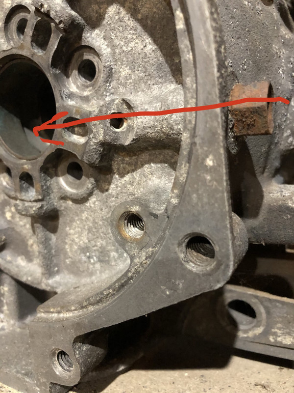

I'm trying to print off a template for my builder and have questions that may not have answers.
I ASSume that the position of the center punch is 1.17" - 1.18" to the left of center of the shaft hole, and is that .31" - .33" down from the center line? The .31/.33 reference is really confusing here. Also, the center punch mark appears to be off-center from the indicated hole...??? If I print this off to match the 1.17/1.18" scale, the .31/.33 reference and 1/4" hole don't workout and I end up with about a 3.5" diameter template, probably not all that much larger than it appears on your monitor.
Re: Broader C6 Oil Mods?
« Reply #38 on: August 27, 2021, 02:23:13 PM »
STUPID QUESTION ALERT
I’d have to see if I have the original template that came in the Ford kit put away, and see if the drawing exactly matches the measurements. Years ago I made a bunch of copies for people, my copy that is handy is printed on a standard letter size piece of paper. Just doing a quick measurement with a ruler it looks like it’s upscale a little bit. The size of the race boss on the template should match the race boss on the back of the case. And I don’t have a bare C6 case in front of me to check, but I’ll say I’ve done a bunch of these and I don’t even measure any more - if you look on the back of the C6 case you’ll see the casting bulge where the fluid return passage is, and where it is on the other side of that pocket. I just verify it’s there and there isn’t some bizarre casting shift and you should be ok. I realize you probably don’t have the transmission in front of you, and are just trying to provide the exact info for the builder ( and so he can’t blame you if he screws it up ), but what you’re trying to do should be pretty self explanatory for them. What is going to happen in use is that “pocket” is going to fill with fluid and then move into the passage in the race, it’s not critical that the case hole lines up exactly with the fluid passage hole in the race.  I wouldn’t read too much into the centerpunch mark being off center of the hole, it’s possible Ford didn’t assign their most senior draftsman to this instruction sheet project. But yes, I know exactly what happens when you “ass-u-me” lol. I might be able to grab a picture off a bare C6 case later this afternoon.
gt350hr
  • Posts: 941
« Reply #39 on: August 27, 2021, 03:47:47 PM »
     IIRC Ford incorporated this change into later transmissions.
« Reply #40 on: August 27, 2021, 04:55:33 PM »
Yes, probably started sometime in the 1969 model year I’m guessing, since the kit was released in ‘69. However my 1969 Thunderbird, which was built earlier in the model year, did not have the pressure lubricated race, so it’s always a good thing to check on any earlier C6.
Jackal said in the original post that he has a 1967 C6, so if someone hasn’t modified it already it will also be splash oiled.
« Reply #41 on: August 27, 2021, 08:08:54 PM »
Here’s a picture of the back of a FE C6 case. I didn’t get a chance to dig it out from the shelf today to check measurements, maybe tomorrow. But here’s a couple pictures to illustrate. The fluid passage you are drilling into to intersect is this one that the return cooler line attaches to. You can see it is raised on the casting. It’s runs pretty much straight across, then you can see it has an intersecting passage to change the angle. It exits at this hole in between the two output shaft bushings. Where you are drilling inside that pocket in the race boss of the case will intersect the inner part of the passage allowing some of the pressurized fluid to run through the small lube hole that is in the new style race.

This is looking down inside the C6 case.
Here I'm shining a light from the left into the cooler passage from outside the case.
That is a piece of welding rod in the passage.
The vertical hole is the one you want to drill.
It's very easy to do, just get the hole in the correct passage, and don't drill thru the back of the case. ;)
Really, you can easily do this without the template. I've done it by "eye" many times.
Note; there are no bushings installed in this case.
It's a spare case I have laying around...
With the pics and info from thatdarncat in his post above, I hope you can see how simple this is. :)
Edit; even if you get the drilled hole "off" a little, it won't matter, as long as it goes into the existing cooler passage in the case.
It's not a super precise thing.
« Last Edit: August 27, 2021, 09:27:27 PM by galaxiex »

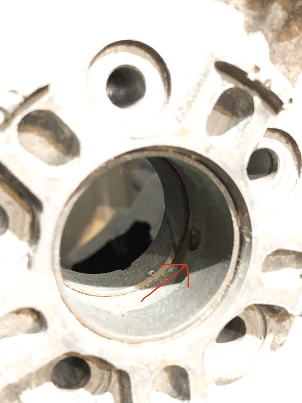

galaxiex
  • Posts: 282
« Reply #43 on: August 27, 2021, 09:34:48 PM »
Here's a close-up of the hole.
"more or less" centered side to side in the oval part, and slightly down from center, top to bottom.
« Last Edit: August 27, 2021, 10:28:29 PM by galaxiex »
Jackal
  • Posts: 93
« Reply #44 on: September 07, 2021, 03:44:39 PM »
Killer pics and info! I wasn't sure if there was a bulge in the casting for him to go by or not. This helps a ton. Just a note that the Broader instructions spec a 1/8" hole vs. factory 1/4". Interesting.
