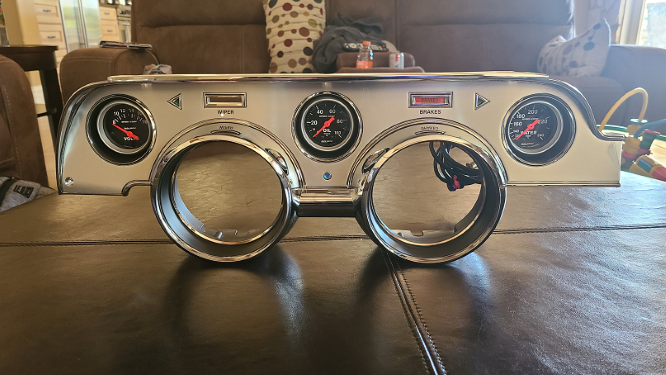

I'm just trying to figure out how to put an AutoMeter tach in the speedometer opening.
can't get picture to post
Mike, the only tach I could find that had the correct dimensions was a smaller auto meter white face gauge. There's a couple companies that sell the whole instrument cluster with new auto meter gauges in all the holes, but that was a bit overboard for what's needed here.
I put AutoMeter gauges in the top 3 openings the same way you did. The matching tach is too large to fit in the existing opening but enough of it should show to be readable. I have a spare junk dash that I might try modifying by cutting the opening larger from the back to see if I can get it to look decent. There is plenty of room behind the dash face since I'm not using any of the stock internals or wiring.

Calverts dash with the 5" installed
154 by Bob Smith, on Flickr

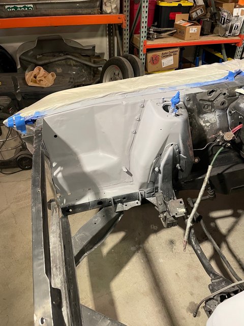

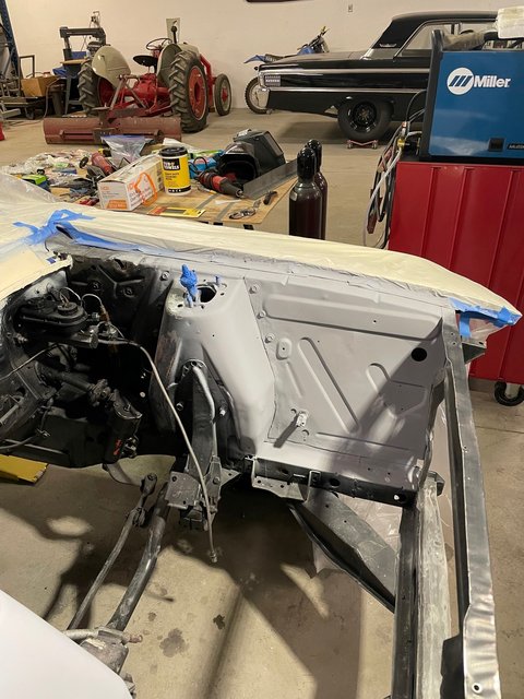

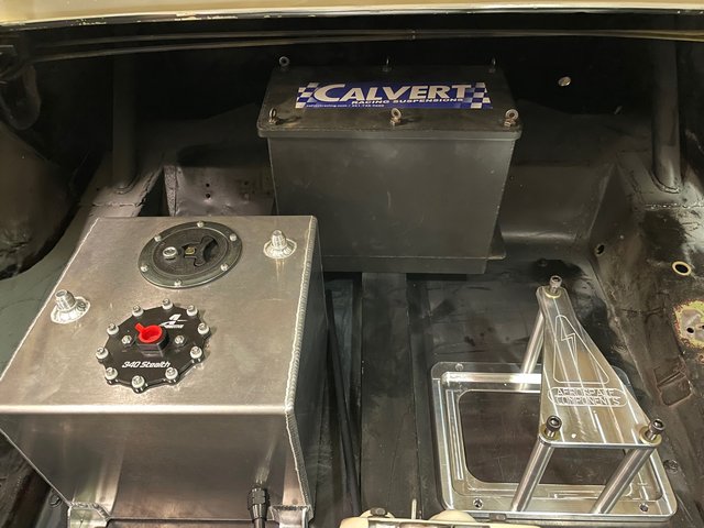

Marc, here are some engine compartment detail pictures as requested! We welded shut quite a few holes. I did a quick job of some shade tree bodywork before spraying it black. This week the goal is to get the whole front end of the car back together and get the trunk buttoned up (fuel cell and battery tray). We had to weld tabs onto the fuel cell because it didn't come with any sort of mounting provision.

I’m curious about the ballast. How much is in the back of the car. Is it enough to get the rear to be the same weight as the front. Ya know we always try to get our cars as light as possible but I know the front of my car is like 450 lbs heavier than the back. I always wondered if the weight to get the car at 50/50 hurts the ET or helps.
« Reply #55 on: June 14, 2021, 09:07:23 AM »
There was a considerable amount of weight added to the trunk of the car. Between the battery, ballast bars, ballast box, and the mounting frame that was back there I would guess 200 pounds? To run B/SA the car needed to weigh in at over 3300 pounds. Not sure that the extra weight would have been added if there wasn't a requirement. I think in this case the car needed to be heavier and the trunk was the convenient place to put the weight.
I don't think we will end up using ballast. We are putting the box and the ballast mounts back in just for the sake of being able to easily convert it back to stock class configuration if we want to.
