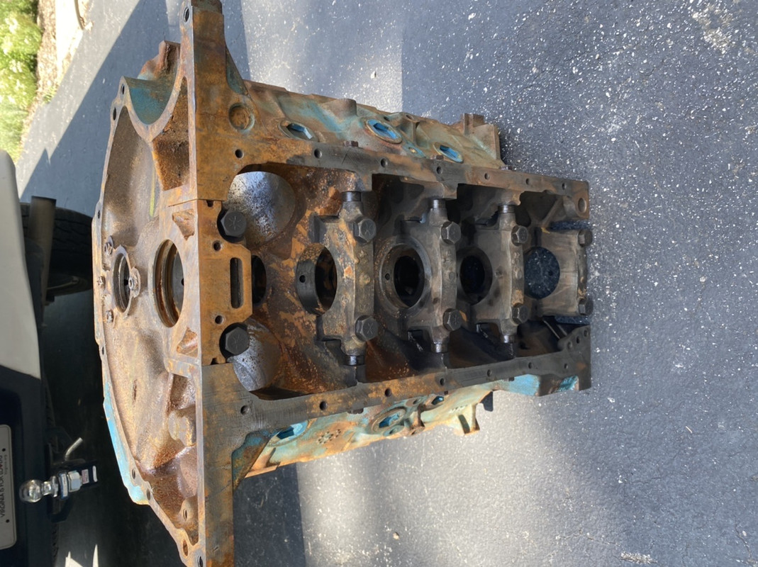

Snagged a standard bore 427 marine block at Carlisle with a cracked water jacket, and wanted to get an opinion on the best way to fix.  Also, any known good cast iron welders in the Mid Atlantic region, let me know as I can travel a bit to get the block fixed.

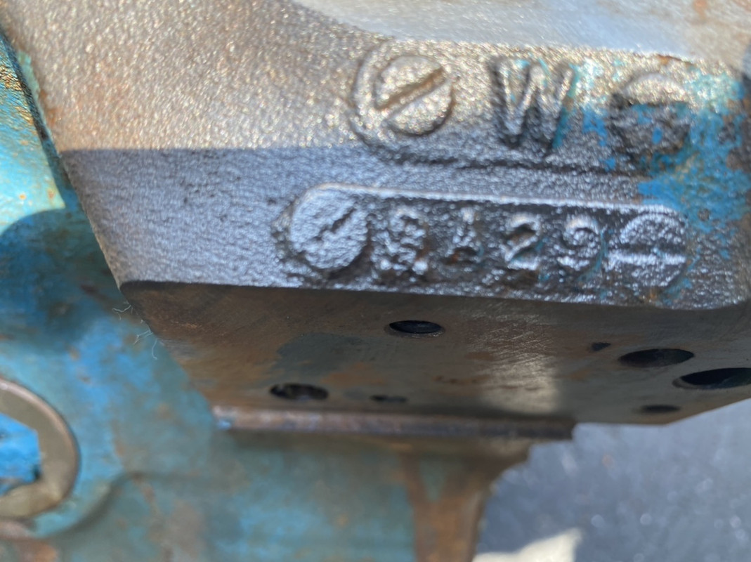

Can't read the date code on this one, first number is mangled.  I know sometimes they can be dated depending on which foundry location they came from, this is a DIF block.  Looks to be drilled for hydraulics but I haven't pulled the plugs for the galley crossover to see if they're plugged.

You can look into stitching it back together too.  I've seen this done before it's pretty neat.  There are a few places that do it, below is just an example.

Thought about the stitch locks too, but wasn’t sure if they’d hold water, I’ll look into it

The date code under the oil filter adapter pad looks to have the two dots under the leading year digit. Those two dots under the year started around 1969. Just going by memory, but I don’t think I’ve seen any FE blocks with the two dots in 1968. Your block doesn’t appear to the have the external “ribs” on the outside of the block, best we’ve figured out so far the “ribs” started near the beginning of the 1971 calendar year in DIF cast blocks. There’s a thread going elsewhere on the forum here about the “ribs”. So my guess is it was cast in 1969-1970 calendar year.

Find some one who can check it over good before you put much money in it i  had two Fe broke like that a 427 and a 428.After fixing the crack like yours they both leaked inside some where.I am not trying to rain on your parade i hope yours is ok.

Worked at a Diesel machine shop, we called that pinning. Fixed lots of big, odd diesel blocks with huge windows in them that way. We had good success with no external leaks. Very time consuming, but none of the problems associated with welding existed.

I'd also recommend pinning, you can do it yourself.  Not that hard, I've fixed SOHC heads with it.  I use the products from the link below:

For welding, the best, bar none, is Chris Razor, Hi Tek Welding, 734 414 1994, in Plymouth, Michigan. When he welds cast iron, he uses a system developed for repairing the giant ladles used in steel-making. Last I knew, he was a co-owner of the necessary equipment along with Jack Roush, who is his partner in the stuff. Chris does their specialty work.

I've used Midwest Cylinder Repair to weld up an SOHC head that was too far gone to stitch.  Probably 12 yrs.  They were recommended on the FE forum.  Did a great job.  They should be able to do a block since the SOHC head is about as big as a block :)
It was a proper repair, first they heat the part in an oven to a very high (red) temp and then weld in or melt in cast iron material.  I think their main business is diesel and farm equipment cylinder head repair
Some of the guys on this forum or the FE forum have used them.  Maybe you can get a more recent review.
With this block after the repair (regardless on how it's fixed) you should expect a full machining regimen
