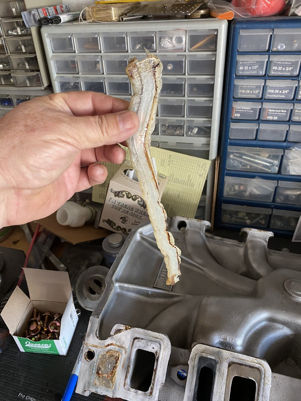

Couple questions for y’all.
After reading Jays book I’m thinking of keeping the Streetmaster on this engine. I’m not worried about any numbers correct deal. That and the right cam will make a nice little runner.
So, my questions.
See pics below. The manifold is a HUGE mismatch. Small runners into a large head port. I know that matching runners to port for street engines is not necessary. However this mismatch is so large I can’t see the harm in at least rounding out the manifold to match and maybe take a bit out of that floor. Thoughts?

Marc, in my book there are some comparisons between leaving the Streetmaster ports stock and port matching them to the heads.  If you are looking at 425+ HP, I'd port match it.  But, only the top and sides, leave the floor of the intake alone.  And Joe does indeed do a heck of a job on those manifolds, if he is still willing to do it...
I have a feeling he’d tell me what you did. I know he’s retired ish and only doing interesting projects (hope that’s correct info Mr. Craine). I tell ya I wouldn’t mind just doing a little port match myself and don’t go more than an inch in.
Why leave the floor alone? That’s a big step.
Edit
Thinking more about it, it would probably mess up the good idle aspects of the manifold and slow the velocity.
