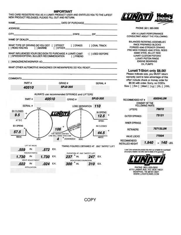

Its really good that this discussion has remained quite civil as it is very interesting. Especially for us guys that weren't around 'in the day', don't build engines everyday or in countries where the FE was not produced.
What I will say is, if I remember correctly, in the OP's original post he said something about showing some chevy guys what an FE can do. It would be a shame to tip a heap of money & effort in and get mauled by a modern built 350. My advice is heed what these guys are saying. Any cam suggested to make your combo run great is still going to sound pretty good through the right exhaust.
As an example my 390 used to use the attached cam. Edelbrock heads (out of box), various largeish carbs & tri-y headers. It made 7" of vacuum, didn't come alive until 4000rpm (converter was 3500) and I used to regularly spin it to 6500 & occasionally greater. It sounded plenty nasty, turned heads & won its fair share of street action when it should have.
Currently rebuilding & putting a smaller cam in :)
