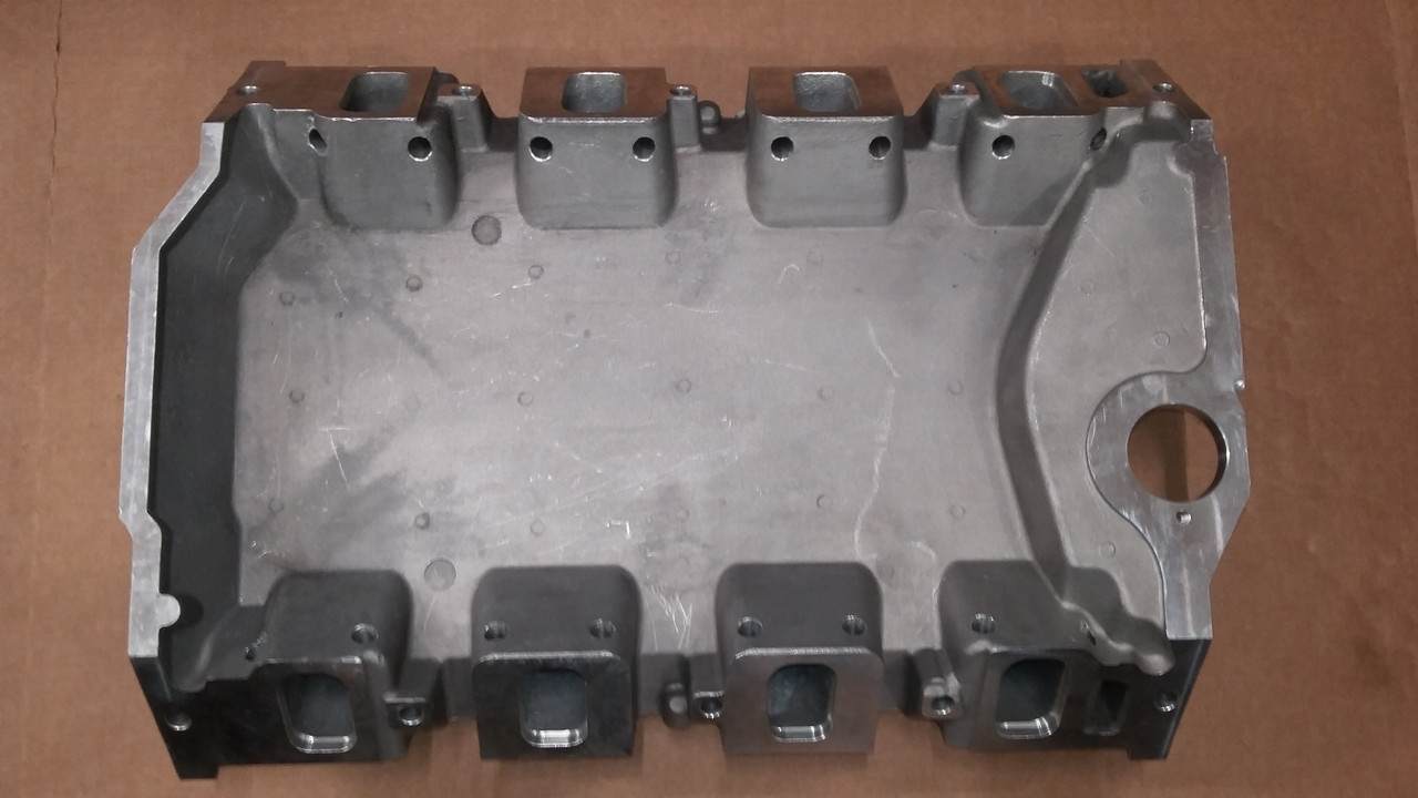

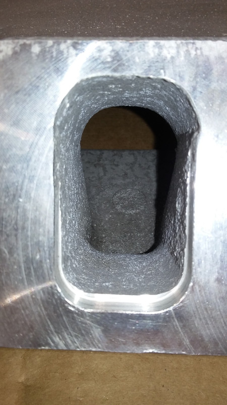

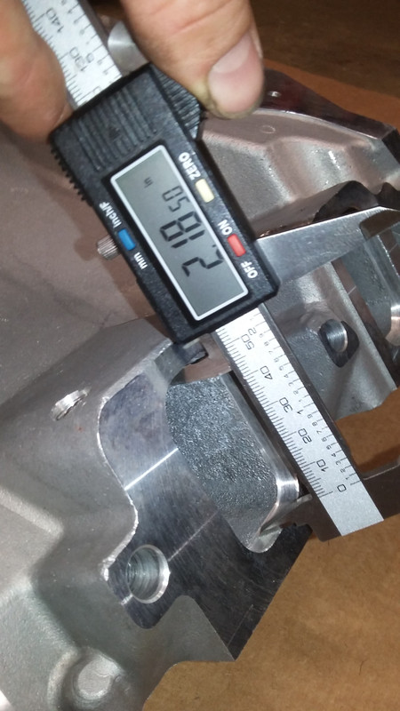

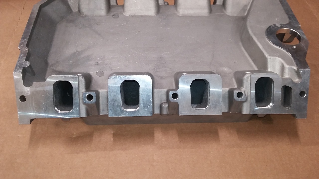

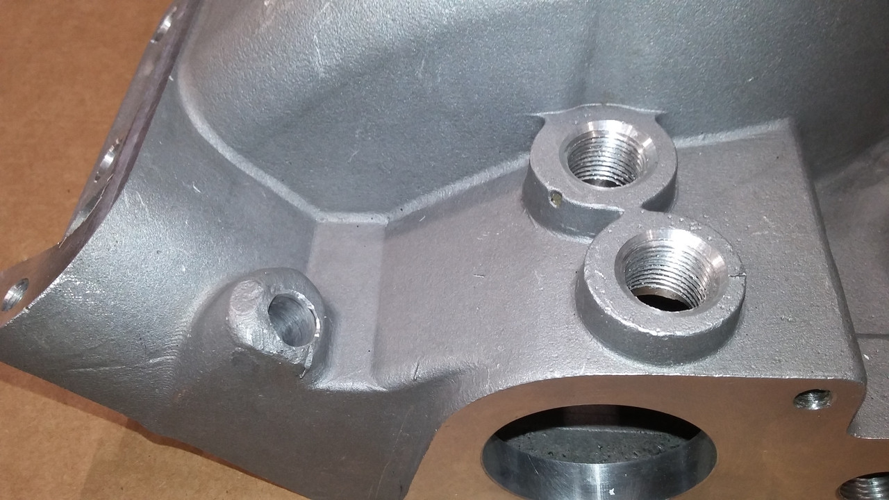

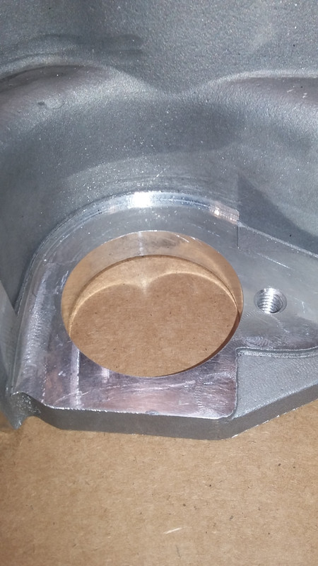

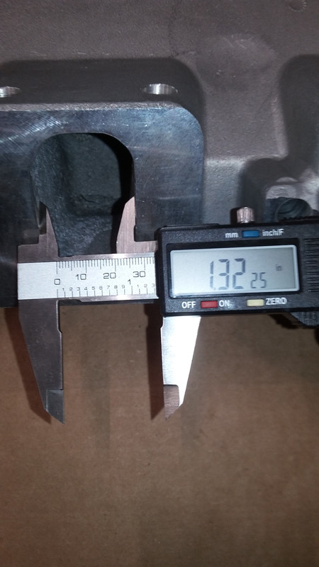

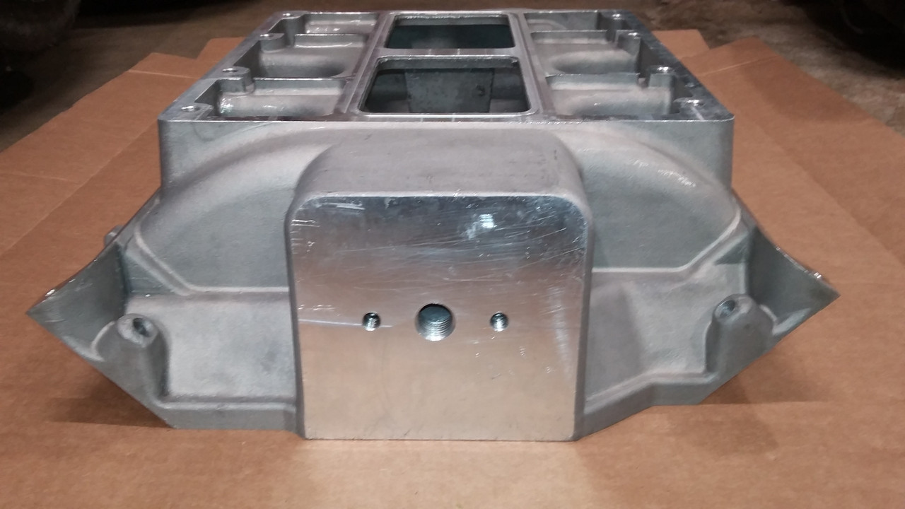

I took some pics of the intake. The intake is a fair quality casting, I'm sure the Blue Thunder is nicer. I think it is good for the price. The machined surfaces are surprisingly flat. I checked them with a precision straight edge. There are a few small scratches in the machined surface, but nothing that would inhibit sealing. Edges need to be deburred better. The distributor hole is chamfered on the bottom side, but not the top where the distributor will drop through. Overall height is 5 1/8". The ports are roughed in. Some need some definite attention to clean the rough casting inside. Pushrod holes are 7/16".
Front and rear bolt hole bosses should be spotfaced.

Pretty much what nightmist said. It's nice and flat and straight, really good casting compared to the 351c two piece intake I got from them 3 years ago. I like the rough un finished ports cause honestly with all the heads and port configurations now most any intake you get is gonna need at least port matching. Threads were nice and clean and rolled, not real sharp and jagged like some of there older stuff. My biggest issue is the small pushrod holes but there seems to be plenty of beef to open them up some as long as your careful and go in the right direction.  In my opinion it's well worth the money and with a little massaging it will be just fine, beats the hell outa a $1600.oo blue thunder that you can't even get. I'd recommend it as long as you know there will be some massaging.

Those scratches on the backside look like box damage, not bad either. The bolt hole tops not having been spot-faced is weird but not a big issue either. I'd ask if the intake has been dry-mounted yet to see how everything lines up.

By "spot faced" do you mean the tops of the intake bolt holes have not been machined to a flat mounting surface?

My Streetmaster was like that, I grinded a Mercedes Diesel headbolt to a cutter with the
angle grinder
First i used the cordless drill to drive it, it was to high speed so the alu smeared
I just used a ratchet and a allen bit and spotfaced by hand, quick and easy faster than
riging up it in the mill

That doesn't look like too bad a piece. It looks like it could be machined for a burst panel.
