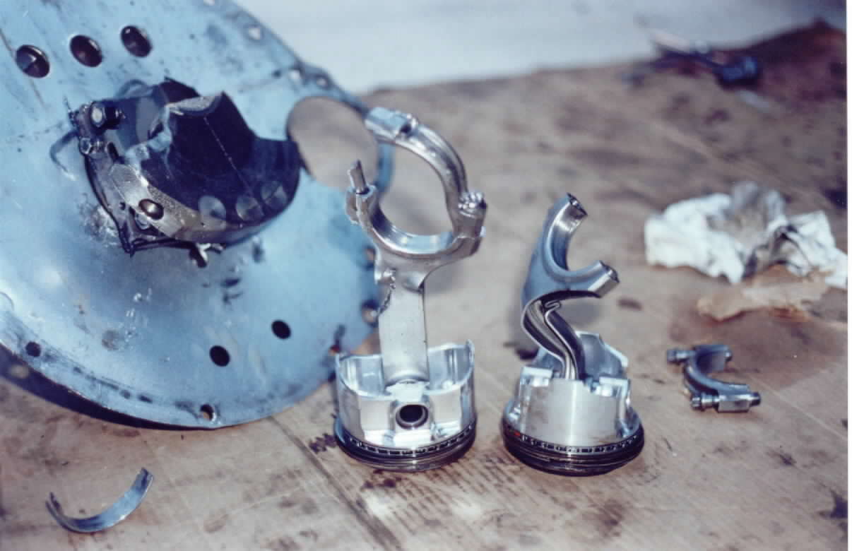

This was Memorial Weekend 2000.  Only had 50 passes on fresh rebuild.  Crank had been magged and was given a clean bill of health.  .010 under 428 crank.  Crank came out in FIVE pieces.  Granted it came apart at 6000 rpm.

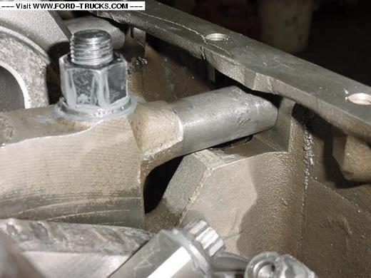

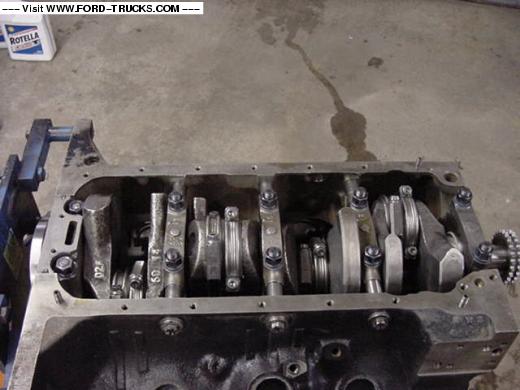

It was actually a 406 HP block.  It was .050 over, 3/4 filled, I put 427 caps on it.  Running a 1U crank.
Still no real thought on what came apart first and why.  I give full credit to the scat rods.  They hung on for dear life.  In the picture you can see that only one actually lost the head of the bolt, but never let go of the crank.  The mangled one really held on tight.
If you look at the block picture closely, #3-7 are hanging down a bit more then the rest.  That journal is also broke loose and just hanging there.  It broke at the thrust, the #3-4 journal, #4 main, #4-8 journal and the rear main.
