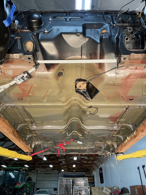

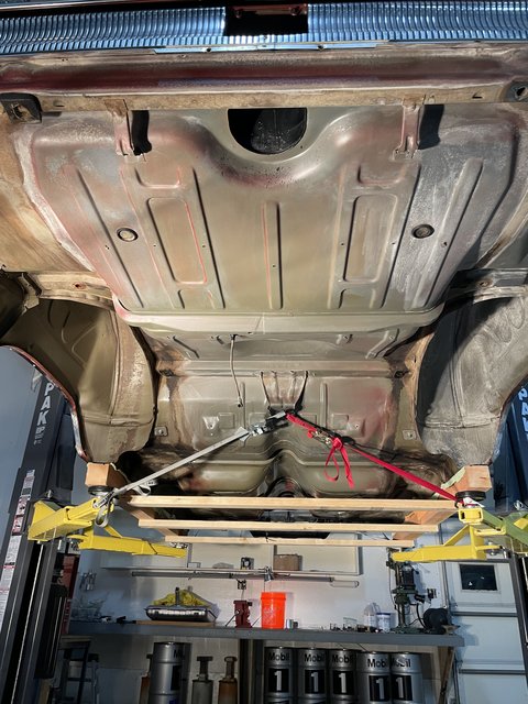

I'm not sure how to tell you exactly what the color is, there is really no documentation on this (as you may have already figured out). My car also came from the Dallas assembly plant, so it's safe to say that yours should be painted the same color. It's a tan color with a hint of green in it.
You can see where the underside had overspray on it. I showed all of these pictures to the body shop that is painting our '60 Starliner, they aren't going to mask the bottom side when spraying color on the car in hopes that it oversprays similarly.

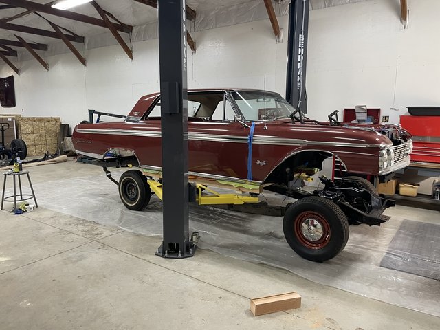

« Reply #111 on: October 11, 2022, 08:42:24 AM »

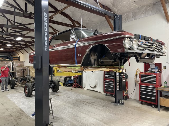

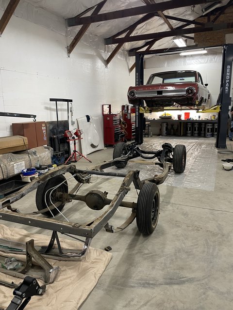

Things went a little overboard over the last couple of days. The underside of the car has been cleaning up well enough that we decided to go full-tilt and pull the frame. This should make a few things easier in the long run, such as painting the frame, securing the fuel lines, and boxing in the spring perches for Cal-Trac modifications.
Oh, and my cousin brought his new puppy down while working on the car. Trying to teach him young to be a garage guy.  ;D

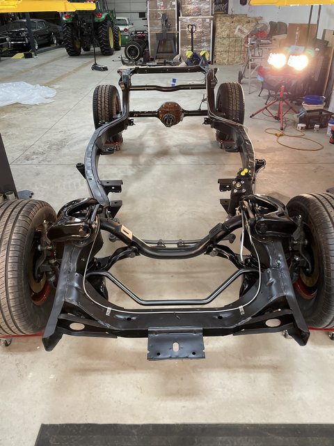

« Reply #116 on: February 20, 2023, 09:41:10 AM »
Reposting some pictures that were lost:

« Reply #119 on: February 22, 2023, 09:42:10 AM »
was the underside sand blasted or another method was used? Very clean!
The method was me in a rain poncho spraying kerosene underneath it and scraping/brushing off undercoating. Was a total pain. Worth it in the end, but it took way too much time. Every time I gowned up and worked on it my wife would come out and take a picture of me and send to our friends....."my husband is nuts".
