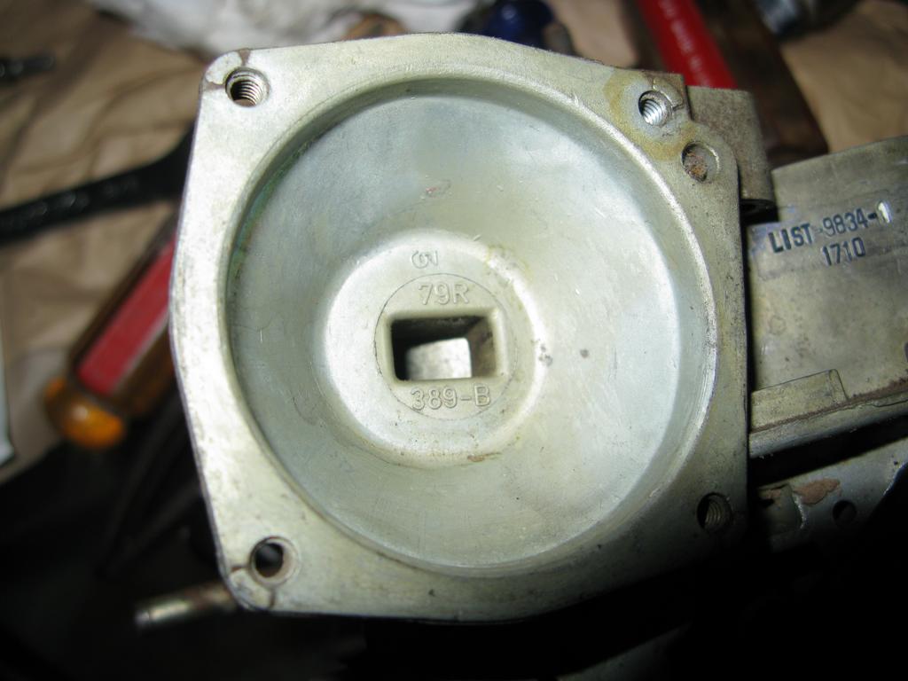

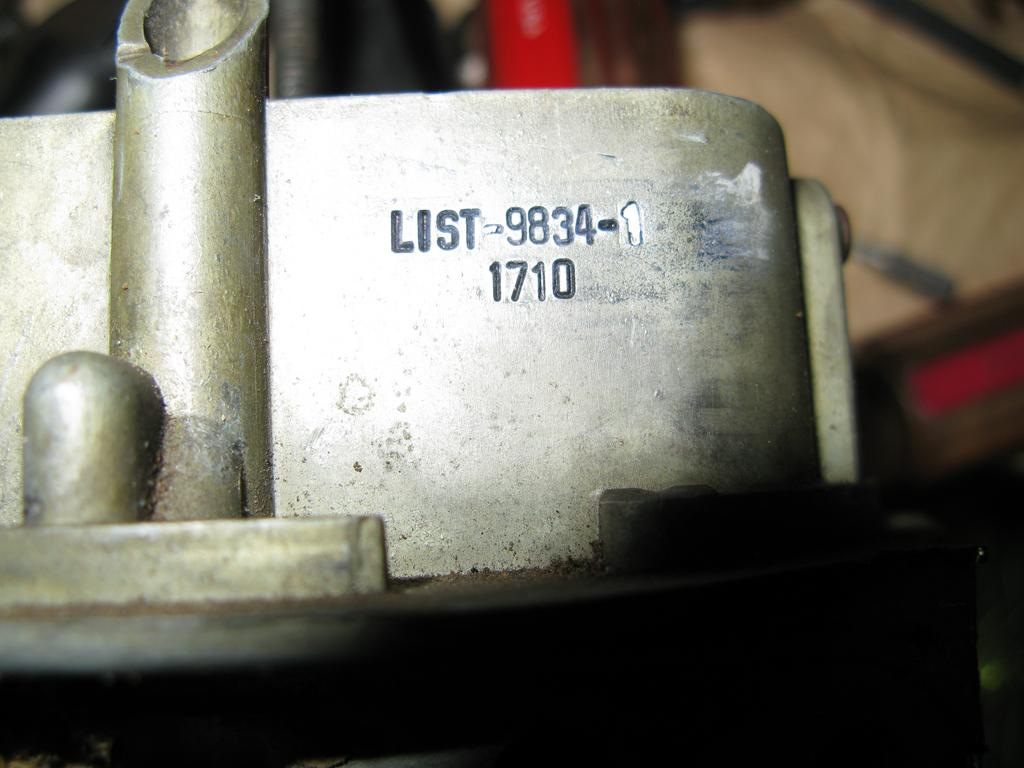

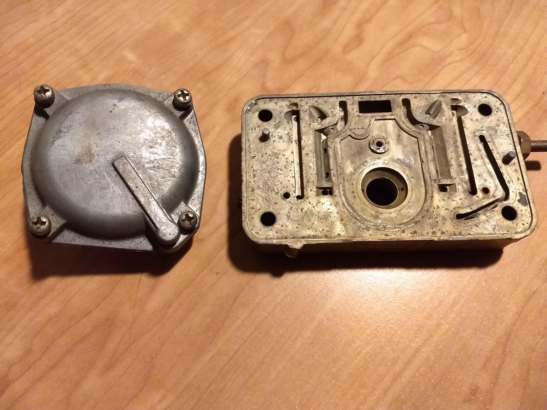

The pics are of the carb I need a vacuum cover for ....
Any have a vacuum secondary cover ??
Also, Tommy or anyone that has a front jet plate with a ported vacuum tube on it
And.. any ever see a holley with just the aluminum rear plate, no thin plate in between ??
The 600 Holley I was rebuilding earlier has only the aluminum plate ??

Those look what I need
I noticed the vacuum port, all the 4160 carbs I have seen had a pressed in tube
The plate I have has a large large hole where the tube would be pressed in
Perhaps 2 different castings ??
The one with the large hole may be drilled into ported vacuum and the hole threaded from factory ??
Are they spares ya do not need ??
