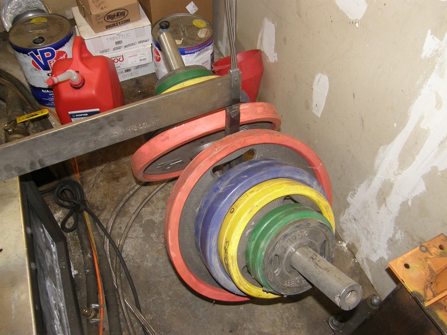

Once the bar is installed, you can start checking the calibration.  The torque output on the computer screen of the dyno should ready 17.5 lb-ft at this point.  Next, I have a hanger that I built to hang weights on the calibration bar.  Basically what I did was buy a free weight set and hacked it up to make up this hanger, and then used the weights for calibration.  After welding up the hanger, I took it and the weights to the local UPS store and weighed them on their certified scale, to an accuracy of 0.05 pounds. I labeled the hanger and each of the weights with their exact weight, based on the reading from the scale.  The hanger weighs 29.85 pounds, so once it is hanging on the 3 foot long calibration bar, the dyno's torque reading should increase by 3 X 29.85, or 89.55 pounds.  A picture of the hanger is below:
Next, more weights in pairs are hung on the hanger, to increase the torque on the absorber.  Here's the first step, adding two 45 pound weights which together add 270.30 pounds of torque:
Here more weights have been added; see the tag on the 25 pound weight, giving its exact value:
Finally here are all the weights hanging on the bar:
Here are the results from my calibration test today:
Actual Weight          Dyno Reading
     17.50 lb-ft               17.50 lb-ft
     107.05 lb-ft            106.50 lb-ft
     377.35 lb-ft            377.70 lb-ft
     523.30 lb-ft            523.55 lb-ft
     673.15 lb-ft            673.50 lb-ft
     880.75 lb-ft            880.70 lb-ft
As you can see, the torque sensor is extremely accurate.  Any reputable dyno operator ought to have a set of calibration weights, and be able to show his customers exactly how accurate his dyno's torque sensor is.  It is a simple matter to change the dyno's software to increase the torque reading by 5%, 10% or more, and some disreputable dyno operators have certainly done that.  If you go to the dyno and want to be absolutely sure that you are getting accurate numbers, in addition to confirming the weather information you should have the dyno operator calibrate his dyno for you.  It will cost a little extra because you are paying for the dyno operator's time, but you will have peace of mind about the test results.
