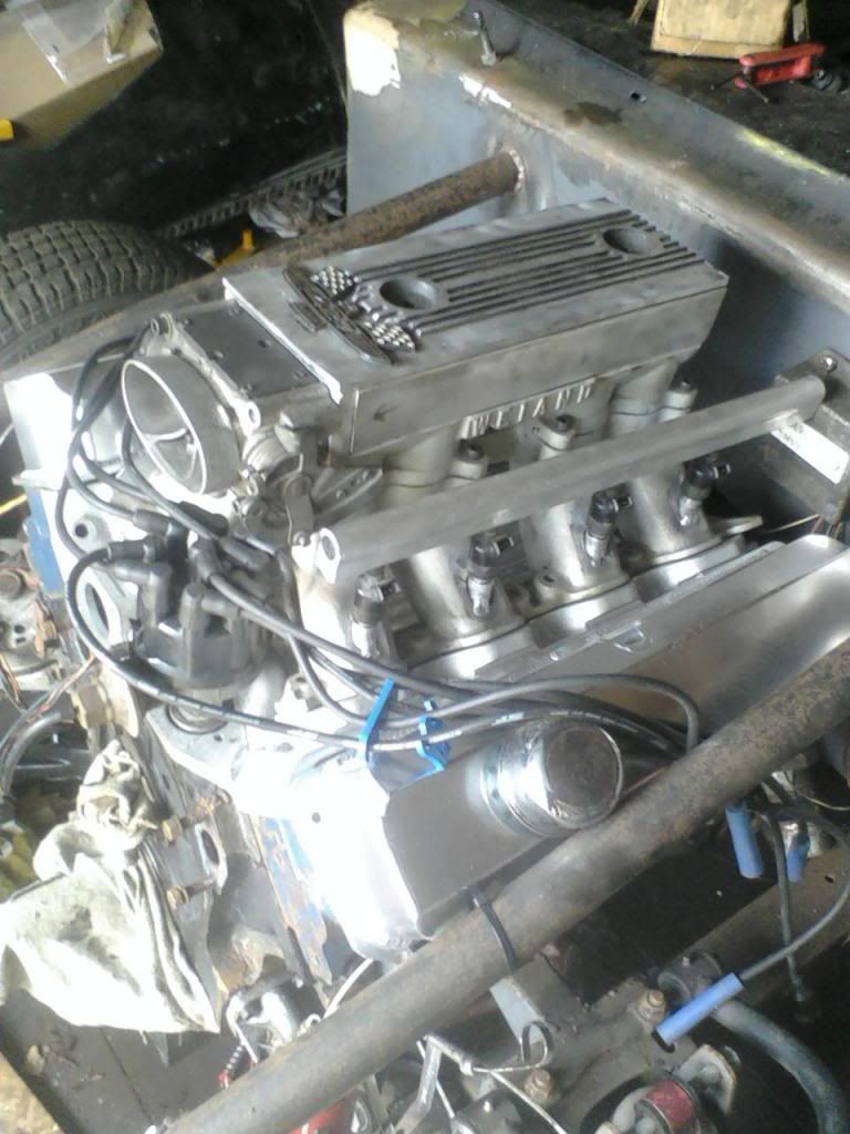

heres my plan for my adapter

it is GM :( but the harness I plan to use (FAST #302000 harness and self learning ECU) uses a TPI or LT1 throttle body and  GM sensors. I picked up a cheap LT1 complete intake to rob parts off of. I will be using 42lb injectors and a 1000cfm (58mm) throttle body once its complete. Hopefully this way I wont have to change over to a single 4 for daily driver duty and switch over to the tunnel ram for shows/racing. Hopefully in the next few months it will be up and running. Plus I can keep my scoop I made and not have to have the tunnel ram sticking over the hood 7 inches (wife wont go in it with the thing sticking out over the hood).

How far off are the ports? There have been discussions about adapting tpi but some were saying placement was wrong on the FE

« Reply #506 on: April 20, 2014, 08:35:15 PM »
I got aftermarket bungs and rails, the LT1 or TPI rails are wayyy off. Only thing I used on the LTI intake is the throttle body with TPS and IAC sensor, MAP sensor, and the vac. fitting for the adjustable pressure regulator. rest I thru on ebay. I made my own plate on the tunnel ram top to mount the throttle body.
I had to do abit of modifying to the front of the tunnel ram top to be able to still be able to bolt it down as the throttle body plate is right on the base of it. I countersunk each corner and used 5/16x3/4" allen head bolts (cut down 1/4") and the other 6 are allen head bolts still 3/4". The front allen head bolts now fit flush with the top of the top plate and I can then bolt on the throttle body without a problem. I used a 1/2" thick chunk of alum, drilled and tapped for the throttle body mounts. I could take a picture of that if you wanted to see what im trying to say lol.
