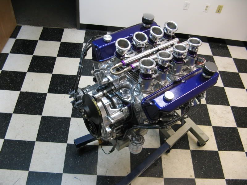

We've done a cam driven distributor already, and used a fabricated "spud" to turn the oil pump.
I've talked to Jay briefly about timing covers, but do not know where he's headed on that project yet.
I "need to get to it" on the adjustable timing set - just have not had the time.
Anybody interested in self adhesive gaskets for oil filter adapters, timing covers, water pumps????
Remember this engine?
