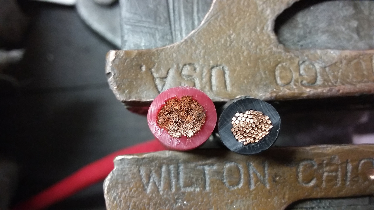

I could be wrong, I have been many times before. That's just my basic understanding of it. I'm no electrical engineer or anything. The other things I gather is that the finer strands can dissipate heat better in prolonged/higher current situations. The flexibility is a bonus. The coarse is also a little more prone to breakage from being stiffer and more susceptible to vibration.
Edit: Here is a comparison between the stereo cable and a typical parts store cable of the same size. The strands on the left do not have any gaps between them, just high and low spots that look like it. It appears to me, that given the same gauge rating, the left has much more available conductor within the same rated size. One of the reasons I wanted to use it, and I got it for free.  :)
You're not alone on being wrong, I'm right there with you.
I like FREE, it doesn't come around often for car parts!! Just make sure the insulation is good for use as a starter cable. It should have some markings to identify insulation type, voltage, and or heat.
