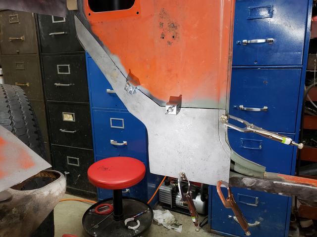

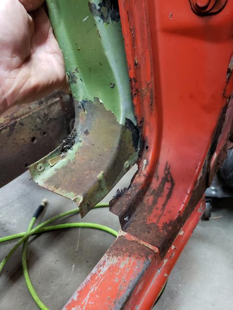

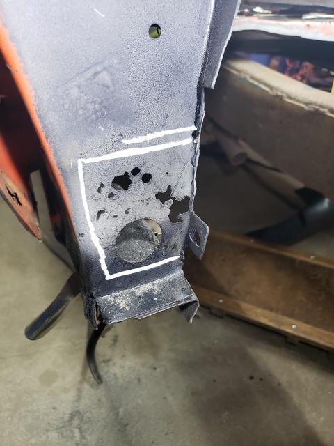

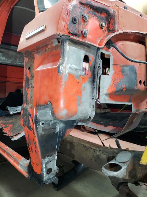

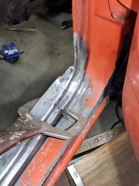

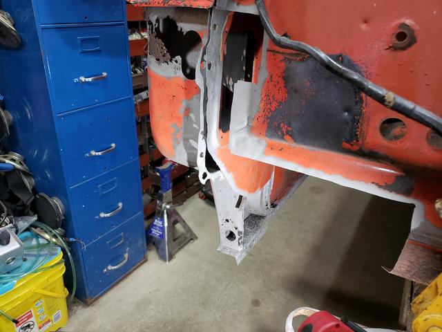

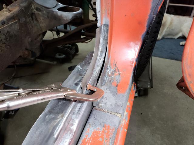

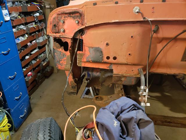

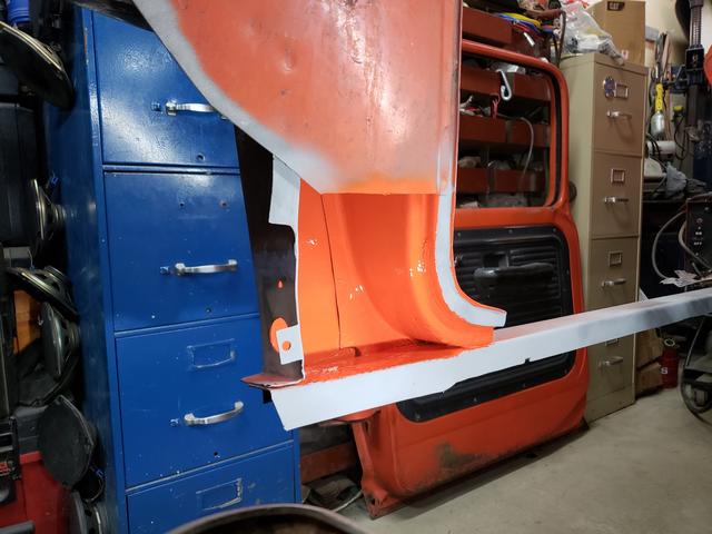

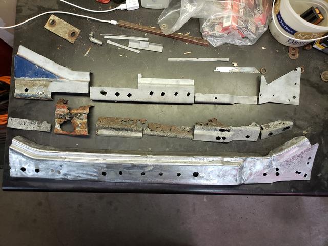

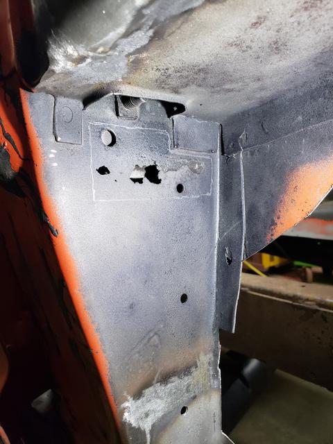

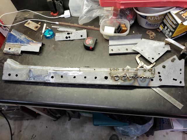

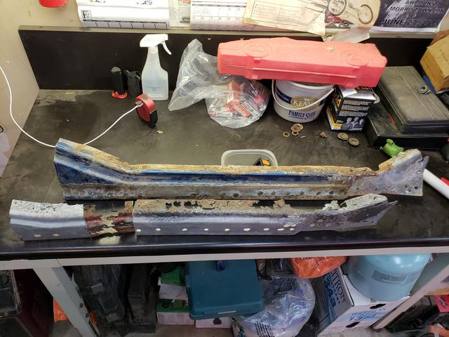

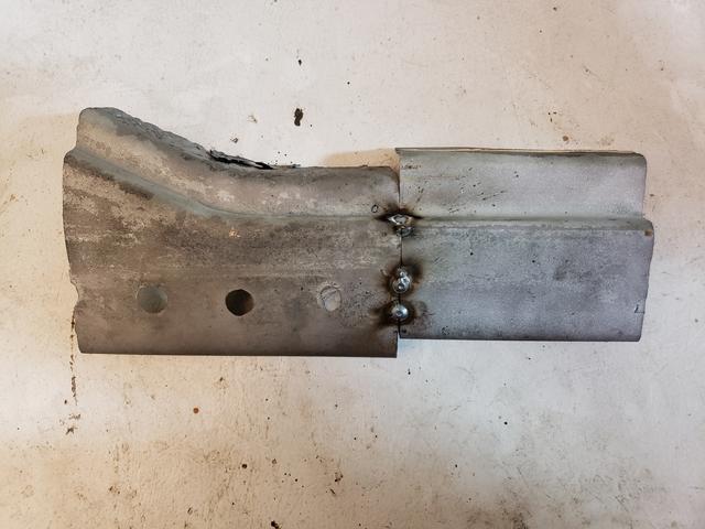

The passenger side is going good so far, I have the floor, cab mount, and rusty firewall sections cut out. The inner rocker pannel was rotten in a few places so I removed it to work on it. Unfortunately all of the 1967-1972 replacement inner rockers that I've found are re packaged 1973-1979 inner rockers which are similar in shape, but far from correct for 1967-1972s. I removed the inner rocker from the 1978 doner cab and cut it up to make patch sections. I cut the patch section out, welded it flush to the bottom of the weather strip channel, then cut the top off, cut a section off the bottom of the top piece and re welded the top back on to match the height of the original weather strip channel. The lower section of the doner rocker was shorter due to the weather strip channel being taller so I cut the bottom off the patch section, cut a larger bottom section from another area and weld it in. This was repeated in a few other places. The front door pillar section is another piece that had to be somewhat fabricated. Once again all of the pillar patch sections I could find were re packaged 73-79 pillars which aren't right either. I happened to have a 73-79 pillar pannel and ended up cutting the inner edge out, massaging it a bit, cutting the lip off, welding on a larger lip section, welded the patch in, rolled the edge to match and cut off the excess. The front of the door pillar also had some rust spots along with the air vent box. The passenger side cab mount bracket was also rotted in the same places as the driver side. Hopefully will be able to get the inner rocker in soon then on to the firewall and floor.

That cab looks like it was a touch on the ruff side! Looks like you've got it on the run tho, sheetmetal work looks good.

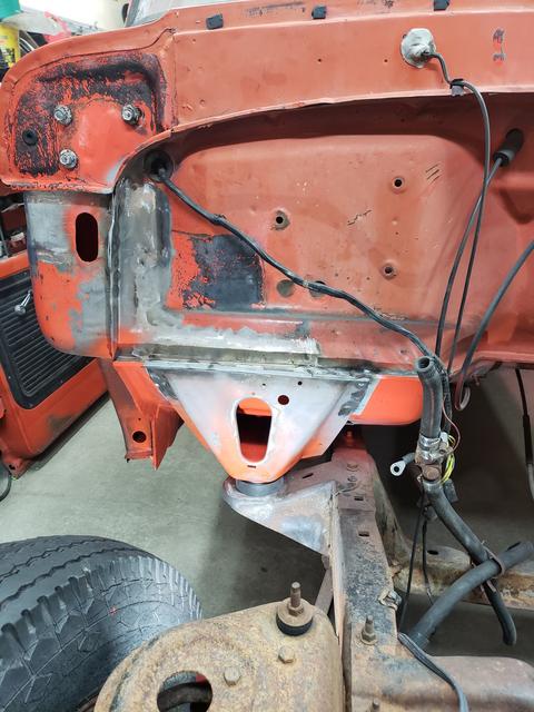

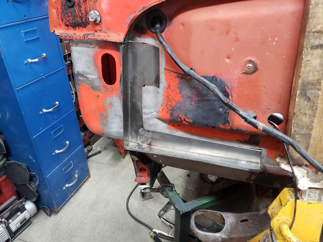

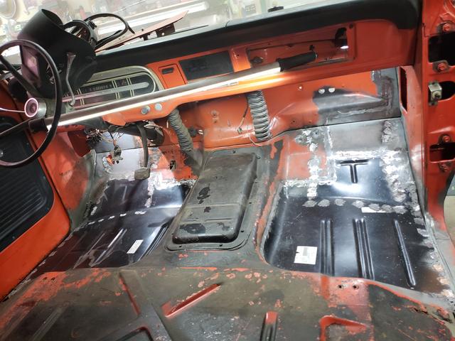

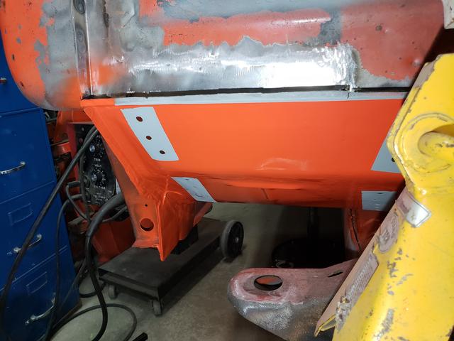

Passenger side is starting to look like something again. I still have to make a couple small firewall sections, then ill install the cab mount.

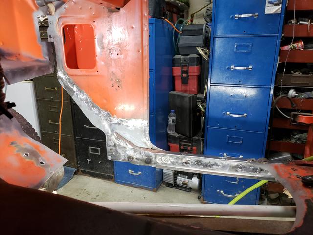

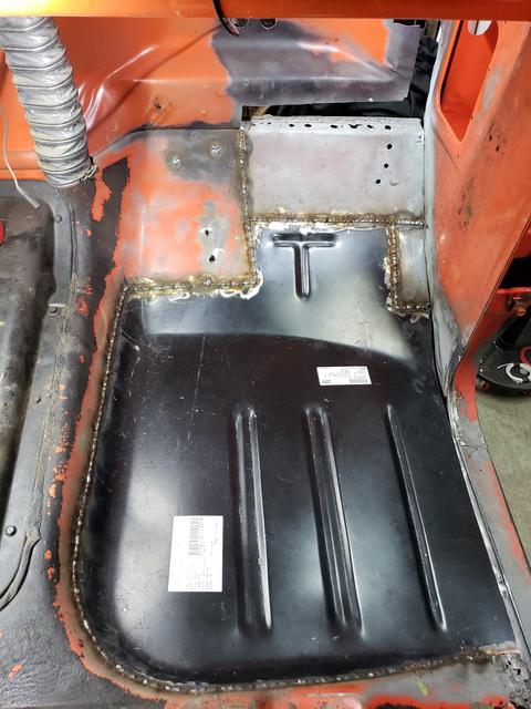

Thanks for the complements! It's turning out better than I had expected. A couple weeks ago I purchased a 36" metal brake and a sheet of 18 gauge steel. I made the last missing piece of the firewall with the brake. To my surprise it was easier, and turned out better than I had expected for my first attempt at making a patch panel from scratch. I finished fixing the cab mount frame bracket, and welding and grinding on the floor pan. The cab mount is installed and the cab is finally sitting the way it should! The next step is replacing the outer floor supports and making a couple corner floor pieces above the supports, then I'll call the cab done for now.
