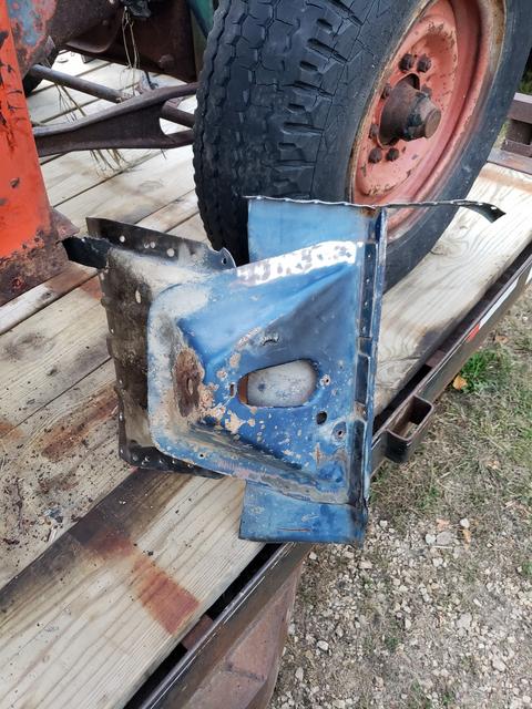

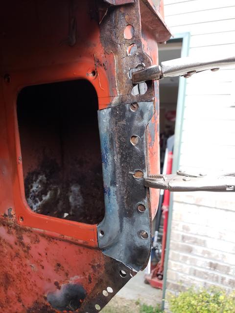

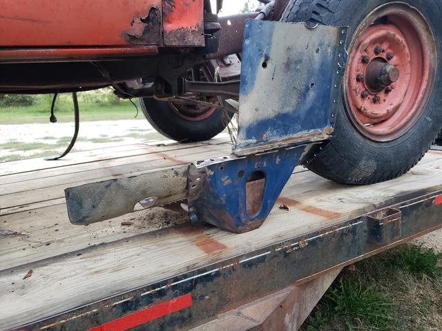

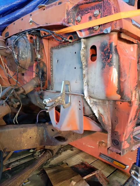

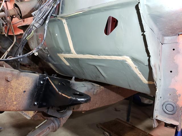

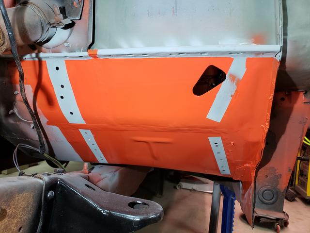

I've been slowly working on repairing the firewall and cab mounts. I haven't done a lot of body work so a lot of this is new to me and it's kind of slow going. I cut out the patch pannels I needed for the firewall along with the cab mounts. I sand blasted the mounts and firewall pieces then painted the insides of the cab mounts. I also recieved the floor pans and inner rockers, unfortunately the LMC inner rockers are wrong and look to fit 1973-1979 trucks but not even close to the 1967-1972s. The channel that the weather strip sits in is nearly a half inch taller then what it should be, and the rear where it kicks up has a protruding triangle stamping that should be flat. Unfortunately LMC is the only company to offer inner rockers so I'll either have to do a lot of cutting and welding on them, or see if I can salvage sections out of a rusty scrap truck I have. I really only needed a small section so I wasn't planning on using the entire pannel anyway. I decided to start on the slightly less rusty side, after I cut out the rusty firewall section and cab mount, I found some more rust by the floor vent where it meets the pinch weld seam. I cut out another patch section and welded it in. I sand blasted the inside of the air vent box and the pinch weld seems then primed and painted. I managed to get the firewall section fitted and welded in, but ran out of time tonight to get the cab mount welded in. Last week I ordered inner fenders, core support, and rubber cab mounts with hardware from Dennis Carpenter, so as soon as I get the cab fixed it should be ready for reassembly.

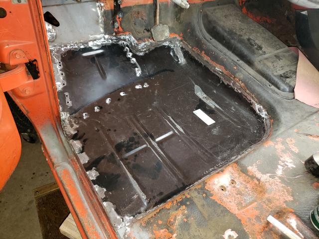

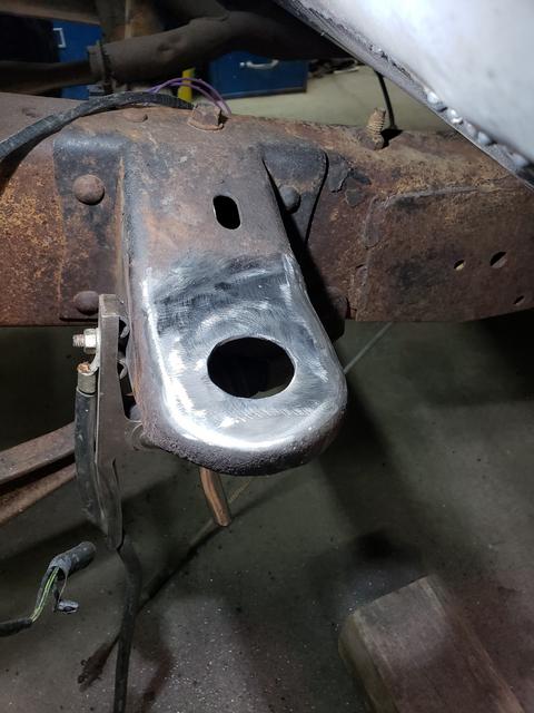

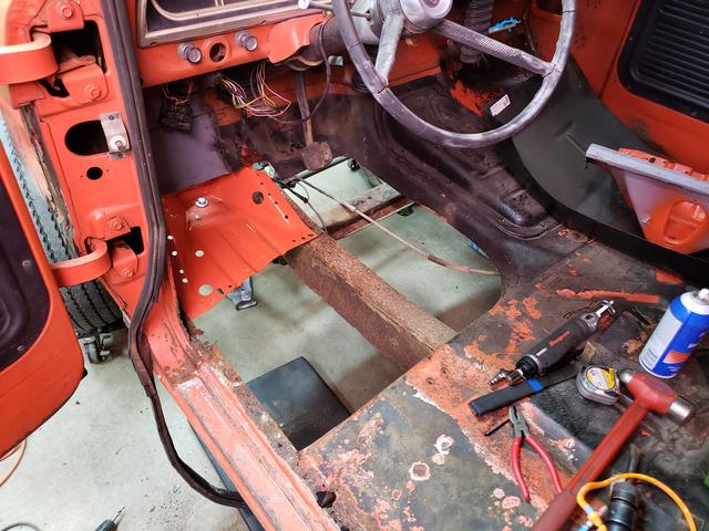

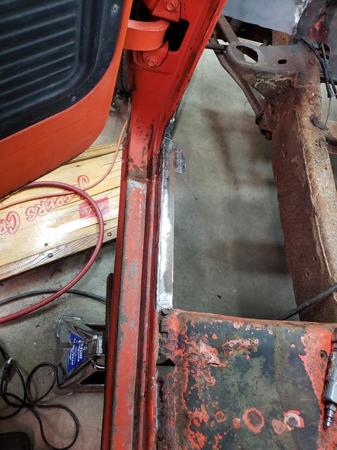

The driver side firewall section, floor pan, and cab mount are almost done. I cut the old floor pan out along with the rusty section of the inner rocker that the floor pan sits on, made a new inner rocker section and welded it in. The new floor pan didn't fit quite as nicely as I had hoped, but after some relief cuts and persuasion it didn't turn out too bad. I cut out the rotten cab mount frame bracket section and welded in a plate then cut a new hole. After pre fitting the cab mount a few times I ground down the welds on the outside of the floor pan, primed, seam sealed and painted. Tonight I finished grinding the rest of the welds, but I have a couple spots that I want to do some touch up welding on, then I'll start on the other side.

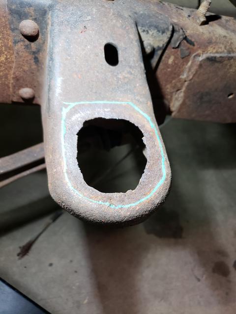

Nice work man! The rust in the floor was way bad. The pic of the rotted cab perch surprised me too. That truck spent it's winters on some seriously salty roads!
