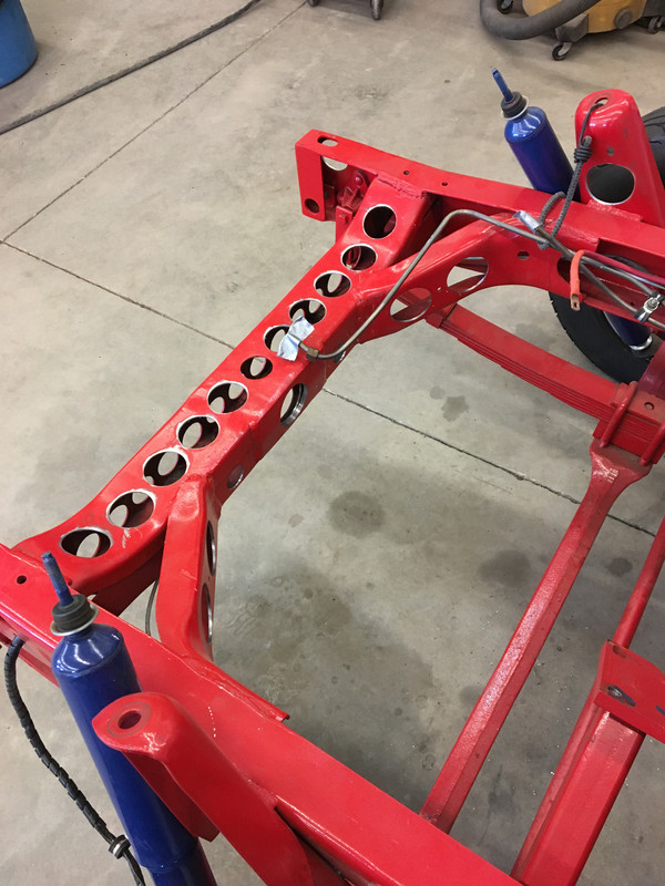

We tried several things to make the truck faster. When the motor and tranny was out for freshening, I swiss cheesed the front and mid cross members. This was good for about 25lbs. That steel is thick!

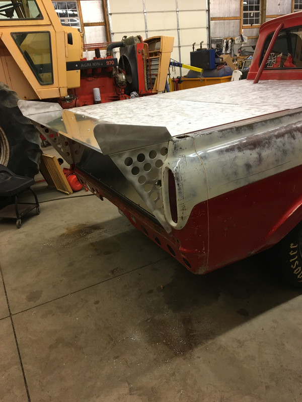

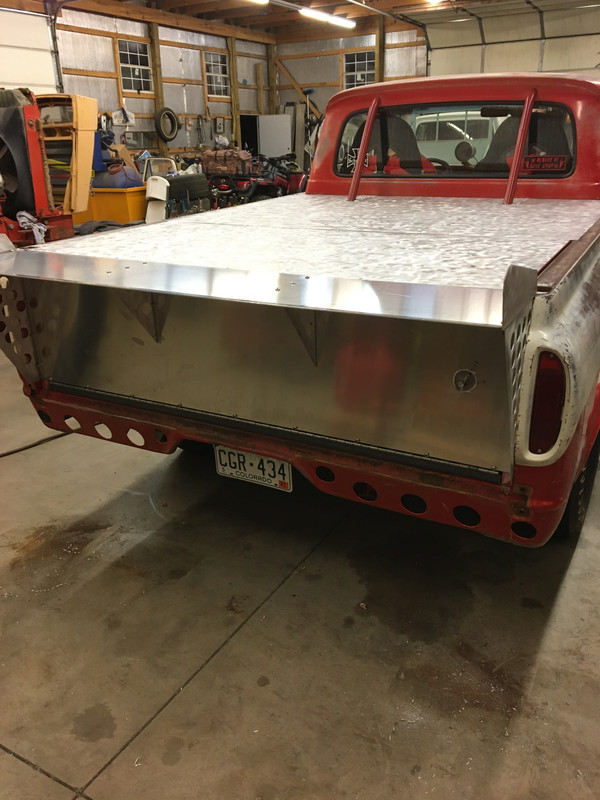

The last thing we tried at the end of the season was calming the air down over the bed. It didn't seem to matter much. Getting rid of the factory tail gate netted us about 30lbs though. The panel over the fuel cell pops out like the leaf on mom's table. The wing lays down with the new tailgate. We put little latches under the wing.

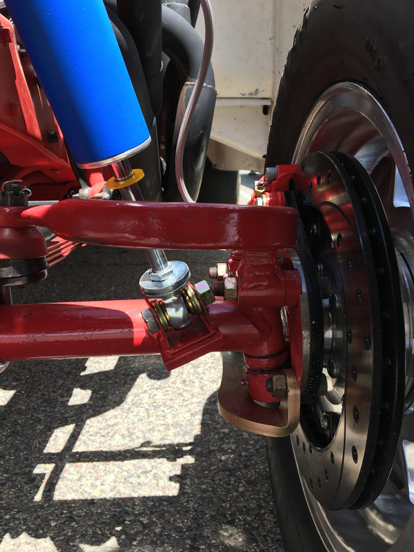

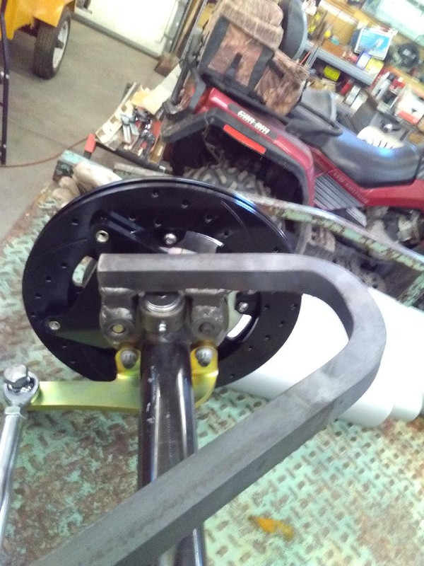

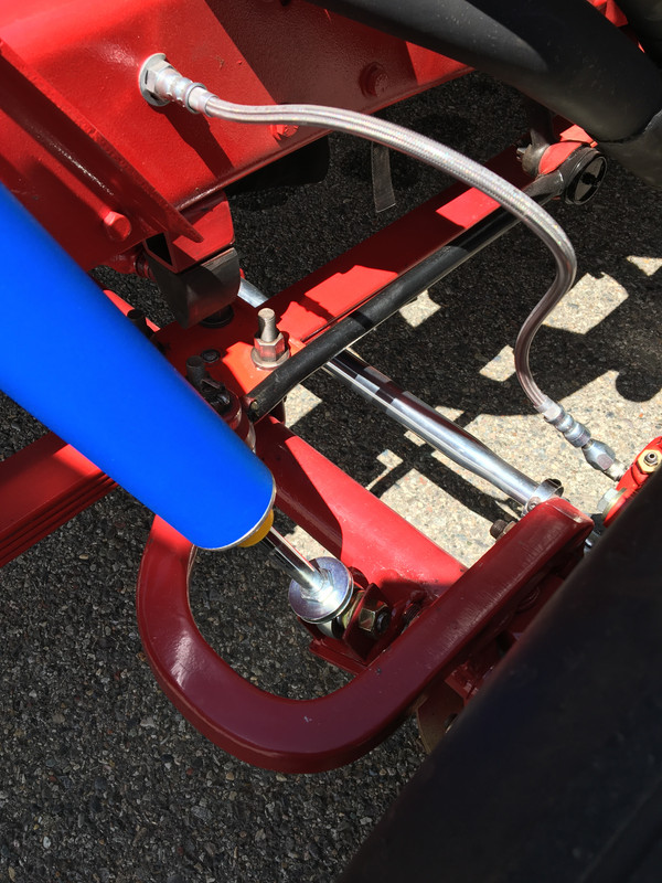

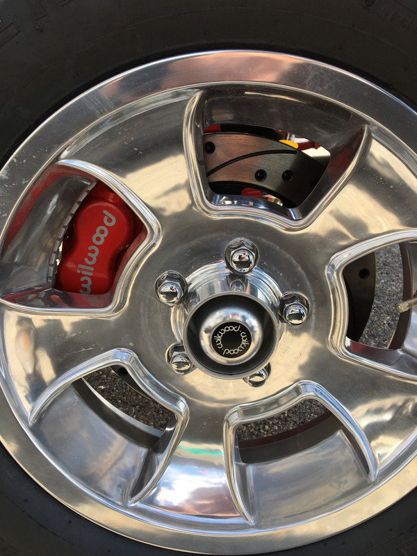

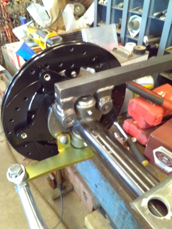

The front axle was a long process but we finally got it done. I had Speedway make up a tube axle with king pin bosses for 1940 Ford spindles. The standard tube they offer is 2" DOM 1/4 wall. The heavy duty tube has a 3/8 wall. Given the weight of the truck and the possibility of huge wheelies, we went with the 3/8 wall tube. We decided on the spindles because Wilwood makes a slick 12" rotor with aluminum hub that fits the early Ford spindle. The old steering arm had a wider bolt pattern and a curve that wouldn't work with the shock. Dad took the lead on this one and fabbed up a new steering arm that clears the shock. We ended up with quite a bit of spring droop after overhauling the factory spring packs. About 7". After quite a bit of searching around for a long travel 90/10 shock, I ended up getting custom shocks made. They're actually designed for IMCA modifieds. Minimal rebound valving with stout compression valving makes them like a 90/10. At the first test and tune we had some bad death wobble. The aluminum tie rod was fluttering like a guitar string up to about 90mph and then it would calm down. We had hopes of not needing a steering stabilizer but it had to go back on. Too spooky to drive. It takes some brain reprogramming to keep your foot on the floor when you can't steer.  :o All told we lost 60lbs off the nose. Unsprung weight to boot. 60' times improved to 1.43-1.44. I'm headed toward sneaking up my launch RPM. It's set at 2800 right now.

Doug- The brakes do slightly drag. I wasn't a 100% happy with the way the calipers mounted up. They're 4 piston calipers so they have to be mounted dead nuts centered with the rotor. The shim washer kit that Wilwood sent didn't have the exact thickness of washer we needed. McMaster-Carr would probably have the shim washers I need. Will revisit this winter.

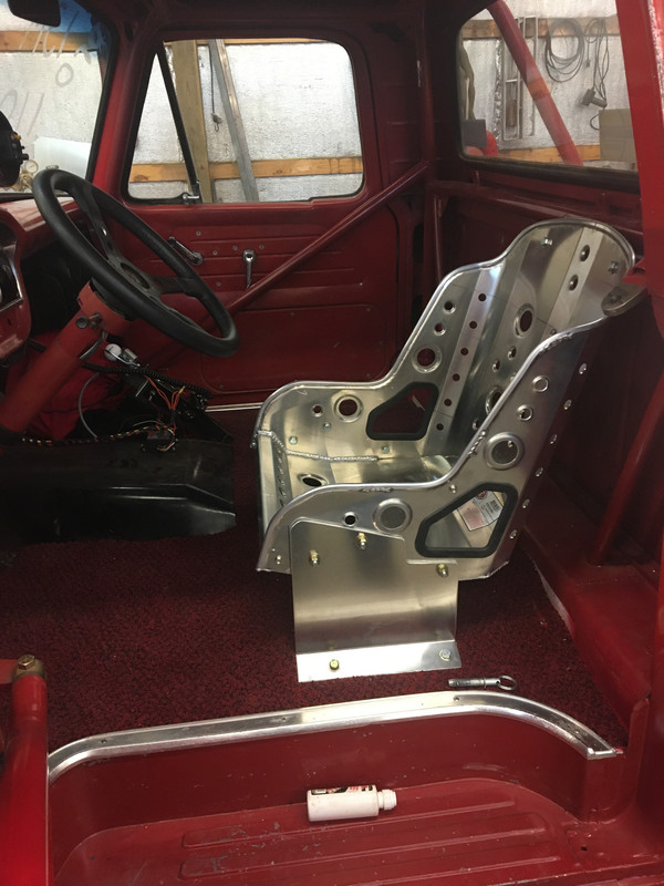

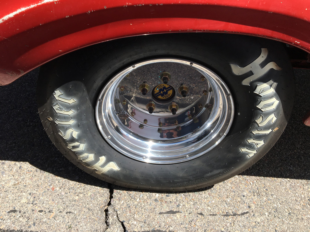

We spent another winter shedding weight of the truck. The first thing we did was haul out the seats and slider frame. I found a bomber looking seat that fit pretty well. Made a pair of custom brackets and called it good. This was good for about 95lbs.

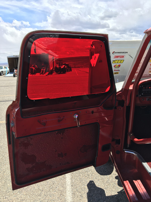

The next thing we did was trim all the fat off the doors and replaced the windows with red plexiglass. This netted us about 27lbs per door.
We hauled out the back window and made a plexiglass replacement for it too. It looks cool and all but it's sucks to drive in the dark.
Last thing we did was replace the steel back wheels with some aluminum ones. I took a shine to the wheels that mbrunson427 had made for his Mustang so I called Bogart and had a pair made. It took 4 months to get em but damn are they nice! Dropped about 17lbs per wheel.

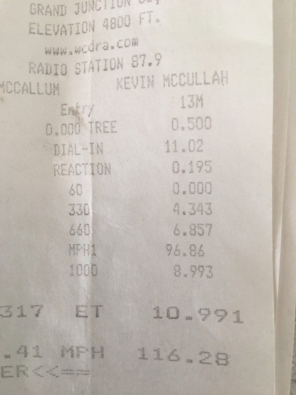

And after all that, we FINALLY got our ten second time slip. Just barely.
Note how the 60' foot time is missing? This is because the truck wheelies waaaay past the 60' beams now. Especially after a light spray of VHT. The few time slips I've got with a 60' time show in the 1.41 range. So this is where we're at now. We're working on limiting straps (expired harnesses) to shorten the front axle drop. Will post a few pics when we get it figured out.
