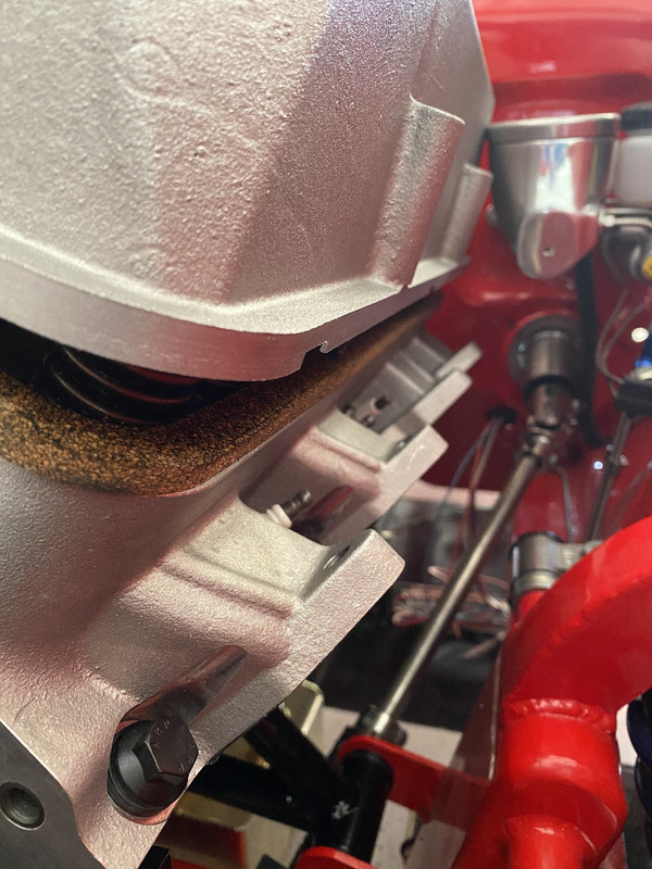

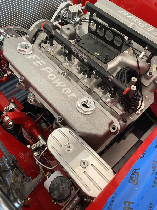

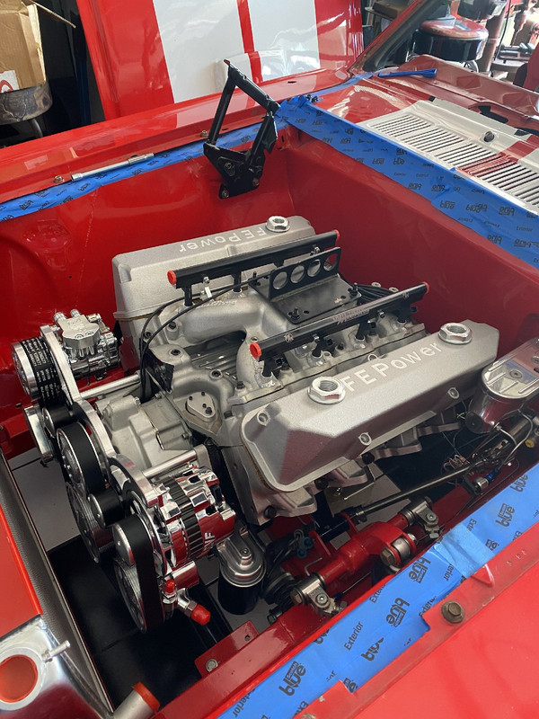

« Reply #216 on: March 06, 2020, 01:23:05 PM »
Ok Jay here are the pics and a tape. It seems to me that even if you break through there is plenty of rocker room and I can patch and sandblast the weld to make it right. Whutcha think?
These are for my Fairlane, I’ll pm you about a new set. It’s obvious to me that the engine needs these.
Hey guys what do you think about the finish? I’m kinda diggin’ the nonpolished look. It goes with the rest of the engine.
« Reply #217 on: March 07, 2020, 09:32:55 AM »
Hey Marc, yes I think you need those covers.  IMO looking at the photo sandblast or polished finish would be ok; you have several polished components that would tie-in.  Personally I'd go for polished as they might be easier to keep clean.  Bruce
« Reply #218 on: March 07, 2020, 11:07:36 AM »
Thanks Bruce you may be right. Either way it needs real vc’s.
Jay is sending me a notched VC he has as a working piece to check clearance. Then we can know if it has to break through to clear. If it does I ain’t skeerd.
« Reply #219 on: March 07, 2020, 01:10:49 PM »
I would.....shave off in a beveled cut a bunch off the master's top cover. The top doesn't need to be particularly strong either as one only need to look at the formed sheet steel OEM Ford cover to realize it's their to merely prevent the fluid form slopping over the sides.
I'd even venture a thin sheetmetal spacer, shaped like a "C" and slipped between the firewall and master cylinder housing, to angle it over a tad towards the fender side. Can't believe some small angularity would hurt braking.

Been a long time coming, Marc. It's nice to see you reaching the assembly phases.
I actually like the Ebay covers on there. They kinda fit the 'modern tech' theme of the engine bay. JMO
Either way, your car is gonna be the baddest car around, no matter where you live.  8)
« Reply #221 on: March 07, 2020, 03:35:02 PM »
Thanks Doug. It may end up being what looks best with the coils. My heart lies with the pentroof design though.
