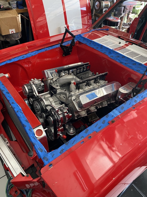

« Reply #207 on: February 29, 2020, 03:56:32 PM »
This is a pretty big day.
First time this car has felt a real engine in years. It’s nice to know all my measurements have worked out so far. It’s tight in there between a few things but it works. Steering rack is a bit tight because when I measured the mounts I didn’t include the pan screen. However I may switch racks (or not) we’ll see.
There is no way for me to get the motor and trans in by myself without beating the crap out of paint so I’m going engine, clutch, trans. Luckily the engine is perfectly balanced on the mounts so no jack required to keep it level. This way will also allow me to measure over and over for throw out setup.
Now all I have to do is everything else. Here’s pics.

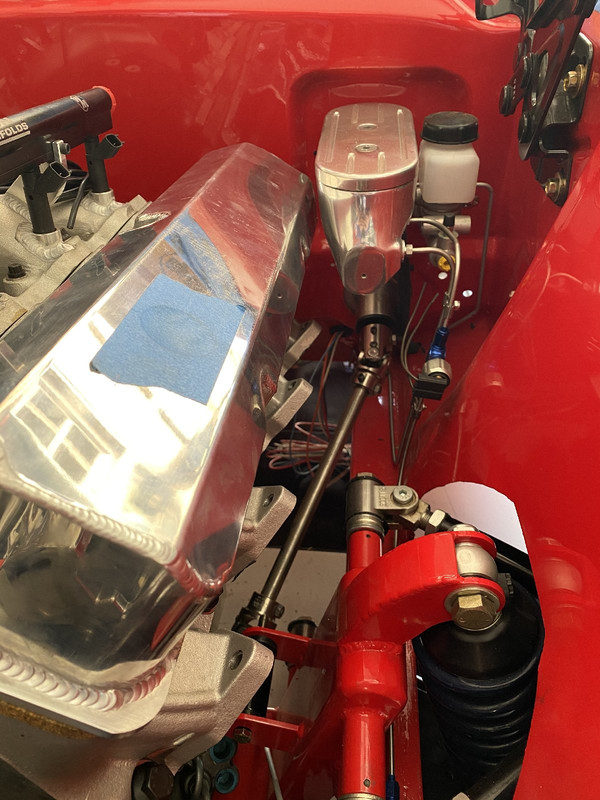

« Reply #208 on: February 29, 2020, 04:03:35 PM »
Oh, about those valve covers. I bought them as working set off of eBay in order to not screw up my nice ones.
Turning out they are the only thing that’s working with my setup.
Not worried though as I’m going to build the coil rack into the top of them so you’re not really going to see them in this form.
Obviously pentroofs are out.
« Reply #209 on: February 29, 2020, 09:32:45 PM »
I'll bet if I trimmed your pentroofs for master cylinder clearance they would fit...
