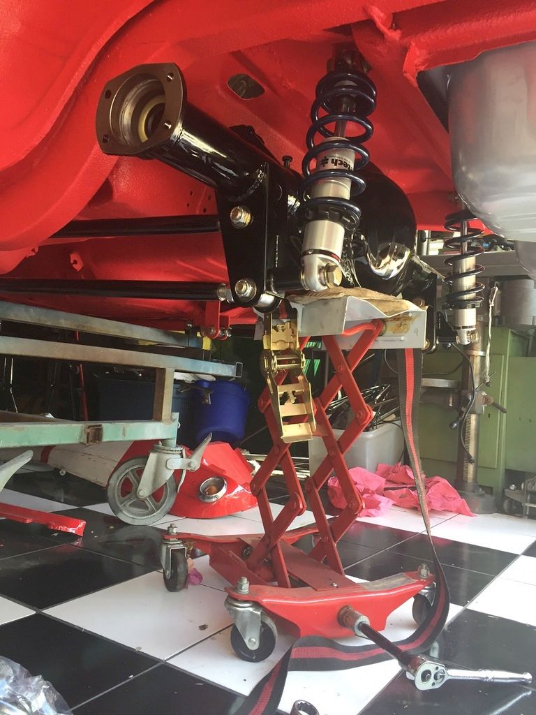

Got to have the morning to install the rear end.
I included the picture of the tranny jack because it's without a doubt the best tool I ever bought at Harbor Freight.
We all know you only buy certain things there, this should be one of them if you have to work off the ground as I do. It lifts as you see and pancakes out pretty low. Great tool.

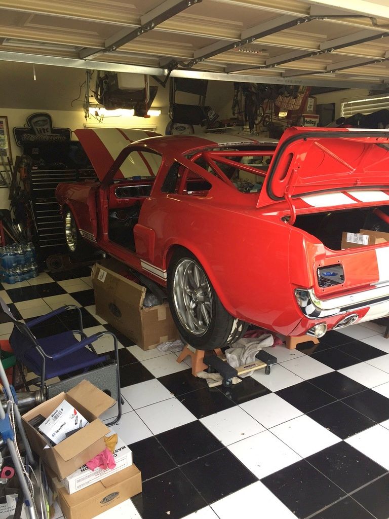

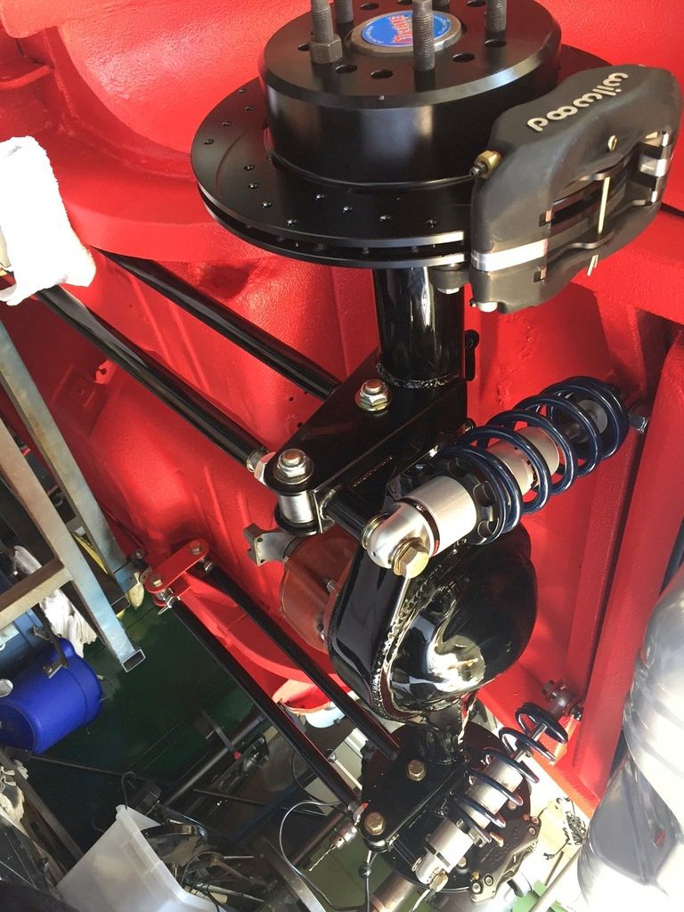

« Reply #109 on: May 05, 2017, 09:52:06 PM »
Well she's a roller again.
Hung the front suspension today. Man the little details and lubrication and cleaning paint and powder coat out of all the threads takes a ton of time but it's all very enjoyable.
Tried to set the alignment up fairly neutral to start with. We'll see how that goes with some weight. Easy to adjust though. I'm using washers now then I'll cut spacers when I dial it in.

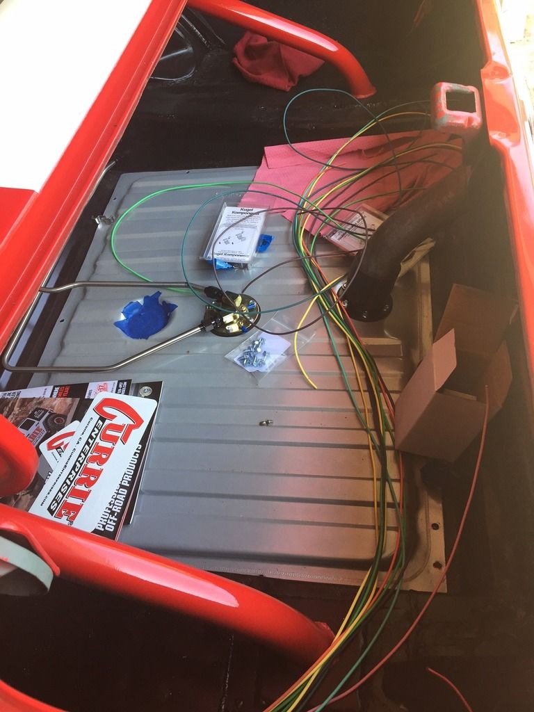

In wiring hell this week. Maybe hell is a bit strong but it does take a while to do it right.
As I've said before I'm putting the battery in the trunk so have been figuring out how to get that done without stupid amounts of wire all over the car and long runs of hot wire.
This may sound elementary to a lot of you but even though I've wired cars before I've never wired one with the battery in the trunk. I of course looked at the way guys do it on line but frankly there is some not so good stuff out there as well as some good ideas. Basically I'm putting the solenoid and circuit breaker back there and running one hot 8g wire to a terminal under the dash. That way there is only one full time hot wire heading up front and that wire will be shielded the entire length. The starter cable will run under the car along the frame rails (I can say that now even though it's a Mustang. :)
All the accessories will get their juice from either the under dash terminal if they need to be hot all the time (such as stereo clock) or off of an accessory panel fed by the ignition switch.

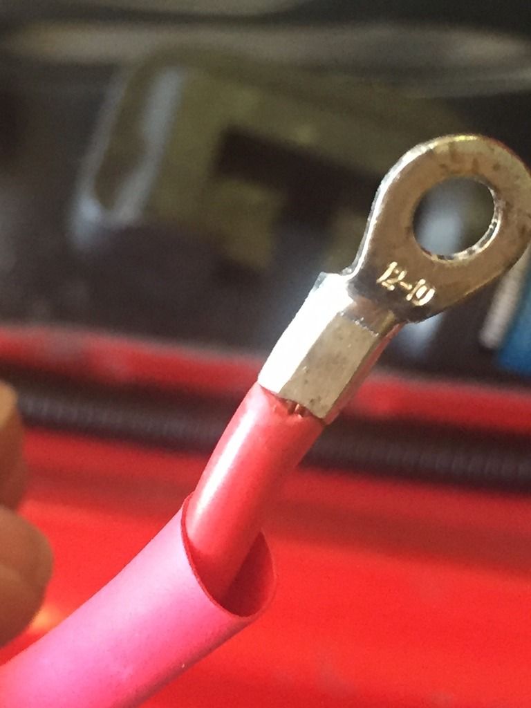

Speaking of taking time, I don't know if you guys are this anal but to make the connector butts I take the plastic off the connectors then crimp them with a hydraulic crimper that smashes it all together
pretty darn good. It seems like no matter how hard I tried and checked with regular crimpers I'd always have one or two that came apart.
