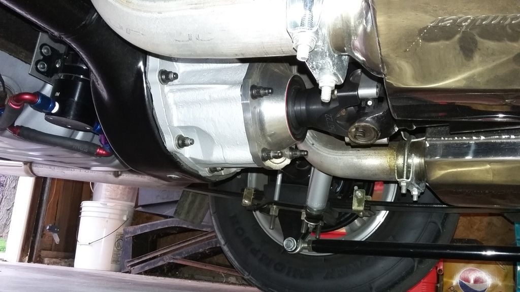

Looks like it was real close to being sheared in two. Good thing you found it when you did. Did you upgrade the slip yoke? I just recently went to a Mark Williams driveshaft and yoke. It wasn't cheap but at least now I know I'll bust the tranny before the driveshaft ::)
Re: Aftermath
« Reply #17 on: July 23, 2016, 09:44:52 PM »
Here is the replacement I bought, Doug. http://www.jegs.com/i/JEGS-Performance-Products/555/60677/10002/-1
A little pricey, but I have zero complaints with it. Very nice piece. Made by Sonnax, in USA. :)
Later, when the new motor goes together and I upgrade the trans, I will build a new driveshaft with 1350 joints. Currently running Ford Racing M-4635-A u joints front and rear.

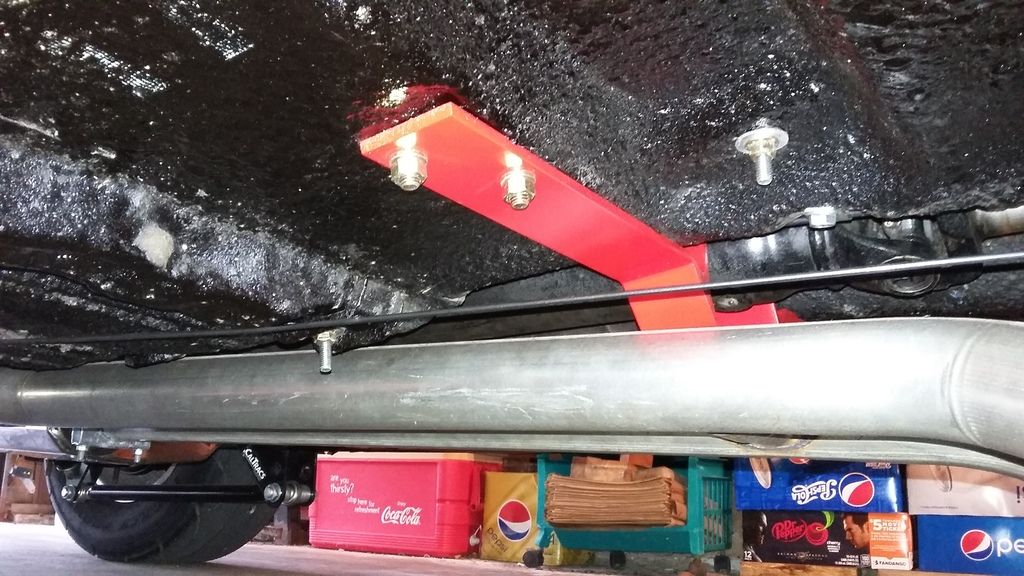

Here are a couple pics of the safety loop I made for the car. (Pre-billet yoke install)
The color I chose was a Rustoleum industrial "Safety Red", I thought it was only fitting. :)

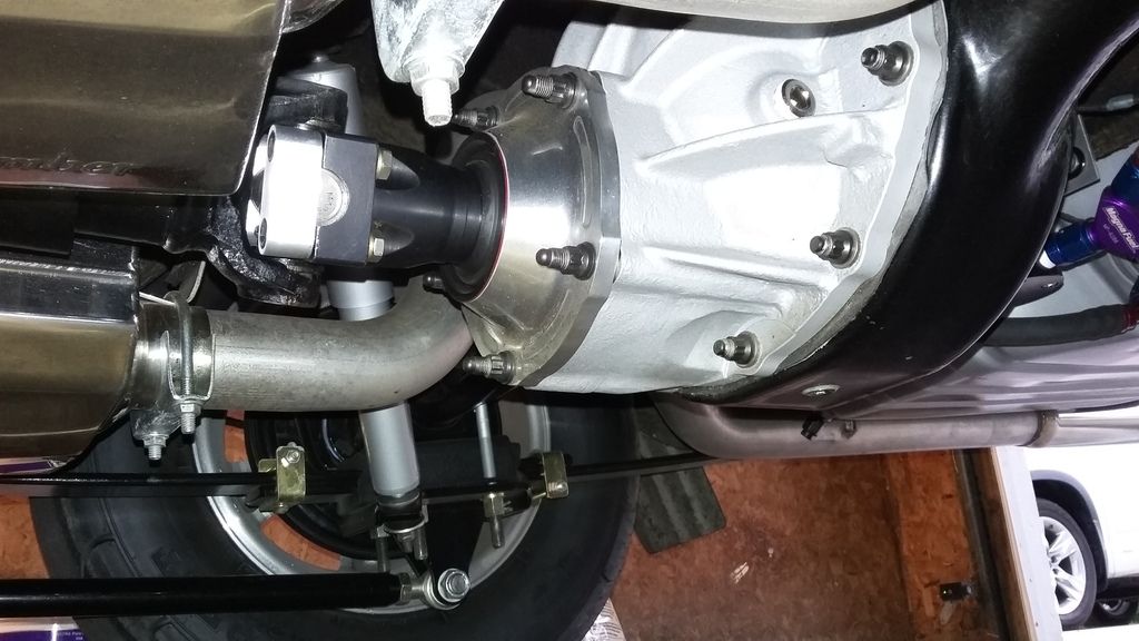

I was going to mention though, your driveshaft doesn't look like it's long enough. I've never seen one that far out, and that most likely didn't help matters with your old yoke twisting. It should be in as far as possible without causing any bottoming at maximum rear deflection. Yours looks like it's only about half way in. Hopefully the billet yoke will stop the twisting, but it still contributes to a 'whipping' action which is really hard on the yoke and U-joints as well as the output shaft. Is that a stock length driveshaft for the car?
« Last Edit: July 25, 2016, 09:07:43 PM by cjshaker »
Re: Aftermath
« Reply #23 on: July 25, 2016, 09:34:18 PM »
Pentroof- I fully understand your point, but I don't think the adjusters are terrible. They are not perfect and are halfway in travel. My Erson's going on my next build will be closer. Yes, geometry was checked. I feel the failure was due to a thin section of the rocker body.
Doug- The driveshaft is original to the car. Never been shortened or lengthened. Only thing done to it was occaisional u joints and having it balanced. The yoke sticks out only about 1 1/2", so maybe the picture is deceiving. The old yoke was over 8" from center of u joint to end of yoke, so it was well over halfway in. Also, the output shaft sticks out past the tailhousing about 1/2". I don't understand how this would have caused it to twist. If anything, it should have very noticeable wear on the output shaft bushing, and it looked good. The old yoke stopped about 3/4" short of the full spline on the output shaft. The new yoke goes just to the edge of the spline ends. Hopefully it will last till next year when it all comes apart for long overdue upgrades. :)
I have to agree with Doug on the position of the slip yoke, I had the same thought when I looked at the picture. I don't know if it contributed to your spline failure or not, or if there a preferred engineering theory, but I would think more spline engagement would be better. I do know the Mark Williams driveshaft I got for my car a few years ago sits further into the transmission extension housing and Mark Williams picked the length, it wasn't supplied by me. I was actually a little concerned that mine sat too far into the extension housing, but I moved the rear suspension through it's travel and it was fine. My car is a Mustang though. I don't doubt you on your driveshaft being original but a question I would ask - is your rear end yoke original too? Ford had multiple rear yoke lengths, as does the aftermarket. If your rear yoke was shorter it would move the driveshaft back. Just some thoughts, it sounds like you did check engagement.

Kevin- On the more spline engagement being better, trust me, I feel the EXACT same way. That's why I just bought the yoke I did that has full spline.
As far as the rear end and yoke, I'm well aware on lengths and cap widths and u joint differences, both OEM and aftermarket. I have a few different OEM yokes laying around. Long, short, wide, and narrow.
Here's the setup. I built it myself. Only thing original at this point is the housing.(w/perch reinforcements of course)
I originally ordered a new yoke from Currie that matched the old yoke in length, but was machined for the Daytona support. Also, it was a nodular iron piece. I tried it, but the driveshaft wanted to almost bottom with it. So, I went to Quick Performance where most of my parts came from and ordered this shorter billet steel one. Would highly recommend Quick Performance to anyone. Driveshaft ended up in same location as before I rebuilt the rear. Also, my dad's 67 Lane that is parked next to my car looks the same way. Also has factory driveshaft, trans, yoke. That car has seen 7k w/slicks. I'm not too worried with my wheezy setup. I WILL try to get the driveshaft closer with the next trans and driveshaft.
