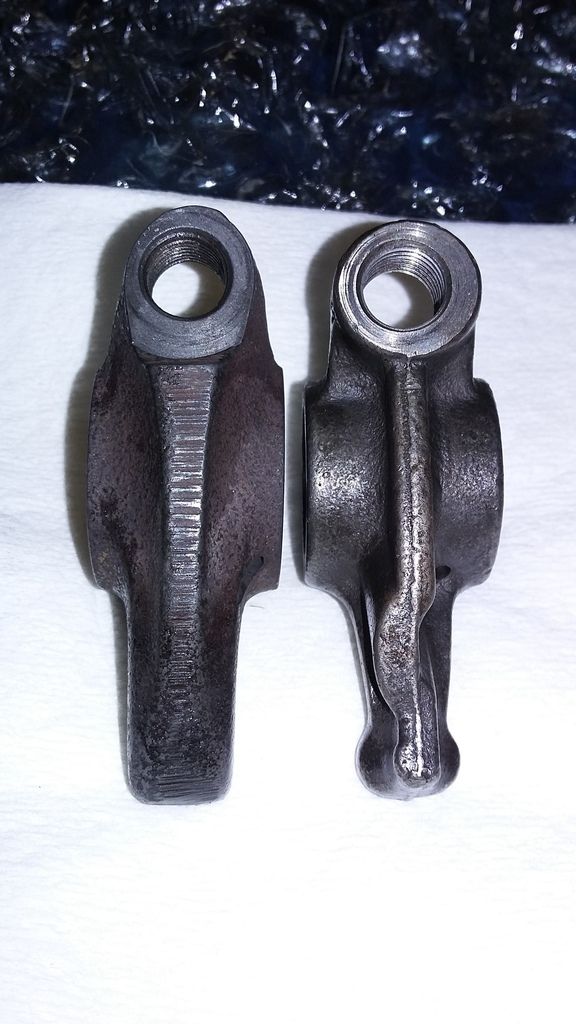

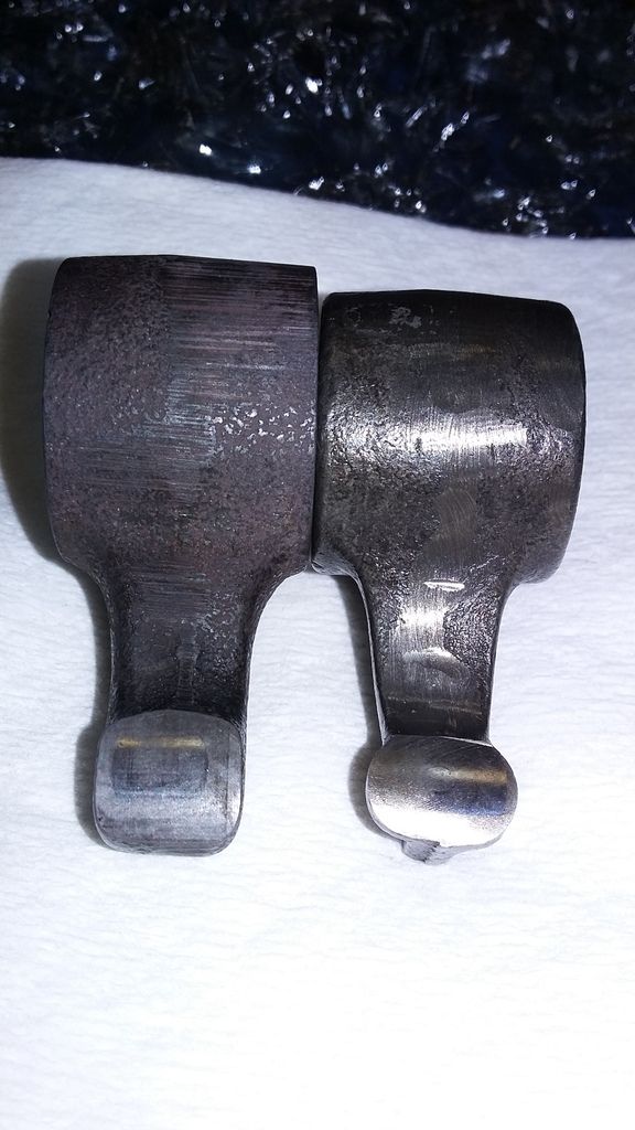

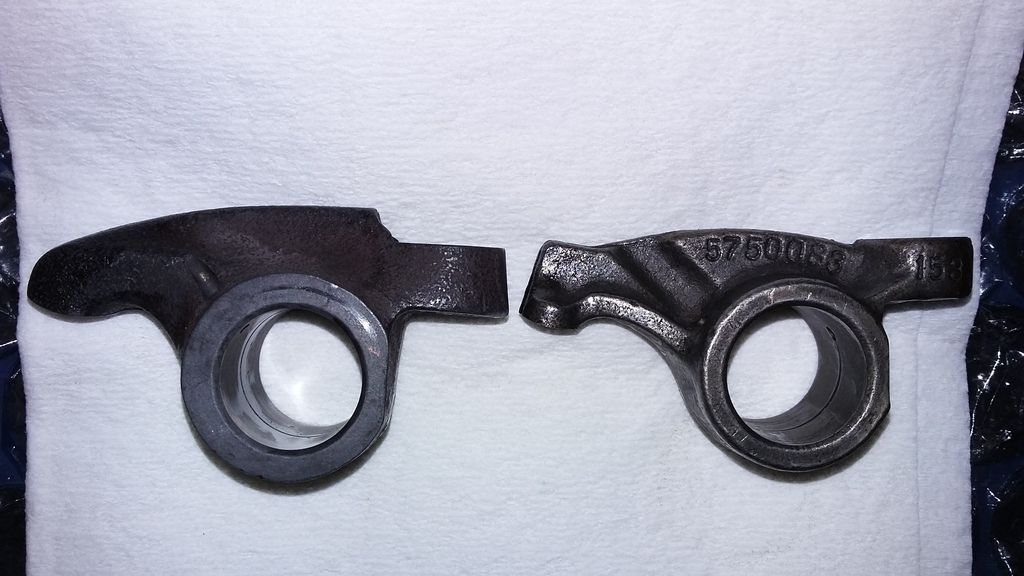

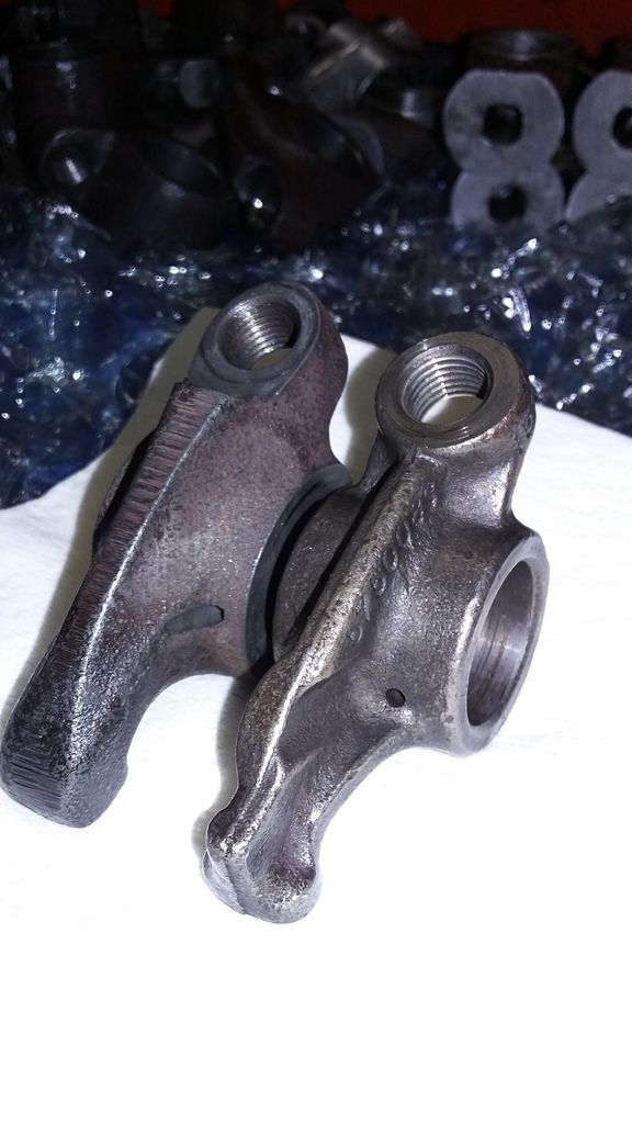

Got my new rocker setup together and installed. I decided to go with the Crane ductile iron rockers for now. I couldn't see putting my new Erson's on for a year and on this mild combo.
Here are some pics of the (new to me)Crane vs stock Ford replacement rockers. Lotta material on the Cranes.

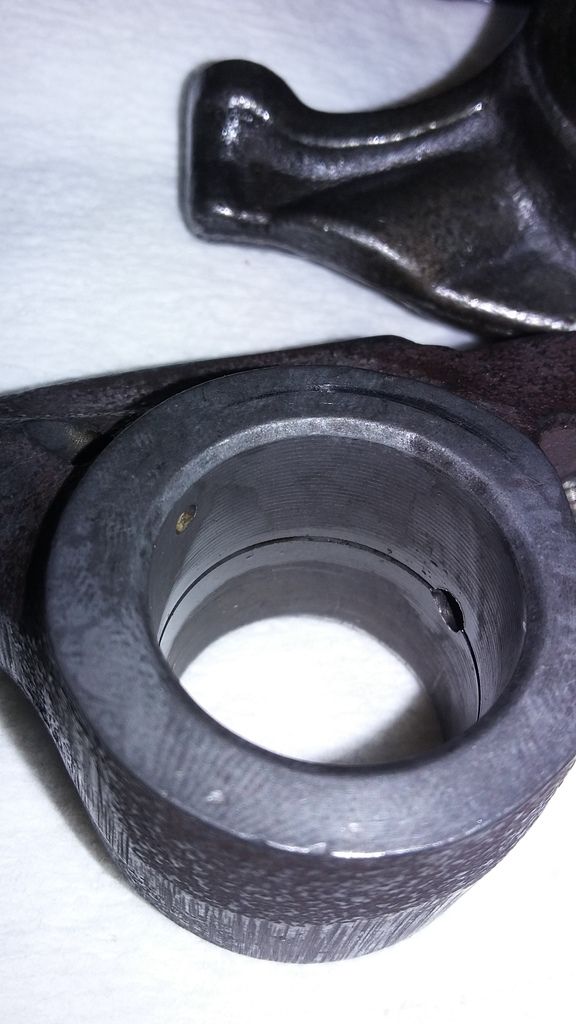

Crane has a 360° oil groove

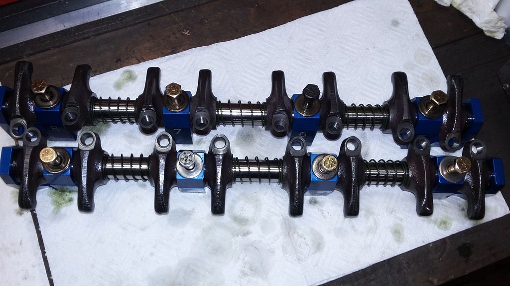

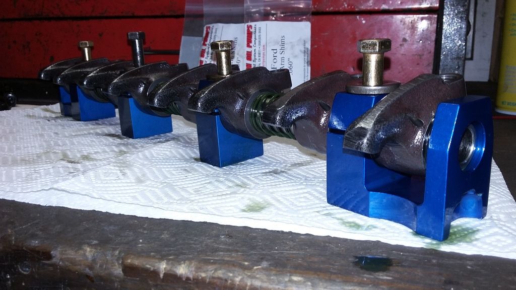

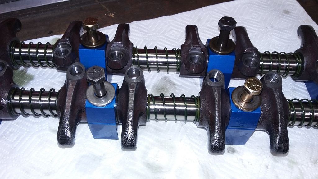

Assembled with POP stands, old Speed Pro shafts, and high tension green springs:
Thanks to POP for the excellent stands with end supports and a very generous supply of shims.

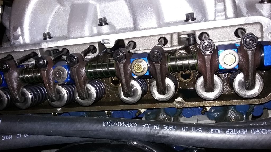

Installed:

Looks like a darn good set-up to me. I'd be pretty happy with that for about any street car.
