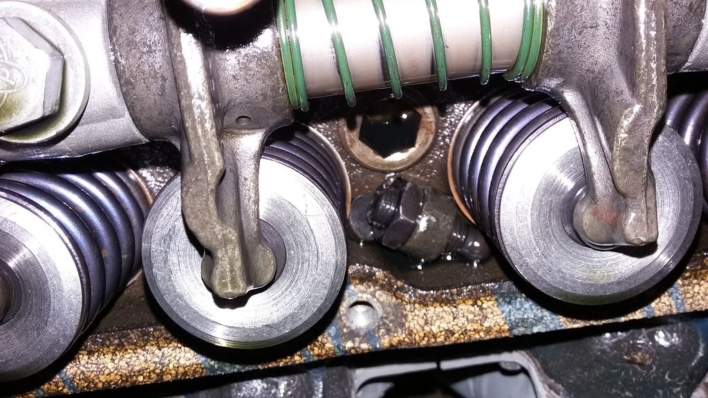

Snapped no.2 exh. rocker (These are and old set of Pioneers)
The piece of rocker with adjuster and lash cap were sitting snug as a bug between the valvsprings.

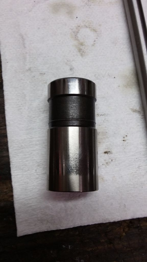

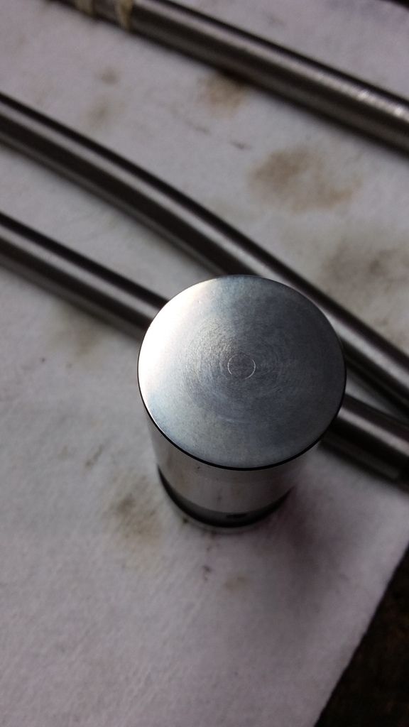

Hard to see, but the lifter had gotten tossed.

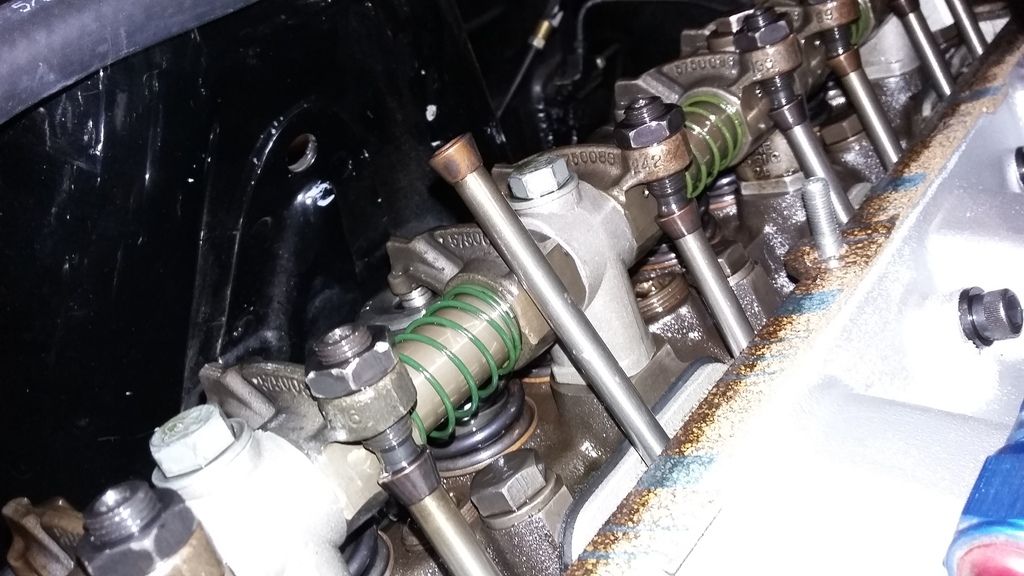

I tried to get a borescope down in to see, but not enough room with this intake ( Performer RPM) and a splash tray. Looks like I will be pullin the intake back off that I just installed a few weeks ago. >:( If the lifter is beaten up at all, it will be a good excuse to throw in some solids to pick up a little more rpm.

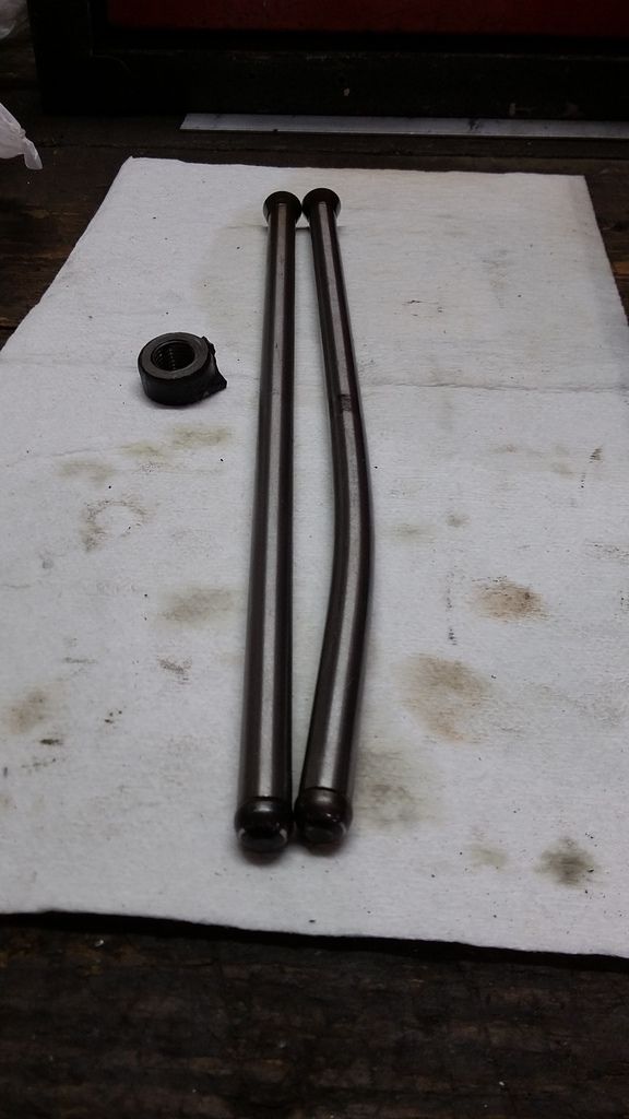

Those rockers look like they've been ground on? That worries me. Also check the #2 intake pushrod for straightness, often if the exhaust valve can't open to release the pressure the intake pushrod will bend trying to open against the built up exhaust. Congrats on making it to Meltdown though, I enjoyed watching some of the live streaming the last couple days.

Kevin- Yes, the rockers were ground for extra pushrod clearance. I can't take credit for that, that is one of the things that I haven't changed since the motor was put together 25 yrs ago. I WILL be putting some FOMOCO factory adjustables back on. I will also check the other pushrod.

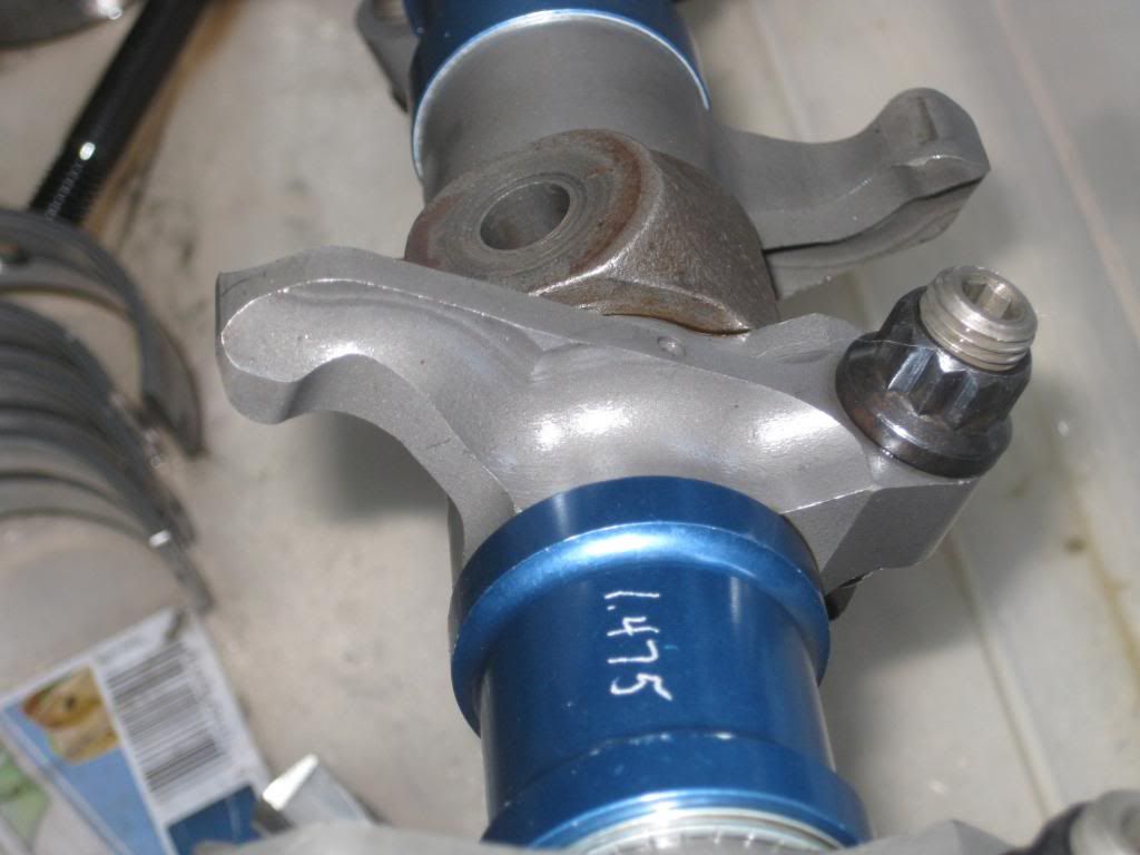

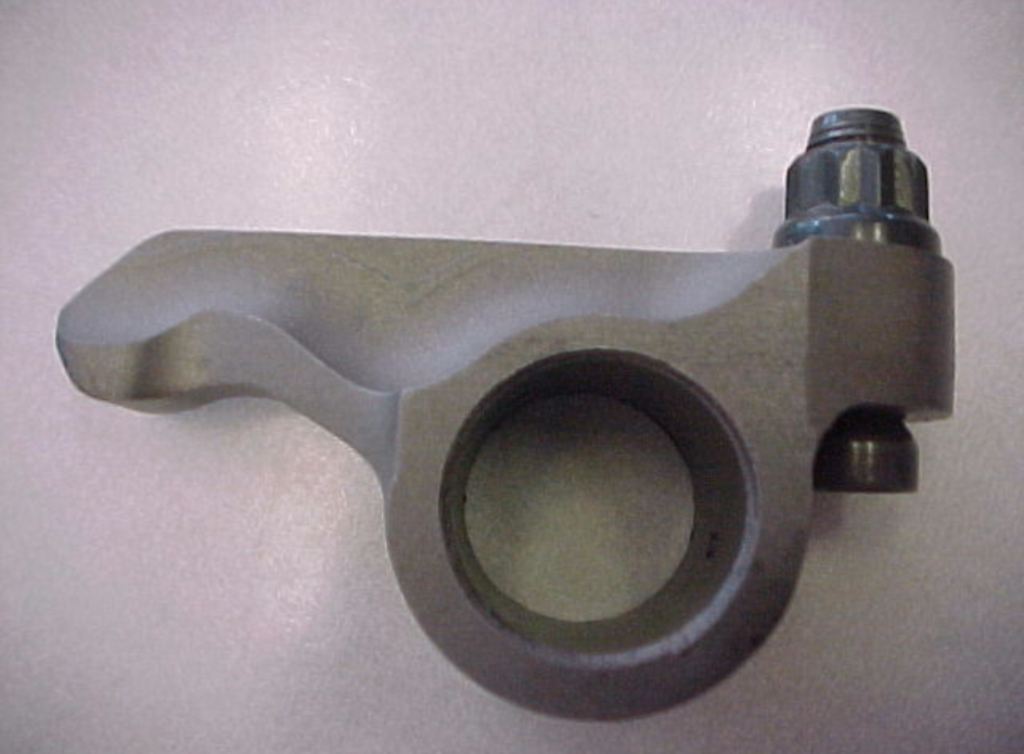

Are the billet steel Graham rockers still available any where ? Always thought they looked like a nice piece.

Firstly.. congrats on a having a good time racing and driving there and back (okay, part way). The damage certainly could have been a lot worse however, much like you I'm disappointed that you had a rocker failure after only 25 years of abuse. :)
What is interesting to note for everyone is how small the cross section area is where the break occurred. Really not a lot of strength there for any kind of performance valve spring. I've never seen those "billet" rockers before but they look stout and also wonder what the availability is. At any rate, I'd suggest it's time for something more robust than even the stock Ford adjustable. No point in tempting fate one more time. Car looked good in the video btw...

When I saw that first shot I thought "Holy Cow, the first factory rocker I've ever seen break", then I saw that it wasn't a factory rocker. I'm really surprised you didn't see an oil pressure drop with a hydraulic cam and tossed lifter. Hopefully it didn't damage the rest of lobes and lifters on that bank, or worse, starve the bottom end bearings and damage them.

Doug, I can remember right up until I shut the motor down, I still had roughly 20psi oil pressure at hot idle. Even after starting it very briefly to diagnose the problem. I don't think anything was starved. I will look at all the lifters when I pull them out.
Hey, that second photo looks familiar.  Yeah, those are good rockers that would be really tough to break.  Thor has been using the rockers in your second photo:
Like this?
#2 exh. left, #2 int. right
Lifter that popped out
Looks good enough, so back in she goes...
Luckily there are a few spare pushrods on the shelf, so a few bucks saved. :) Pushrods are old TRWs
