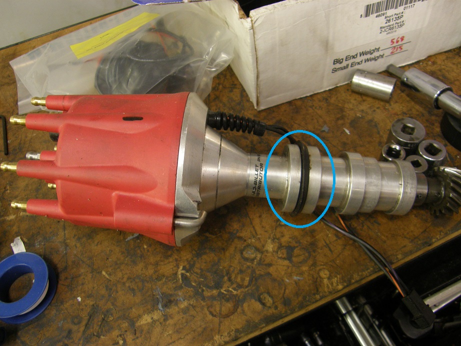

Jason, thanks for the picture.  Since there is oil on top of the intake I would say that is a leak around the distributor, not between the intake and the block.  There is a round rubber seal that goes around the distributor and is supposed to seal to the hole that goes through the intake; maybe that seal went bad or something.
The triangular shaped hole towards the lower left on the picture actually will go all the way down past the head and out the bottom, past the left side of the timing cover.  Is that the "well" you are talking about?  Any oil there should drain out the bottom by the front cover.  Are you seeing an oil leak at the bottom of the engine, at the front?
One way to solve that leak is to find a couple of O-rings that fit around the distributor in the seal position, and put them on the distributor first, then re-install the round rubber seal.  That will space the seal out so that it seals against the hole in the intake.

Jason, don't pull the intake until you check that distributor seal.  I think that must be where it's coming from, because in the picture there is oil on TOP of the intake, right by the distributor hold down clamp.  If it was the front seal between the intake and the block, the oil would just drip down under the engine.

Hi Jay.  No problem.  In looking at the instructions for the distributor, there is only 1 o ring toward the bottom of the shaft going toward the gear.  There does not seem to be any seal on the distributor at the top ( near the top of the block/ intake.  Its definately getting worse as I can see it now dripping fown the side of the block from the "well" onto the oil filter adapter and then down to the driveway.

« Reply #1777 on: October 22, 2016, 09:37:35 PM »
The rubber seal is not internal, it goes on the outside of the distributor housing.  See the photo below:

Pretty sure thats whats missing then.  Ill check and also see if I can order a replacement ( only see ones for Chevy msd's on Jegs)  thanks again

I doubt that it is missing, it is probably just scarred up or shrunken a little, and not sealing to the hole in the intake manifold.  If it is missing, my bad, because I installed the distributor.
I've got extras, I'll send you one - Jay
